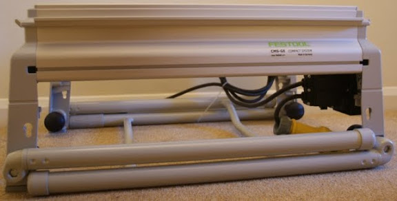

Anyway we want pic's so here is the base unit that lets possibilities and imagination run free.

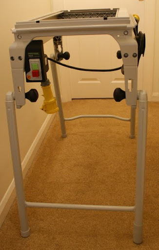

The base unit CMS_GE in its folded position.

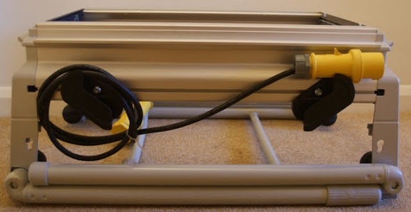

End view showing the NVR switch, this one is for the UK site requirements and has plugs/sockets for 110v power.
Cable storage, lazily illustrated.
With legs extended/unfolded it matches the height of the MFT/3. Bottom right of the picture shows the adjustable foot to counteract against uneven floors.

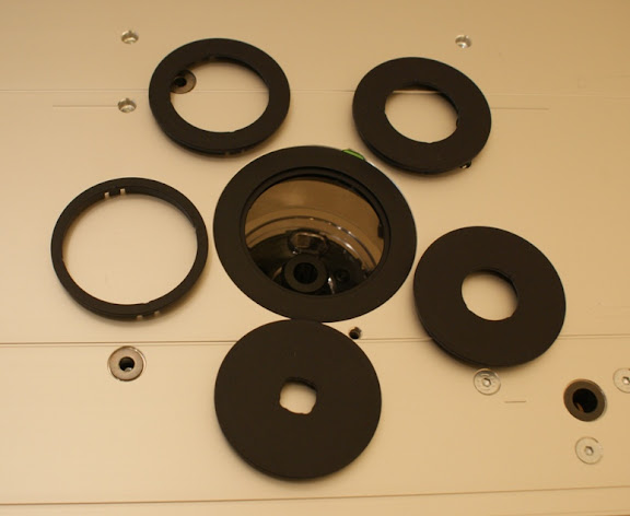

Supplied as standard, going clockwise from the left, we get the dark grey centring ring (473810) for the OF1010, the light grey centring ring (473809) for the OF1400
and the Festool green one for the OF2200.

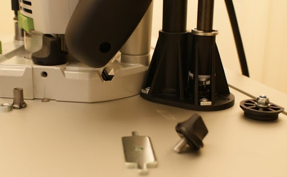

From here on we will deal with the OF2200, because that's the one I have.

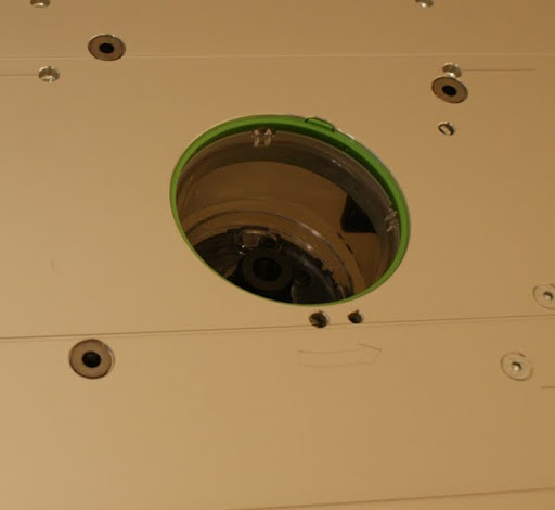

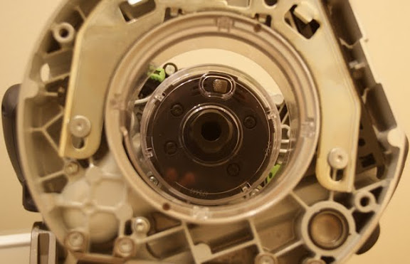

First, with the table upside down, insert the green centring ring in the table then remove the base plate that is on the router.
Now we need the Protective Cover, I believe this is designed to stop dust getting into the router through the bottom vents. There has been some mention of this as a problem in some threads. Like all the parts it has its part number moulded into it. (473449).
Insert this with the part number readable from this view, and the oval indent over the square 'bolt'.
Rotate clockwise to this point, there is a ratcheting sound and firm stop.

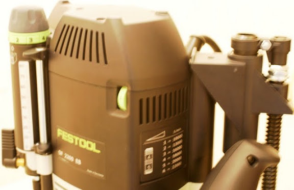

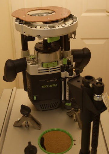

Plunge the router to it's lowest point. Place the router over the centring ring, there is no play in the fit, with the guide post opposite the fine height adjuster side under the cutting depth adjuster. Then install the 'Journal' as it is described. This prevents the router rotating around the centring ring. This Pic shows the position with the journal and small knob.
Journal in position, the 6mm tab into the table for this router.

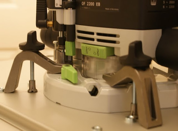

Tightened up.
Install and tighten the three clamps.

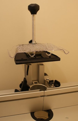

Release the router plunge lock, make sure the raise and fall mechanism is engaged.
The operating handle for the mechanism fits above and below the table for ease of use.
Flip the table over, ease the router and rise and fall mechanism into the opening, then connect the far edge( with the cup and round hinging edge) first. When installed give the slotted screws a half turn to lock into place. Looks neat.

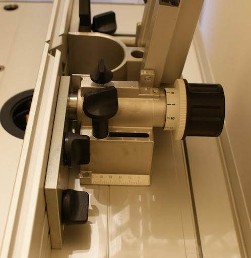

The router table fence, would not be lost on some high end shaper/spindle moulders!
This is a serious bit of kit, it may be ali' but it is weighty ali'.

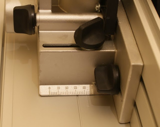

To aid with adjustment there are metric scales and the table is etched with reference lines either side (at the 41mm mark here).
Also included are the clear plastic 'Shaw Guard' and the dark plastic hold down, both easily adjustable, and lift back out of the way for cutter adjustment/ installation.
The infeed part of the fence has a large indexed knob to allow for a planing action type of cut.

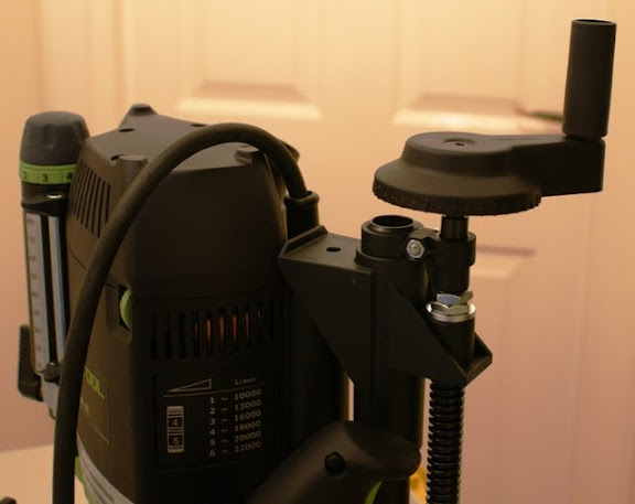

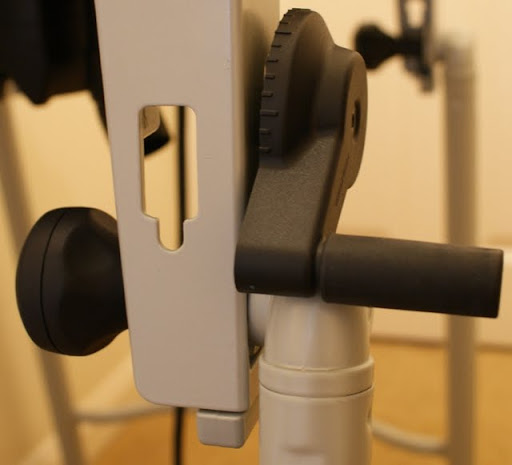

The rise and fall handle in the table face position. It takes 14 full turns to go from the lowest to highest setting. The action is smooth and easier than I imagined.
Also included is the guard for use with guided cutters with curved workpieces.
Oh! For those of you who are wondering where to put the handwheel for the rise and fall, any of the rounded or squared keyhole location points will do nicely, the handle stem has been machined to suit.
