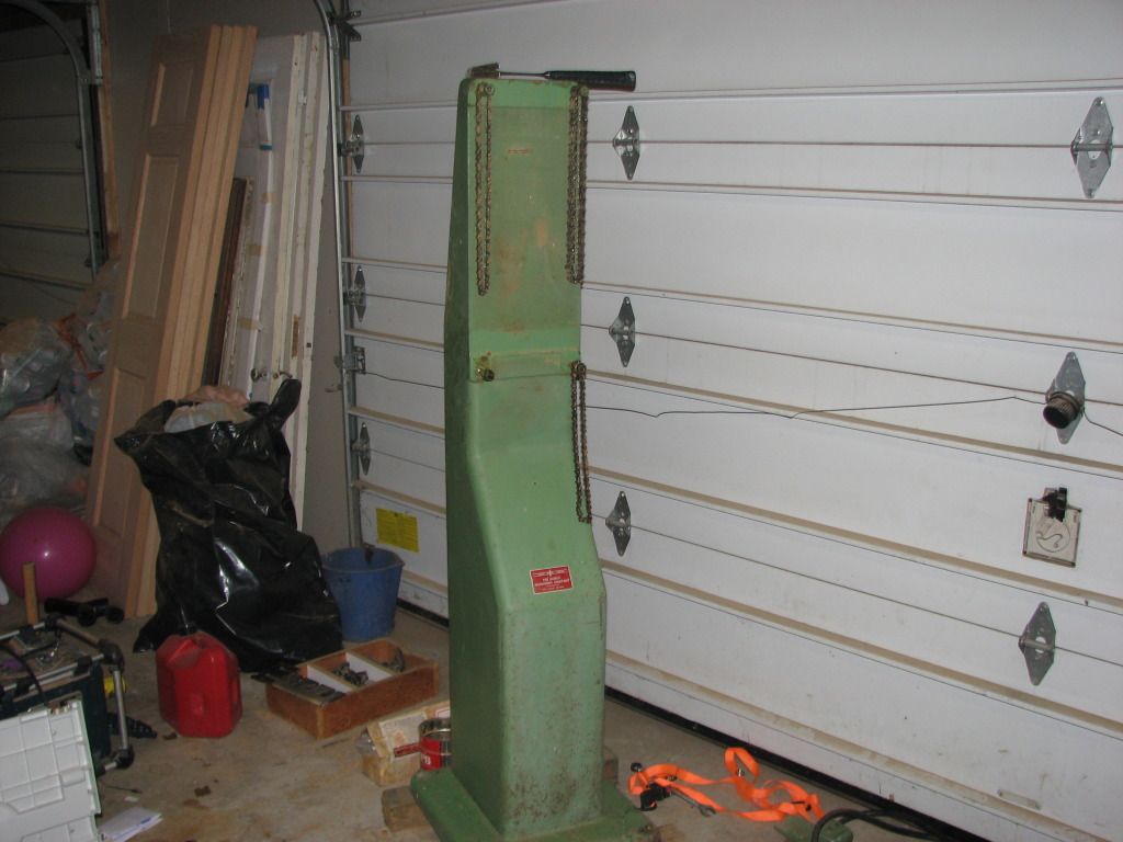

I just bought a Festo chain mortiser and a Festo power feeder at an auction today.
I don't have any pictures yet, since I got there at 9am this morning and did not get out of there until 9:45 pm.
Pictures to follow.
Wonder if Shane or Rick would be able to track down any literature on them for me? Big Grin
Good thing I let my 7 year old take my phone for a while today, she took a picture of it for me.

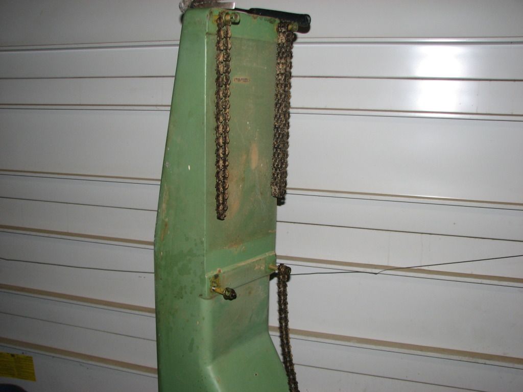

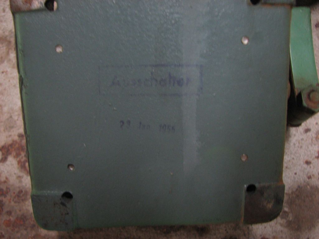

« Reply #2 on: June 06, 2012, 11:22 PM »

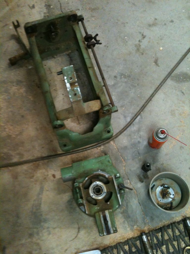

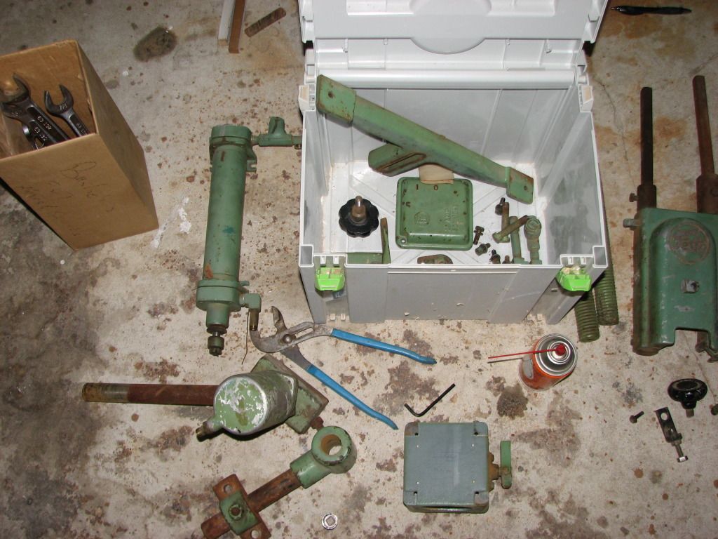

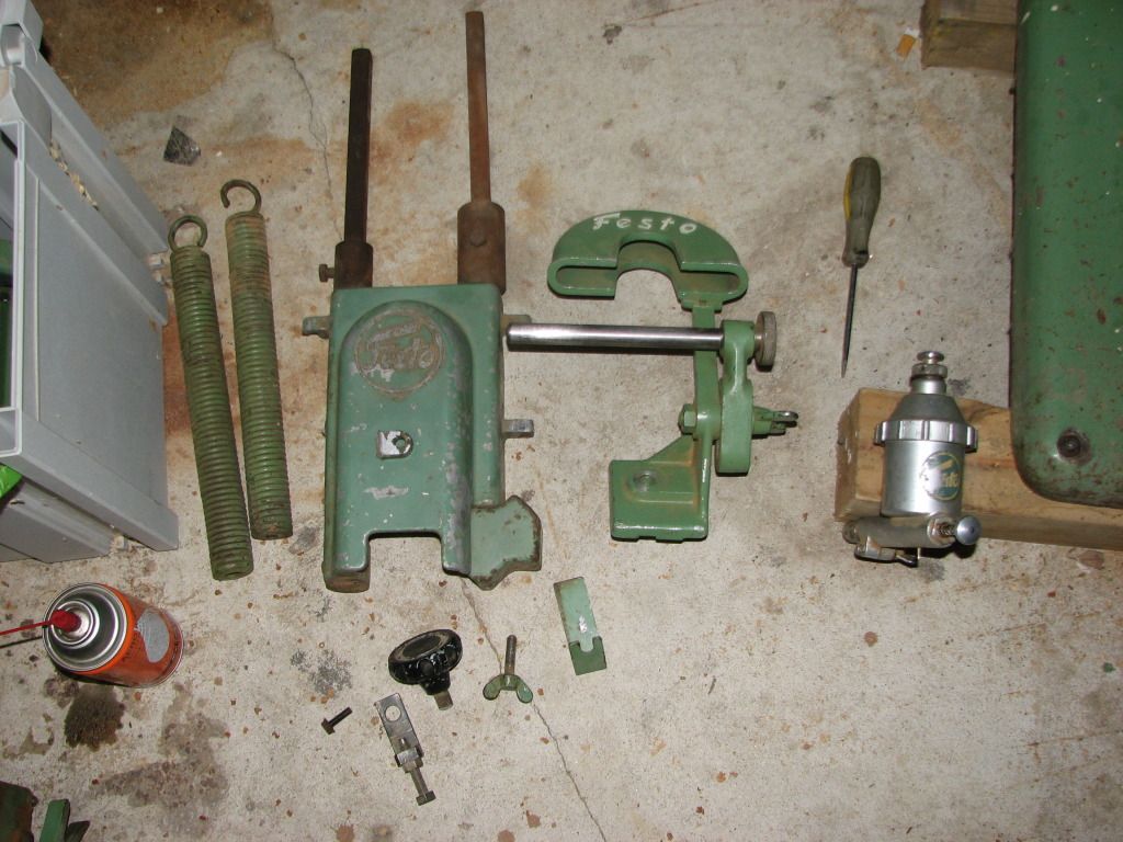

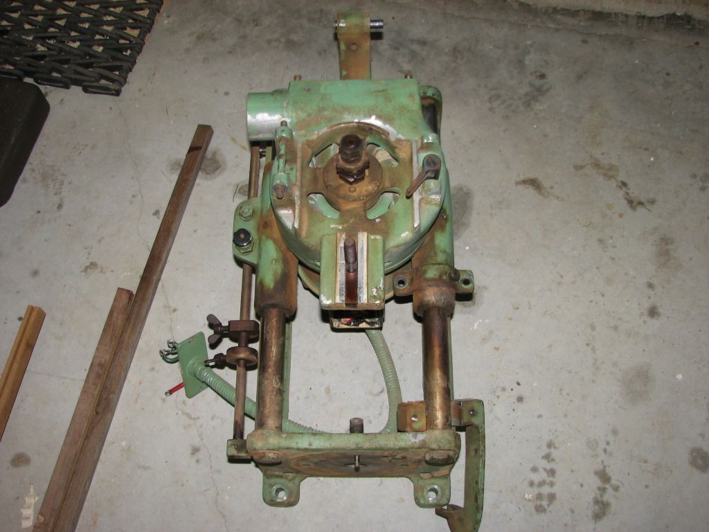

It is broke down in pieces, there are two parts I will have to take my welder to have repaired.  Everything except the main base is aluminum.
Main base/frame:
Close up of the chains (have a good lead on a box full of bars and chains)
Guards and grease gun (missing the proprietary tip for the zerks) not sure what the middle guard is for, extending the arbor and bar out for wider stock?
Misc. parts:
Looks like the serial number/badge had been removed, but I found a date on the back of the on/off drum switch box.  Says 23 January 1955.
Table/fence assembly.  It rotates 45 left and right and has 3 different stops for tilt, with one being 0.
The head section.  It is a 2.2hp.

Kev
Online Online
Location: Australia
Member Since: Nov 2011
Posts: 2466
« Reply #5 on: June 07, 2012, 05:14 AM »
What's your intent? Showpiece or runner?

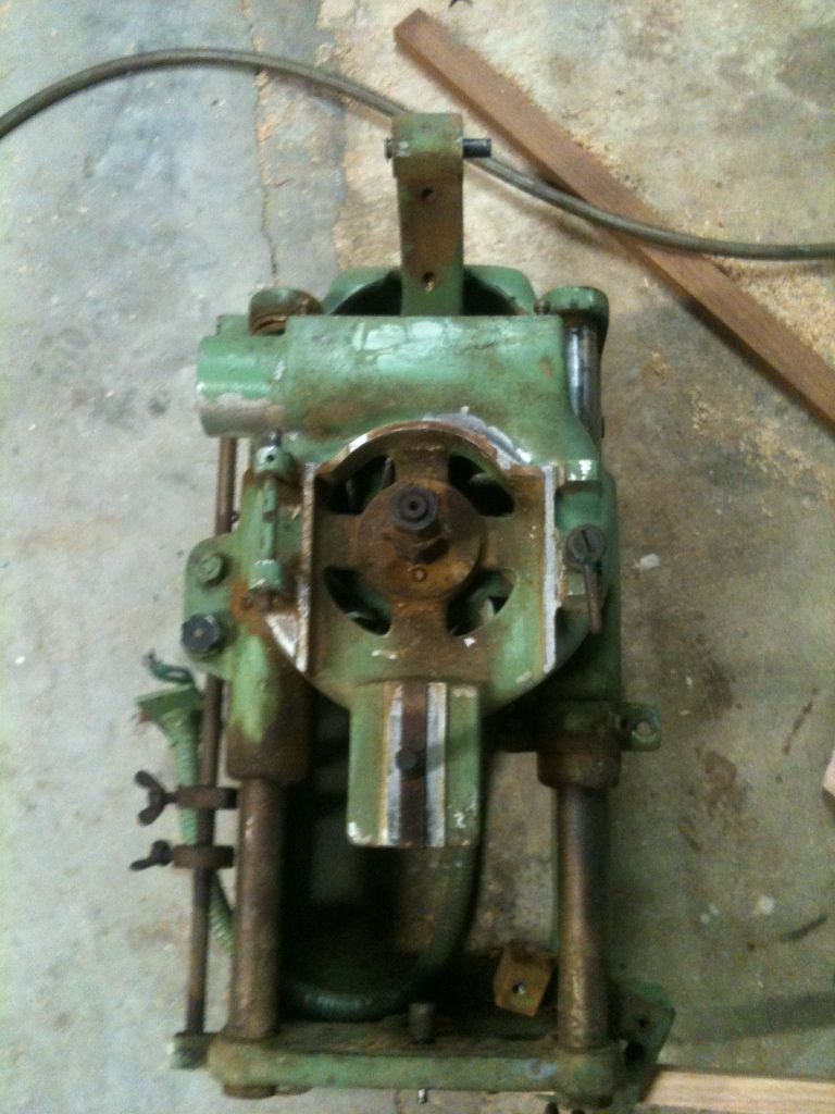

« Reply #8 on: June 09, 2012, 09:39 PM »

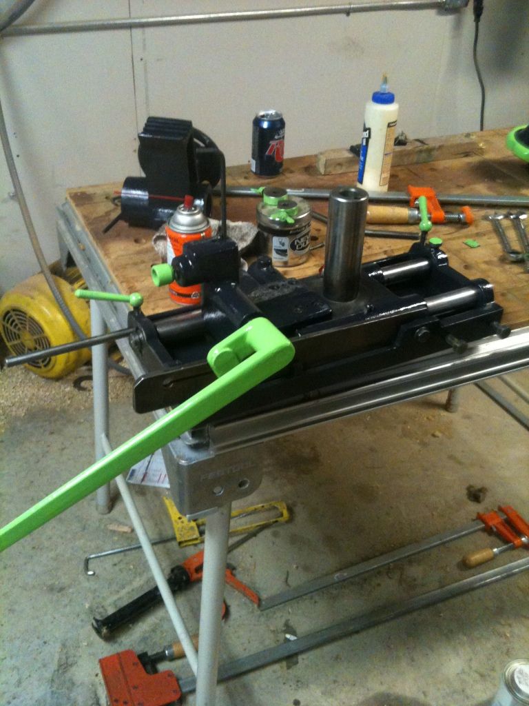

Making a little progress.  It is crazy hot and humid which really kills my pace and the paint drying pace.
I received an email from a friend, which included the name, address and phone number to the son of the man that first started importing Festo.
I was told they still have a building with parts, some machines and literature.
Hopefully the table and clamp assembly can be put back together tomorrow and I might have some more time tonight to dive into cleaning up the head of this thing.
As of now:

« Reply #10 on: June 10, 2012, 12:06 AM »

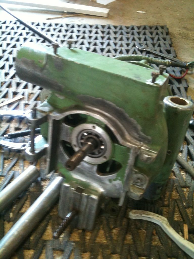

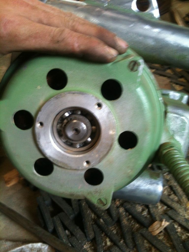

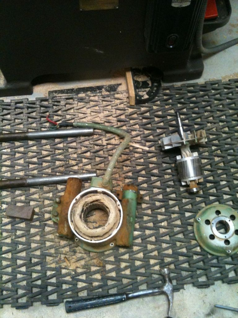

Head is apart.  Bearings were pretty dry with some caked up grease, need a good cleaning and some new grease.  Hopefully I can find the correct tip for the Festo grease gun that came with it.

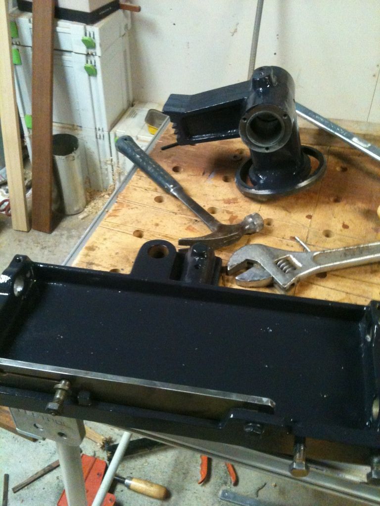

« Reply #12 on: June 10, 2012, 03:07 PM »
Motor is all cleaned out, all old grease has been removed from the bearings and it has been reassembled.
Rest of the head has been cleaned and prepped for a coat of primer then paint.
I started assembling the fence and a couple other parts.
Logged

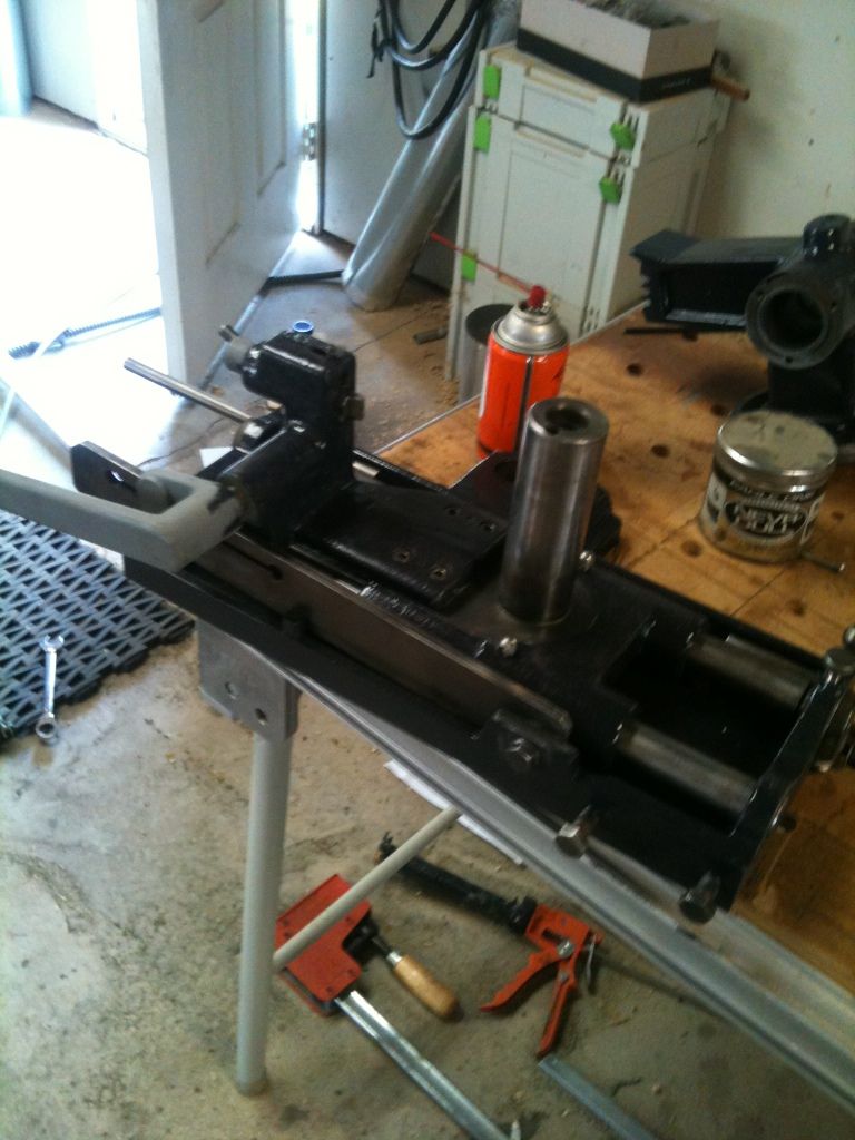

WarnerConstCo.
Offline Offline
Location: Auburn, In usa
Member Since: Apr 2008
Posts: 3108
WWW
« Reply #13 on: June 11, 2012, 11:22 PM »
Little more priming, little more paint an assembly work.
Even managed to finish up 2 jobs in the shop too.

WarnerConstCo.
Offline Offline
Posts: 3108
WWW
« Reply #16 on: June 14, 2012, 10:33 PM »
I like assembly, it means less things laying around and a shrinking pile of parts too.

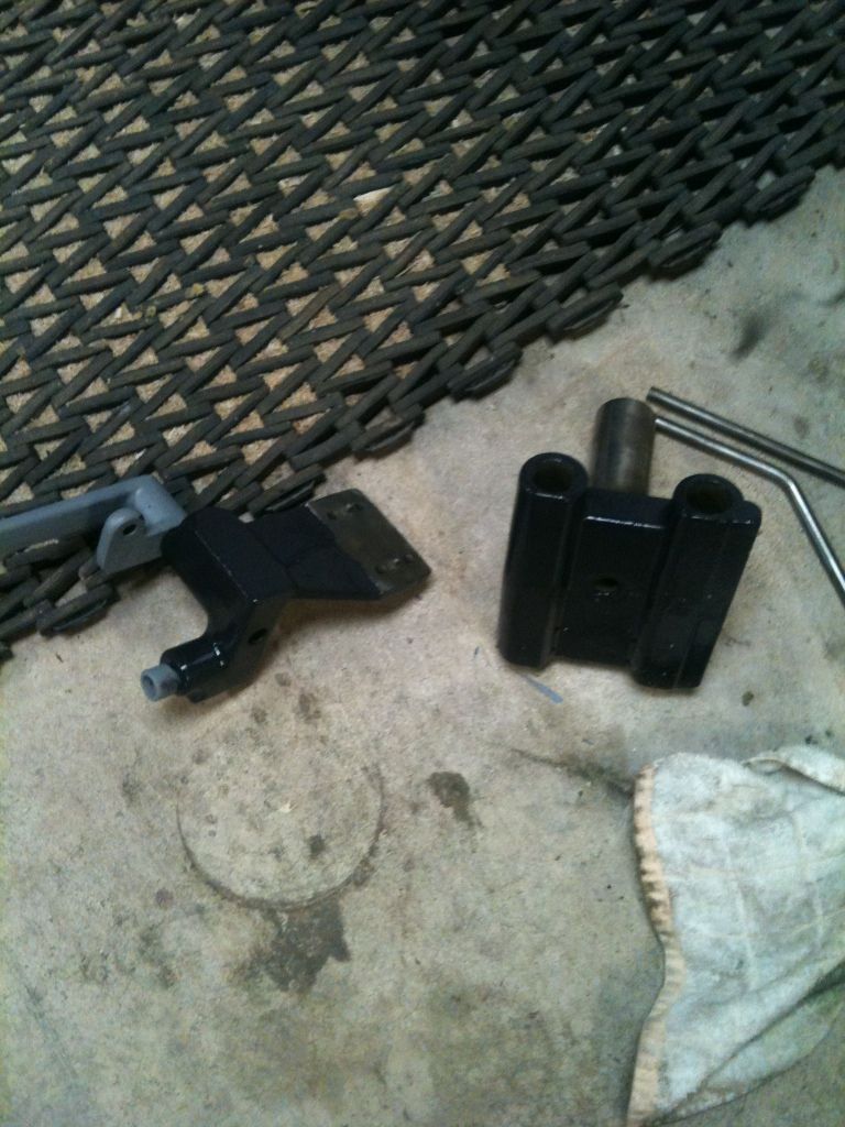

« Reply #27 on: June 29, 2012, 11:39 PM »

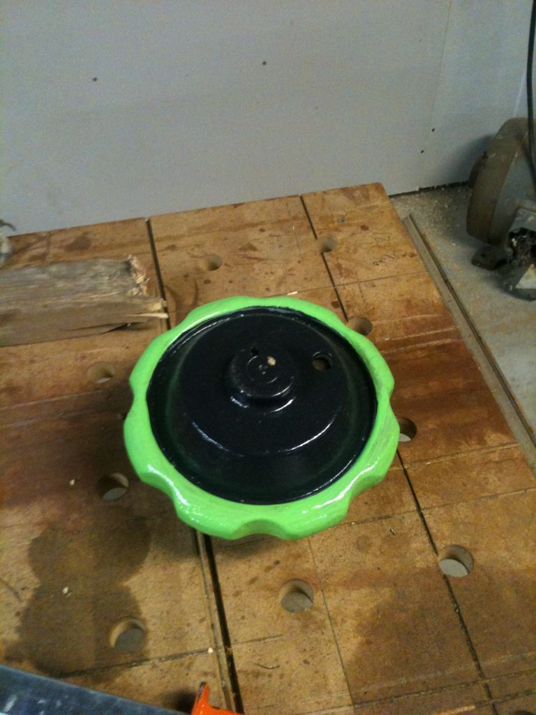

I just got the parts back from my welder that needed repaired.
Almost everything is painted or has 1 coat on it.
I am trying to decide how I want to paint the logo on the cover, piece with the round Festo logo.
I painted it the dark blue and was just going to do the lettering in green, but I got to thinking about using the grey.
Then I thought grey background green lettering or green background with grey lettering. Scratching Chin
Let me guess, it's not bark blue?? Big Grin
