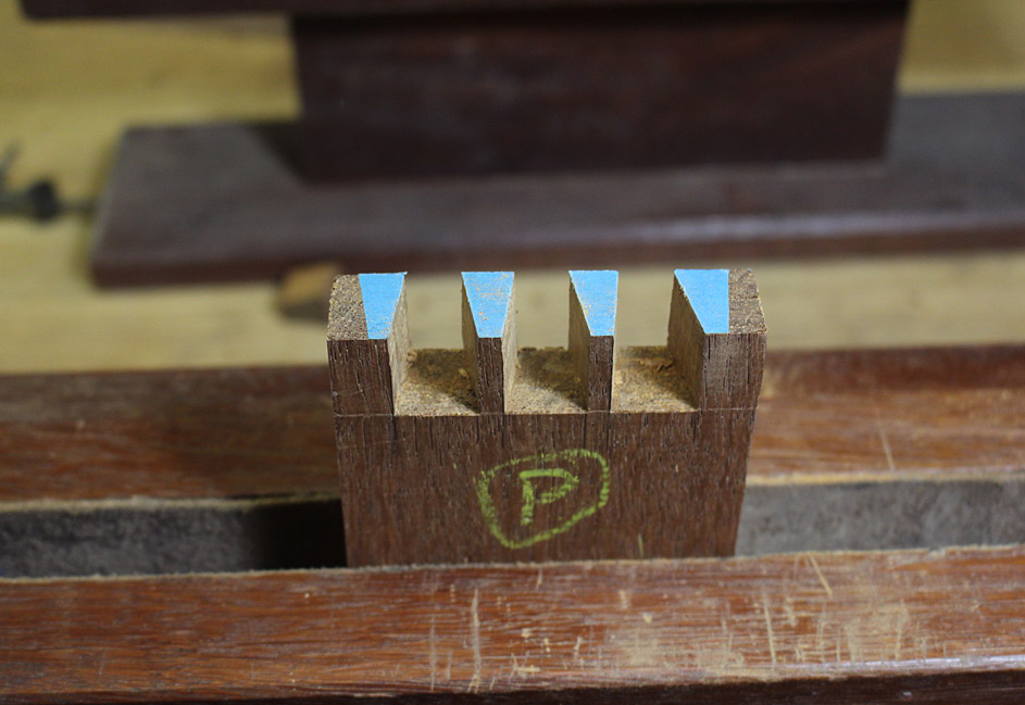

The immediate challenge is to create the curved ends. The plan is to make dovetailed corners, round them on the outside and add a filler/filet to the inside corner, which will be hollowed to compliment the outer radius.
Complicating this is the need to mitre the insides of the dovetailed ends, since this will permit the shape to flow better than butt ends. Interesting ... as I have never made mitred dovetails to date. This is going to be a steep but quick learning curve!
I spent some time researching mitred dovetails. There is not much around. The only book I could find with directions was Ian Kirby's "The Complete Dovetail". I like Ian's work, but the writing here were not his best. There is a short video by Chris Schwarz (Google for it), which was helpful. There was also an article on the UKWorkshop forum (by Custard), which is a Pins-first method (I tend to saw Tails-first). There were one or two other articles to be found, of less assistance to someone like yours truly, who becomes easily spatially challenged. In the end I worked it out but, reflecting on the method that evolved, it does not look like those who came before. Perhaps it is a different way of doing it? I really do not know. Let me have your thoughts here. Anyway, I plan to show it for the education of those who want to learn a method.

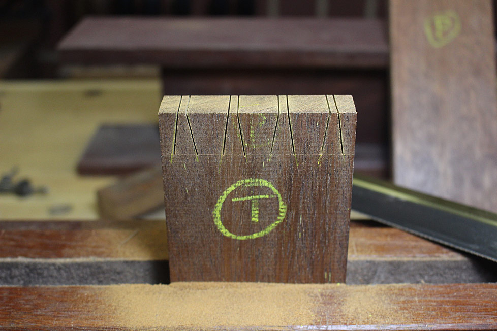

Beginning with a tail board that has been marked and sawn (to speed up the description). Note that there is no shoulder here (which is common on butt ended dovetails). The wood is Merbau, which is hard, hard, hard. 20mm thick, as per the panels on the table ...

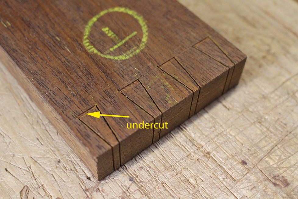

The aim is to saw all the tails. Forget about the mitre for now (... this is a departure from the methods I observed).

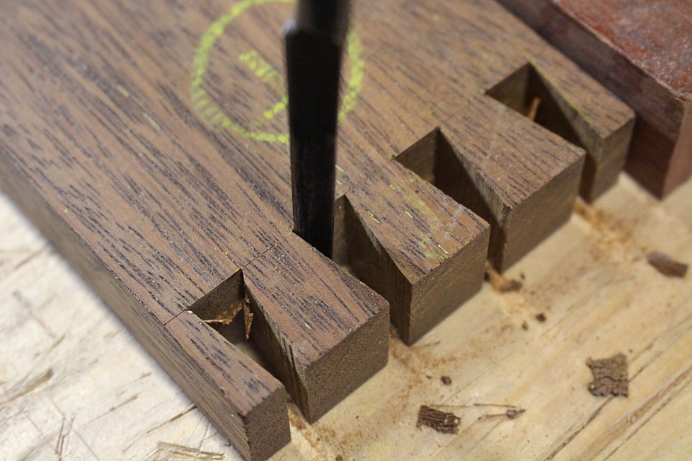

To make the removal of waste easiest, undercut the baselines (shallow cuts to avoid losing vertical) ...

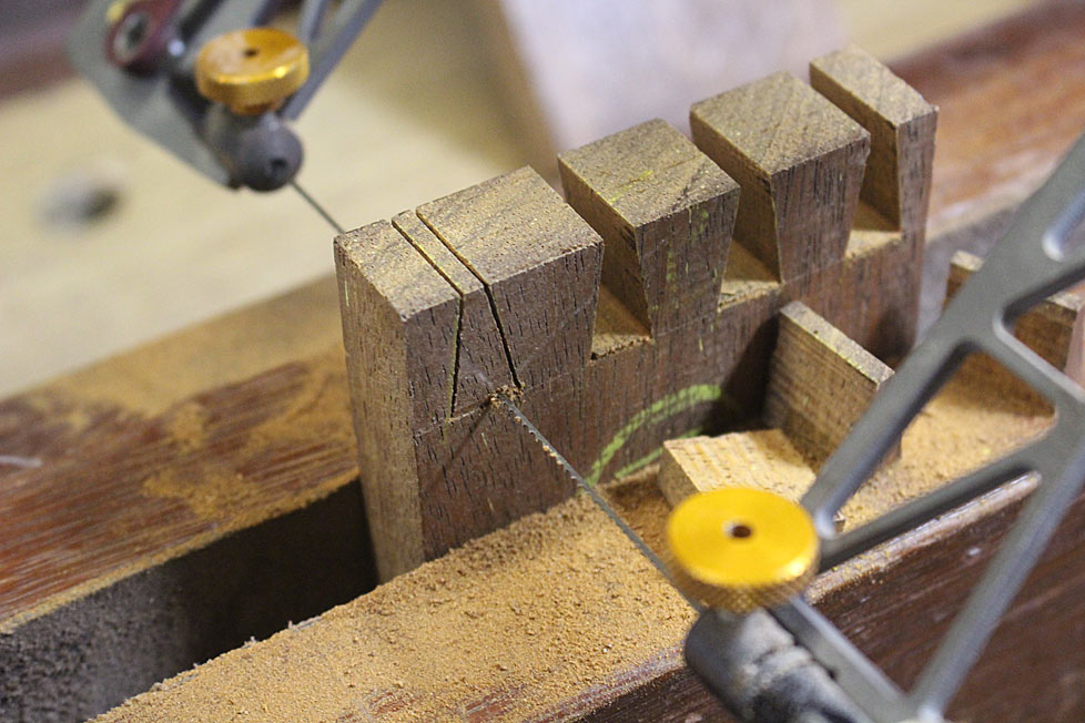

Now fretsaw away the waste. Get as close to the baseline as you dare! My cuts are about 1mm ...
This enables the minimum of waste removal. You can place the chisel immediately against the chisel wall and pare/chop down halfway ...
With the waste removed, mark the mitre cuts at the sides - but do not cut them yet (this is another departure) ...

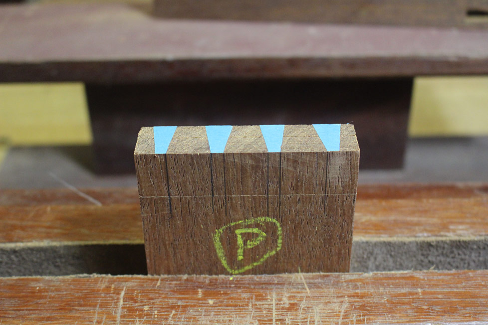

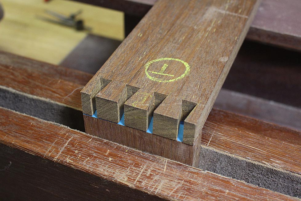

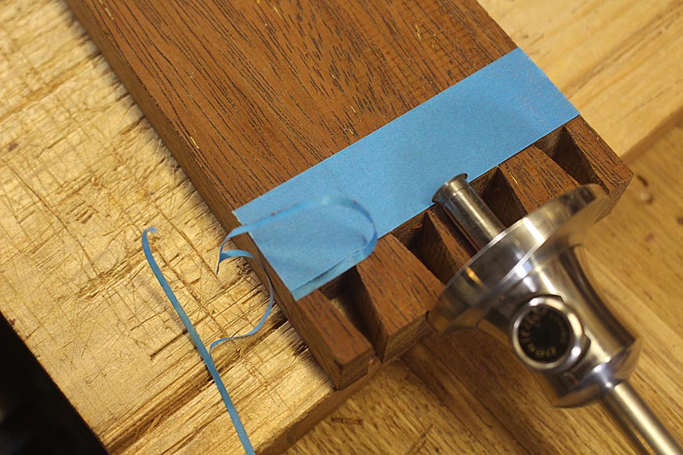

First, here is an alternative to the "#140 trick" (the #140 trick involves creating a shallow rebate to securely connect the tail board to the pin board when transferring marks. This was popularised by Rob Cosman and Chris Schwarz, amongst others). My alternative is three layers of blue tape, which is peeled away afterwards.

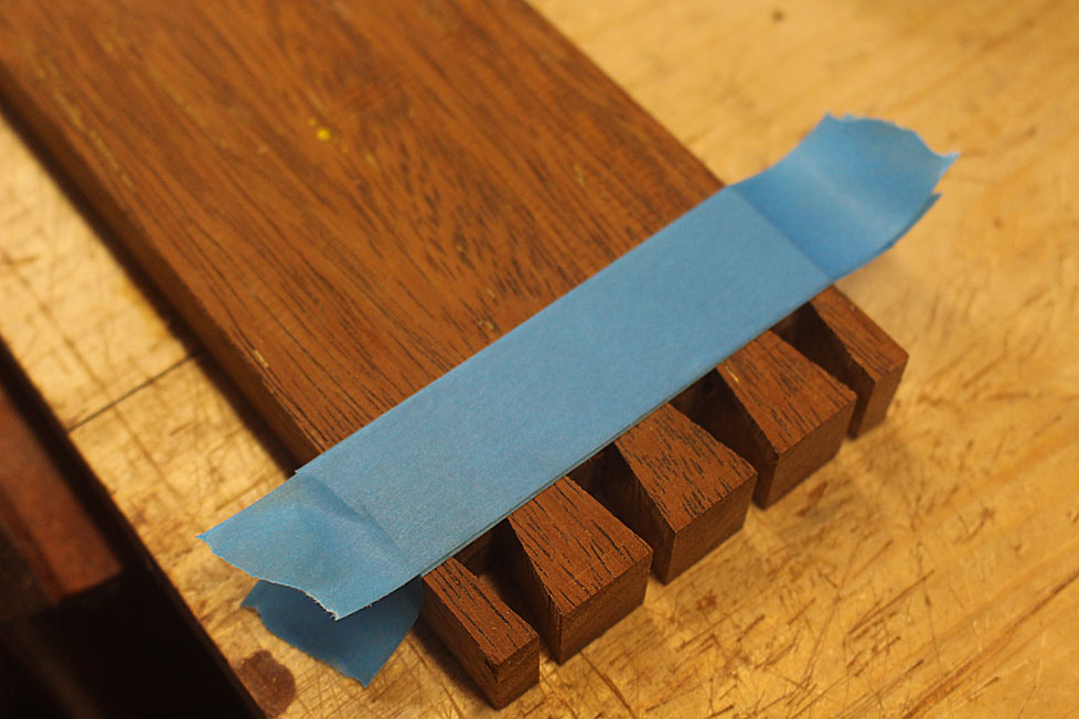

Lay three layers of blue tape over the baseline. No need to be careful ...
Now use the cutting gauge (which marked the tails) to slice away the tape, leaving an edge butting against the baseline ...
This is the fence. Here it is seen with the pin board, which has a layer of blue tape on the end ...
The "fence" makes it easy to align the boards, while the blue tape on the pin board also acts as a non-slip ..
When you trace the sockets (with a knife), the outlines look like this (great for old eyes!) ...

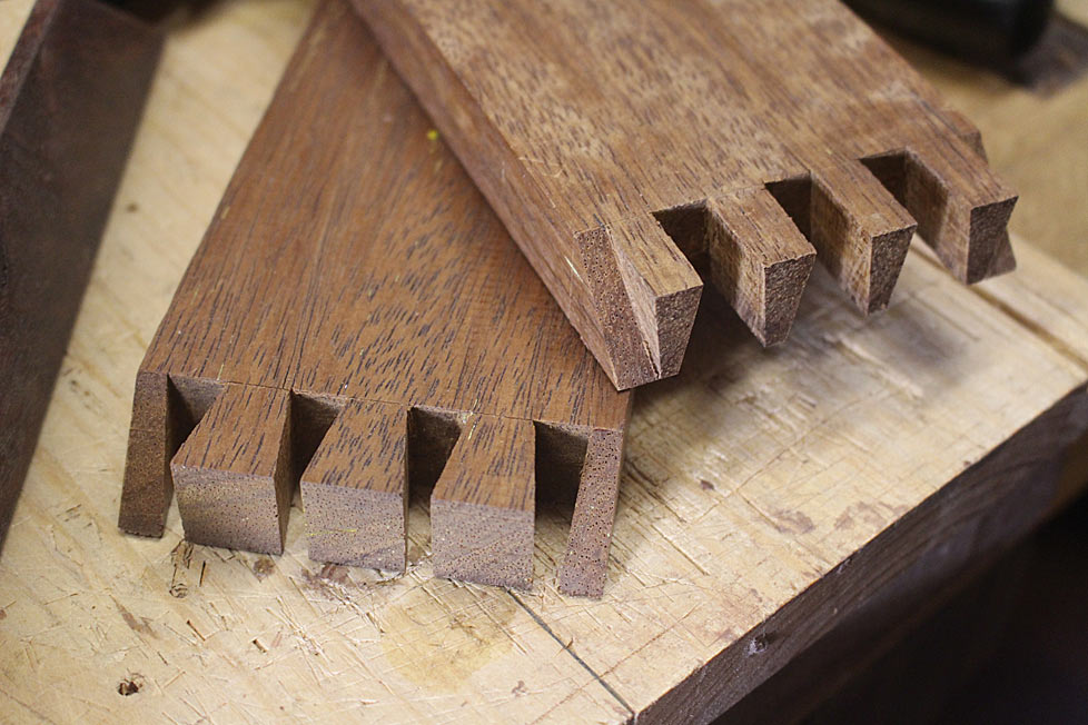

Remove the waste in the same way as done on the tail board (undercut the baseline, fretsaw and chisel) ...

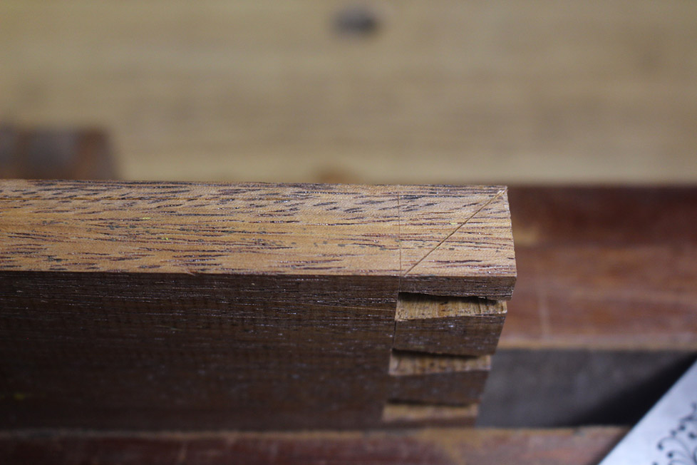

Mark out the mitre lines ...
... and drop the verticals on the reverse side...
Now saw the mitre cuts and remove the waste ...

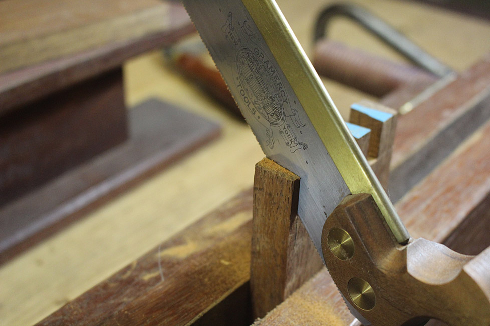

Do this on the tail board as well - the reason it was left until now was that it would be difficult to transfer the outside tail if the mitre was sawn.
Stay about 1mm from the mitre line. Do not saw to the line. This will be more accurately shaped with a chisel.

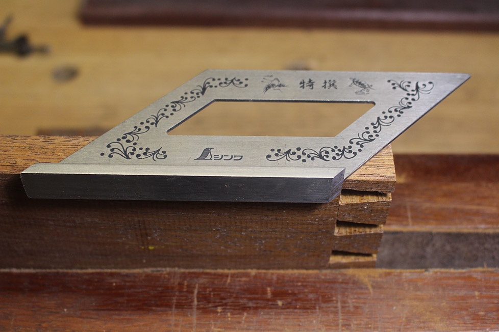

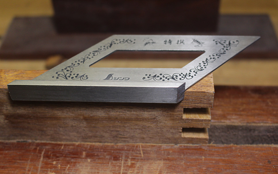

For chiseling, use a mitre guide. This is just a 45 degree saw cut. I made a double-ended guide - to use on opposing sides ..
Take it slowly, a smidgeon at a time.

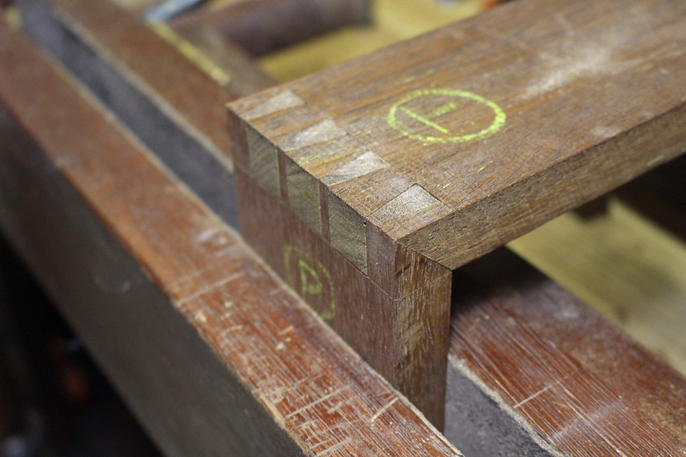

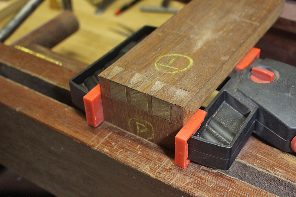

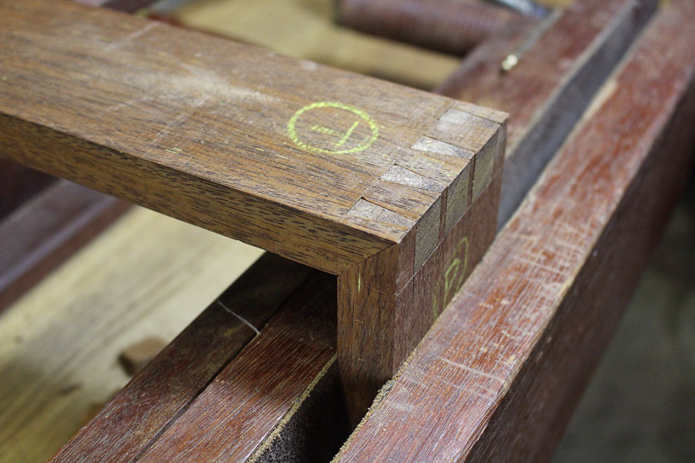

Finally ... the moment of truth arrives ... will she .. won't she ??
Looking promising as the top is pressed together with finger pressure. Then I wack it - the wood is uncompromising. The clamp is to prevent any cracking in such circumstances.

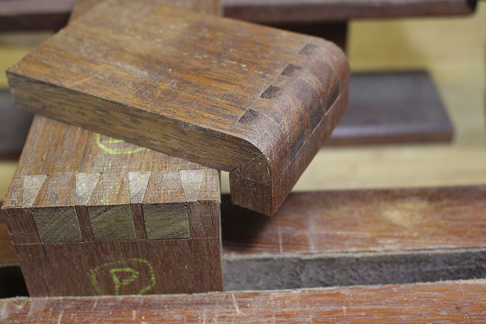

Not too shabby.
Mitres are tight ...

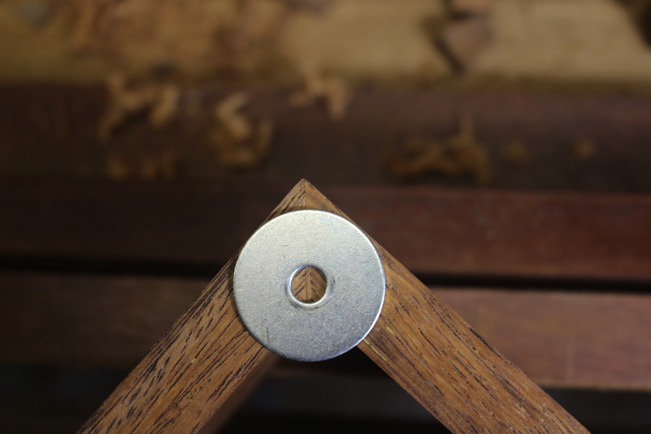

Now about the rounded edge ... here is the secret weapon:
After marking out, the waste is removed with a block plane, and then sanded smooth. Just lacking the inner filet ...
Enough practice. Now for the real thing. A bit more of a challenge as the panels are 500mm wide.

Step 2: Time to round the ends.
In the test piece, it looked like this ..
This lacked the inside hollowed filet. The build today starts with the making of the filet.
The first decision was that this had to be made of end grain. If it was made of side grain, the sides of the filet would be end grain, which would clash - darken - with the side grain of the carcase when a finish is applied. Fortunately, I had this one last offcut. Just enough ...
The filet is triangular with a hollow on the outside. I first tried shaping this with a hollow plane on a sticking board, having sliced off a triangular section on the table saw. It was impossible to do. No way to hold the wood and plane it. I tried a number of variations. I won't go there. They were all impossible. You do it, you're a better man - or woman - than me. You're probably better anyway :)
Finally I came up with this. Start with ripping a 45 degree bevel on the table saw (slider here, with board held in a Fritz and Franz jig) ...
The router table is set up with a round nose bit ...
The mitre can be run past this and the bit will shape a round hollow ..
Now saw this off on the table saw ...
I made a bunch of them (as they are a little fragile) ...
Before glueing them in, each was sanded - 80/120/240 grit on a dowel, with the filet held on the sticking board ..
The filets were then glued in (Titebond hide glue for everything). A dowel was used to place pressure evenly on the corners ...

I used a larger washer than this one this time to mark out the curve (as the radius needed to be reduced) ...
Then began planing ...
Refined with a block plane ...
... and finished with sandpaper.
