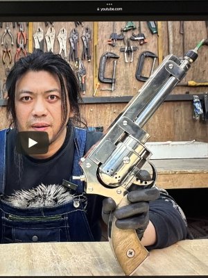

A cordless drill for Dirty Harry (actually a screw gun)
Jan 23, 2007
7,413
The blue end of Richmond County, NY
Custom made by a very creative guy (aka China’s Useless Edison) in Hong Kong, see this video.

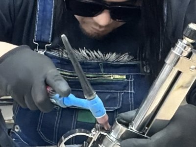

What kind of welder is he using. Looks very convenient for small stuff.

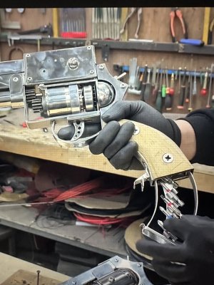

The third pic below shows the 20v volt version he also made. The first gun-driver is 12v. In the newer one he added clever in handle bit storage.

The only Tig stuff I’ve seen used (not that that signifies anything) required a foot peddle to start the current flow.
The torch in the video has a small lever on the side to “go”. What would you call that rig/torch?
The are basically three ways to strike a TIG arc.
In the video he is using a finger trigger accessory.
There is “lift to arc”, you contact the work piece, lift the torch and it ignites (one of the types I have).
Then there is the foot pedal control, it not only allows you the start the arc it also allows you to regulate the amperage up to the maximum you have the machine set at. Also have this set up, it is the set up I use most.
Notice he is using no filler rod in the video, he’s allowing just the molten metal to fuse the parts together.
