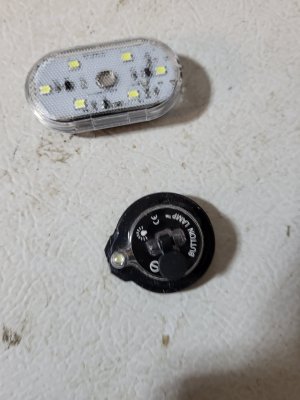

I was using the Trion today to remove the waste on a curved table top, and it occurred to me that I already had a light that might work. This one is sold by Lee Valley ...
https://www.leevalley.com/en-ca/sho...ts/72426-magnetic-led-tool-light?item=09A0490
It has a housing with a rare earth magnet at the rear. So I epoxied a small steel plate to the front of the Trion ...

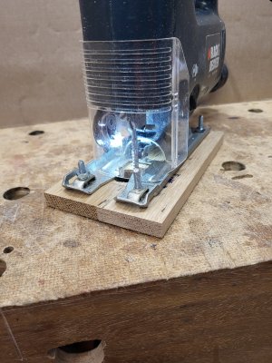

... and attached the light ...
How well does this work? Obviously it does not match a Carvex in this regard, and the dust guard remains off, but the light added was significant. Definitely worth the effort to do.
