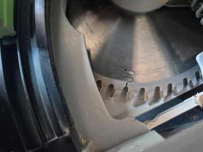

Both still have the original blade, the first saw has a blade marked 2024-06, the second I don't have a date.
What do you guys think? The first saw seems newer and less worn out, does the blade look ok, or will it need sharpening?

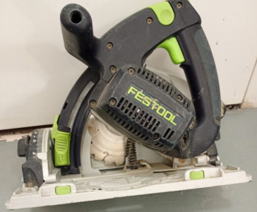

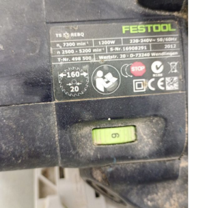

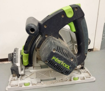

Here a REBQ for 150 euro, this I can pick up in person.
In reality, age is not that important. The main thing is that there have been updates to some tools, and you may miss out on that, with an older model. Festool power tools are designed/built to be serviceable, unlike a lot of the Asian tools. It's nearly impossible to get parts for a lot of them.
As someone who has bought, refurbished and sold many used TS 55's over the years here's my take:
  1. the biggest issue you can have is a saw that has been dropped and caused the base plate to warp or a shot motor. You will not be able to determine this without in-person pickup. This can turn your cheap purchase into a total write-off.
  2. Corded TS 55's still have brushed motors, if you're tech-savvy the above can also work in your favor if a $10 brush replacement is all that's needed to turn a cheap "selling, doesn't work anymore" into a great deal.
  3. don't fall for the too-good-to-be-true prices. You clearly just evaded a scammer, classified sites are ripe with them. The TS 55 is a favorite for scams! (the above mentioned kleinanzeigen.de offers many great deals but is an absolute cesspool for scammers)
  4. if you can't buy in person use PayPal with buyer protection. Do NOT under ANY circumstances let them talk you into paying as "Friends and Family". Remember that you still do not have much recourse on private sales if seller's liability has been waived unless product faults have been deliberately hidden (at least in the EU)
  5. the Q / EBQ models are pretty dated but still a solid option. If it's from a hobby user even a 20 year old unit will still perform well
  6. the models without the "E" and "B" designators are not as powerful (1050W vs 1200W)
  7. Do not buy an early REBQ model (2012 to 08-2015 IIRC); they introduced the -1 and +47° bevel feature but without a stop; cutting precise 90° is often an issue. The ones that have the little green tab at the -1° set screw are the good ones, see reply #6 (good) vs reply #13 (bad)
  8. If you intend to use with a CMS module you need to purchase used; either a Q, EBQ, RQ or REBQ model, DoM mustn't be after late 2019!
  9. Some of my best purchases were tools that were really shoddy on the pictures and only needed some TLC but you really need to know what you're doing. The examples you've shown I wouldn't touch with a bargepole.
  10. Check out the Makita SP6000J as an alternative, I'd rate it just as good as the older TS 55 models. The blade size is more common, it runs on the Festool track and it even offers a simple scoring feature for veneers.
