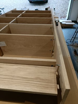

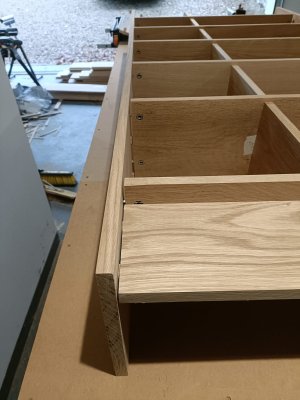

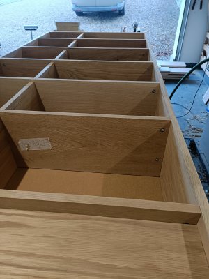

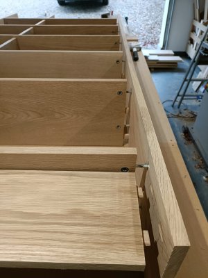

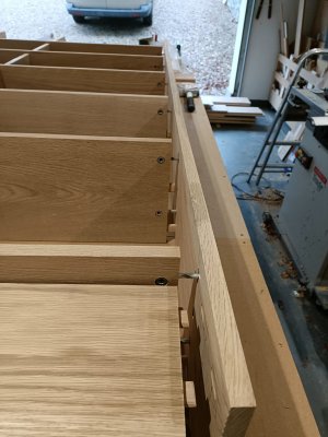

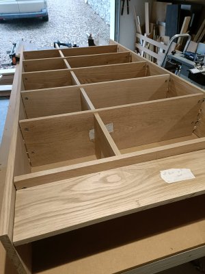

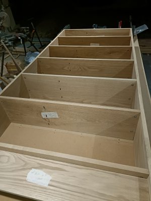

A few weeks ago, I posted a thread on building some large oak bookcases from a logistics point of view. Well I've now taken delivery of the oak and started work on the smallest one - this one is 2m high by 0.9m wide by 240mm deep. I'm using 18mm american white oak - I wasn't best pleased with the oak when it arrived with some cupping across the width of the boards (no more than 1-2mm) - not sure if this is normal or not. I've only ever built bookcases from MDF and birch plywood in the past, which has always gone relatively smoothly, so I admit I am a complete novice when it comes to using oak.
After the discussion on the other thread, I opted for the following domino/connector layout:
Shelves into uprights (front to back): KV connector/8mm domino (tight)/KV connector/8mm domino (medium-wide)
There are also dividers on each shelf which are 30cm in from the left hand side (this was a customer request, rather than going central) - each divider has 3 x 6mm dominoes to align on the top and bottom of each shelf. The divider mortices are all on tight setting with the mortices in the shelves on the tight setting for the front domino and medium-wide for the middle and rear domino. I have morticed all the way through each shelf so that one 40mm domino goes through that shelf and then inserts 11mm into each divider (so I morticed to a depth of 12mm into the dividers).
I went to dry fit it this morning and ran into serious problems. Basically, I can get all the shelves into one side with the dividers but when trying to get the other side in, it was impossible. I just couldn't pull the shelves into the mortices no matter what I did. I've checked all my measurements and don't believe there are any errors with my machining.
I've been using chatgpt to help me out a lot on this - I work on my own and am relatively inexperienced so I find it a useful tool for advice. The problem they suggest is that I could be 0.5-1mm out on various joins, which multiplies over the whole unit and since oak has barely any flex on it, that's what's causing these issues.
Now, I've since dry fitted it without the dividers and it was tight but I managed to get it all together. So I think one solution is to reduce the height of dividers by 1-2mm each in order to give more wiggle room?? I don't really like doing this as I am so used to getting tight joins with my mdf and plywood builds but I don't see what other option I have. I'm wondering whether to also make all domino mortices in the uprights wider?
Any advice from more experienced hands on here very much appreciated. I'll attach some photos.
The other thing is chatgpt is suggesting I'm completely mad to be building this out of 18mm and should be minimum 25mm, especially for the other 3 which are bigger (2.1 x 2.3m and two at 1.2 x 2.7m high). Basically saying that there'll be splitting and cracks etc in the wood as it contracts and expands with heating over time. But there's no going back now - material has been paid for and delivered and margins are tight on this job as it is.
For reference, I've already done 5 bookcases from mdf for this customer, which went really well - both myself and customer very pleased with the outcome.

Yeah, I'd dry assemble the case and cut/test fit (without the dominos) each divider to suit each opening, so you know they fit. Make sure you mark which one goes where.
Once that is sorted, the boards cupping would probably be your biggest issue trying to fit the dividers.
Maybe also hit the faces of your dominos with some abrasive paper, just to very slightly loosen them up.

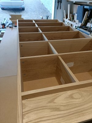

Pleased to say it went together well this morning once I'd shaved 1-2 mm or so off the height of each divider and widened the mortices for a couple of the dominoes.
The mistake I made was to cut all my dividers to the pre-planned heights but didn't account for the actual heights between shelves once assembled due to cupping etc. Another lesson learnt!
Is there any point in me applying glue to this? It is rock solid now, no racking, tight joins. I don't particularly want to take it apart now it's assembled.

Looks great! Nice work!
Normally I would glue the hell out of it, but I'd say looking at those pics that it's more than robust enough so I think you can safely get away with it. Besides I'm assuming they'd be fastened to the wall in some way or are they freestanding?
Thanks luvmytoolz! Pleased with it now after last night's stress!
Yes I was going to put an oak batten below the top shelf and then screw through that into the wall. Plus I'll probably fix some angle brackets too underneath one of the lower shelves, which won't be seen, for additional fixing.
It feels extremely solid, and as I say, I'm not sure what benefit gluing it will add now.
As @luvmytoolz pointed out, glue is your friend with dominoes in a structural joint. The weight of the content and humidity change can affect both the dominoes and the oak pranks.
That said, as long as your case is not subject to undue racking and it's anchored to the wall, you can leave it as is.
If it were me, as a learning experience I'd definitely disassemble the piece, glue the dominoes and reassemble it (after all, that's why you use the knock-down hardware) even though I don't understimate the difficulty involved. You can make the reassembly easier if you can get a helper (just make sure you brief them properly beforehand).
And you did well with your first hardwood build using connectors.
Thanks @ChuckS
Good learning curve. Will have a think about gluing it. The other 3 are bigger and due to their size making transport a challenge, I will likely assemble those on site so I will glue the dominoes at that point.
Thanks @ChuckS
With the connector kit, aren't you going to glue the dominoes to only one of the mating boards (shelves), which shouldn't affect the transport?
Yes I'll glue the dominoes into the shelves and then glue the front one into the uprights when I assemble on site. Was going to leave the rear domino floating for movement.
