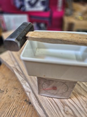

375 g is what is usually recommended, but I really enjoy mine of 225g (edit: the scale says 340 g including the handle. So mine should be 225g or lighter, not 300g as previously stated). The pounding is strong enough for all chisel work, and it is not overly heavy for hammering for an extended period of time. I've used it for a decade and would recommend it for detailed and precision work.

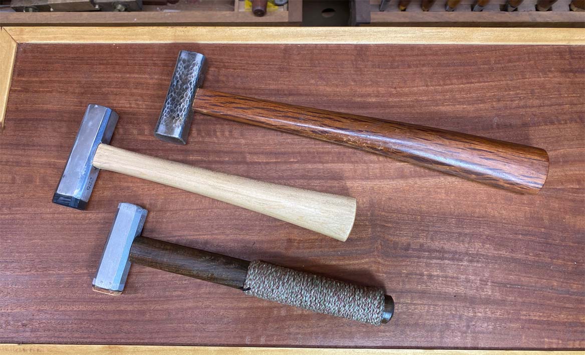

I would not purchase a 375g gennou head unless you intend it for mortising into hard, hard wood. My preference for a bench chisel (oire nomi) is 225g. For a plane hammer, the 150g.
Also, the guy in the video has no clue about gennou handles. Here are a couple of mine ...
To give you an idea of a 150g, see the one at the bottom ...
The middle gennou is a modified 225g head with a short handle for my travel tool box.
A pictorial on my website: https://www.inthewoodshop.com/ShopMadeTools/AHandleforaGennou.html

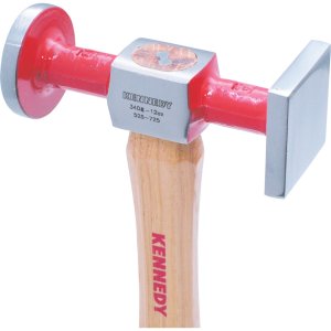

This is the type of hammer I have. I got it and an auto body dolly to hammer out damage to my Alfa Romeo. It was just parking lot damage, but the dealer wanted a fortune to repair it.
Because of the tight radii to the fenders, the steel was very soft and easy to hammer out. In any case, I have had it since 1969, and still use it to strike my chisels when cutting mortises. A very light hammer with a generous face. The one in the image is 12 ounces, and that sounds about right for mine too.

That is a planishing hammer.
