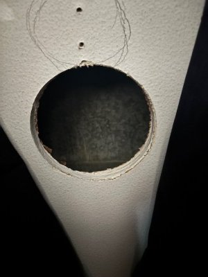

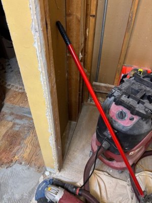

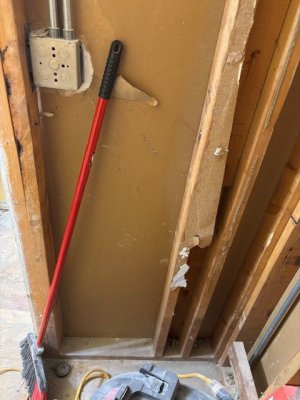

@tjbnwi Thanks for the reply. Here are a couple of photos.

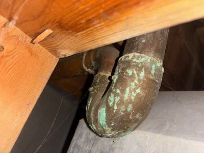

I used a hole saw to cut a visual access point but it may be all I need. The floor joists run in/out of this view but there is a wood 2x10 on the end of the joists supported by 2x4 framing that made me drill lower my original calculated location. You can sell a HVAC duct and my first thought was oh darn it but then when I looked in the hole to the left slightly I can see the p-trap and the drain runs left:

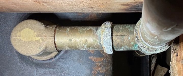

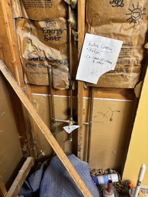

It's hard to get a pic straight up - plus don't want to lose my phone but here is the plumbing. The overflow is straight up and the tub t's into this run. Like I said I can get my hand on the pipe to the tub and almost to the overflow but don't think I can cut the piping from the wall side even with a larger hole. May need to do that from the bathroom I'm guessing:
There should be no need to cut the pipe. Remove the drain hub from the drain shoe by unscrewing it, then remove the overflow screws. Once the hub and overflow anre unscrewed you can get the tub out.
What you describe is the most common tub drain install. The drain hub screws into the shoe/toe, the overflow “t” is the “heal” that the 3 converging lines connect to.
The advantage to copper is you can heat and de-solder it, reconfigure then re-sweat. The copper appears to be in great shape.

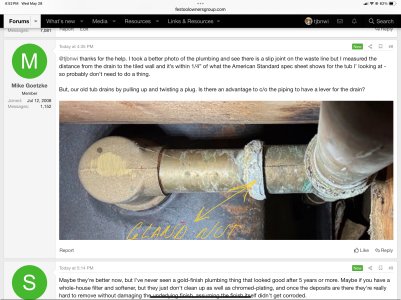

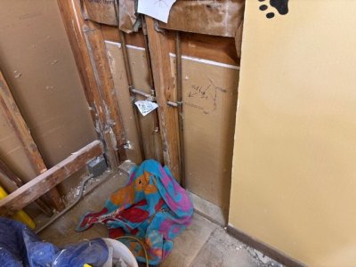

@tjbnwi thanks for the help. I took a better photo of the plumbing and see there is a slip joint on the waste line but I measured the distance from the drain to the tiled wall and it’s within 1/4” of what the American Standard spec sheet shows for the tub I’ looking at - so probably don’t need to do a thing.
But, our old tub drains by pulling up and twisting a plug. Is there an advantage to c/o the piping to have a lever for the drain?

You will need to change the gland nuts and gland washers. It took a screen shot of your picture and labeled the gland nut. You may need to split the gland nut to get it off, hopefully nut. There is a rubber gland washer between the nut and the waste tee. As you tighten the gland nut it compresses the washer against the tube to seal the joint. Use metal gland nuts and rubber gland washers.
When you assemble the drain assembly, just snug the nut enough to hold every thing in place. One of the hardest things to do is set the rubber gasket between the drain shoe and tub drain hole and the overflow and tub if you have limited room to work in. The only “sealer” you will need on the drain will be a rope of plumbers putty on the drain hub/plug when you install it.
Once everything is set and aligned you can tighten the gland nuts.
If you find the toe piece tube has been cut short for your new tub it is available as a separate item.
