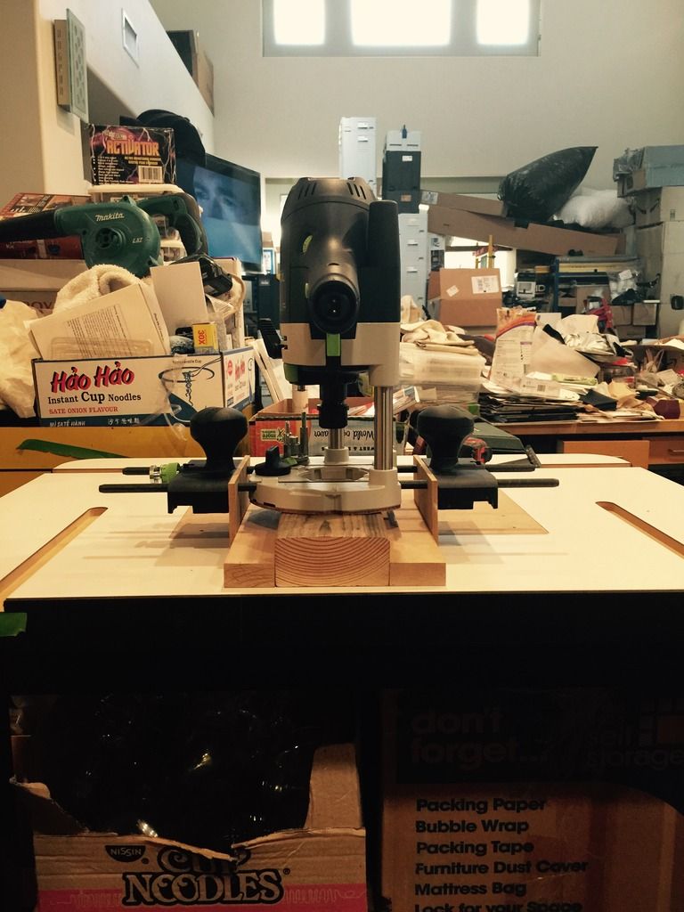

Using 2 edge guides to plow the bottom of a door for a RCT seal.
The router is the 1010, one guide is for the 1010, the other the 2200. The 1400 edge guide holes do not align to the 1010, but the 2200 does. The 1010 rods were not long enough, so I had to use the rods for the 1400, the 2200 rods are to large for the 1010.
