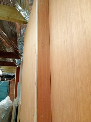

Evening all (at least it's evening in the UK right now ;) )
The build is moving more into jobs I can do.

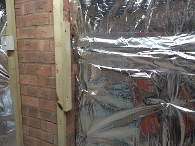

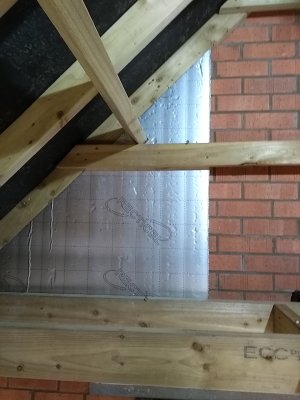

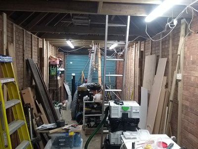

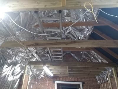

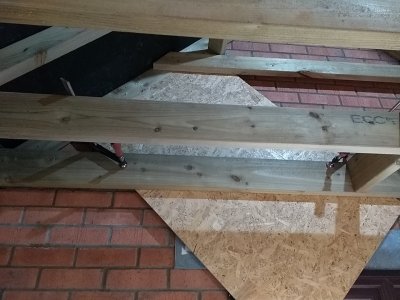

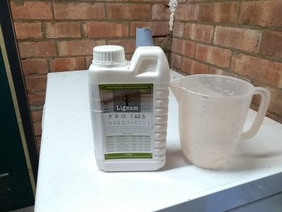

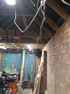

I've sprayed all the old timbers in the roof with woodworm treatment. 16L of dilute liquid, I never thought I'd use that much. I had to relocate all the wiring so I could get to some of the timber, which is why it's tied up with string in the picture below.

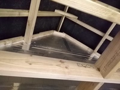

I've also installed 1"x2" battens to take blanket insulation.
It feels like I'm being constantly chased around the garage by all the off cuts I'm saving :(

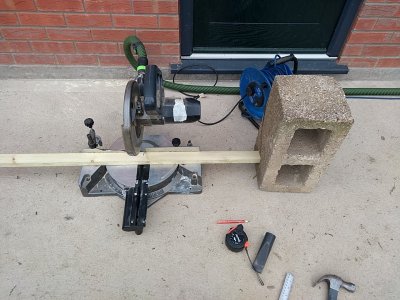

I improvised a gauge block out of a very heavy concrete block, so I could cut the battens to go round the buttresses in the old garage. Eventually the walls will get ply lined.
