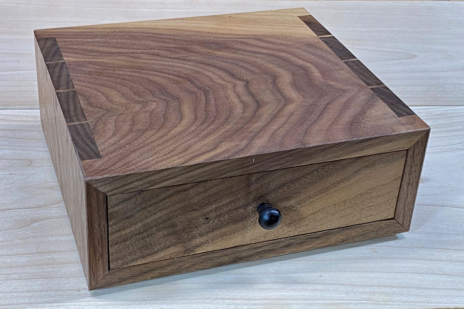

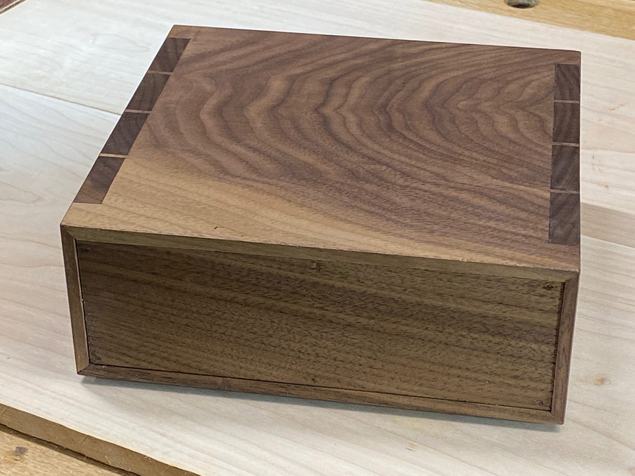

The first box is complete bar any texturing. Frankly, as much as I want to add symbols, I am not sure whether this is appropriate in this particular case as the figure is interesting enough to stand on its own merits. I leave it to you to share your thoughts in this regard.

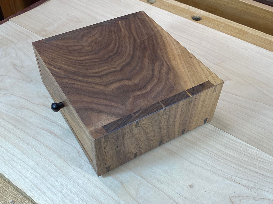

The box is a mini-chest ... single drawer chest. Small - this one is 190 x 175 x 70mm. (7 1/2" x 7" x 2 3/4". Case sides are roughly 1/2"). My thought was that could go on an entrance hall table to keep keys inside. Just an idea.

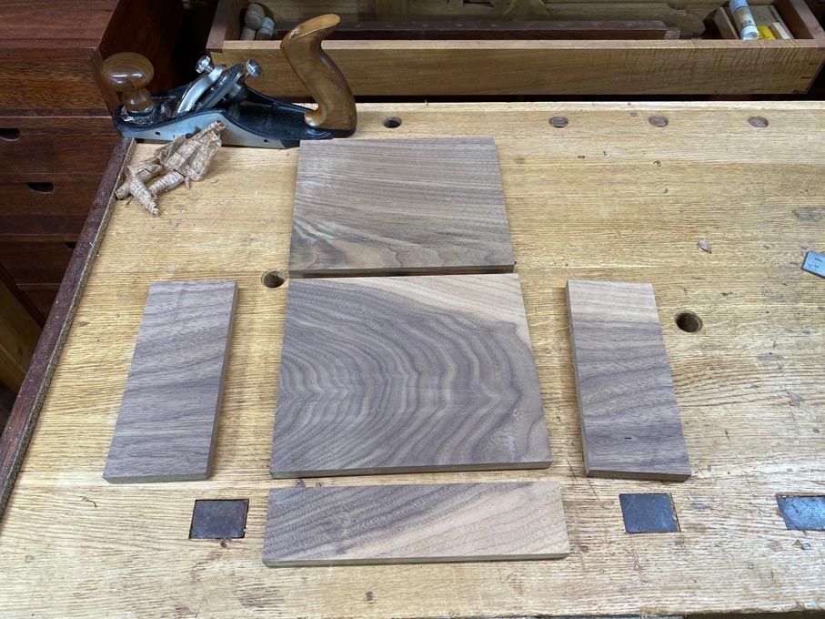

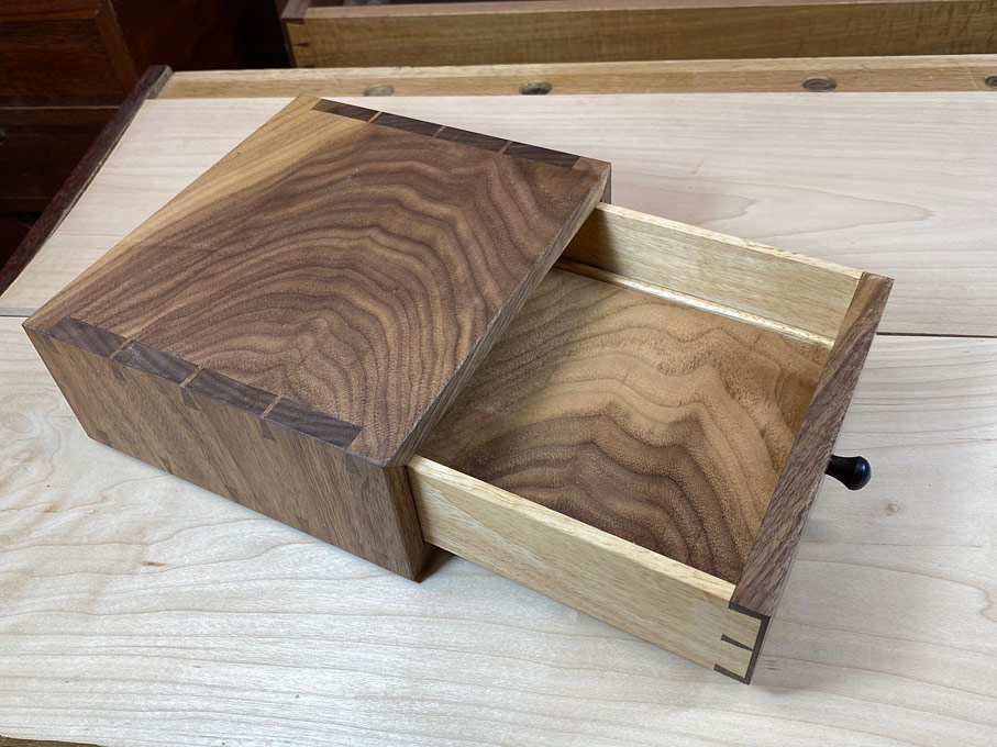

I scrounged about the workshop for small sections of timber. Pieces of USA Black Walnut scraps. One piece was large enough to waterfall the figure from the top to the drawer. The other two sections were all there was.
Work done over three days. Finish is hard wax oil and wax. All hand tools following machine thicknessing.
The case is mitred through dovetails. Rebate at rear for drawer back. Dovetailed drawer.

Turned Ebony drawer pull.
Other side ...
Rear ...
Good extension for the drawer (good fit) ...
I managed to save a thin slice from a resaw, and this became the drawer bottom ...

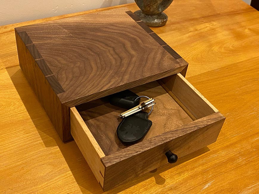

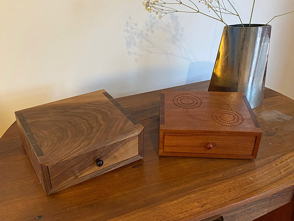

This is how I imagine one use of the box might be ...

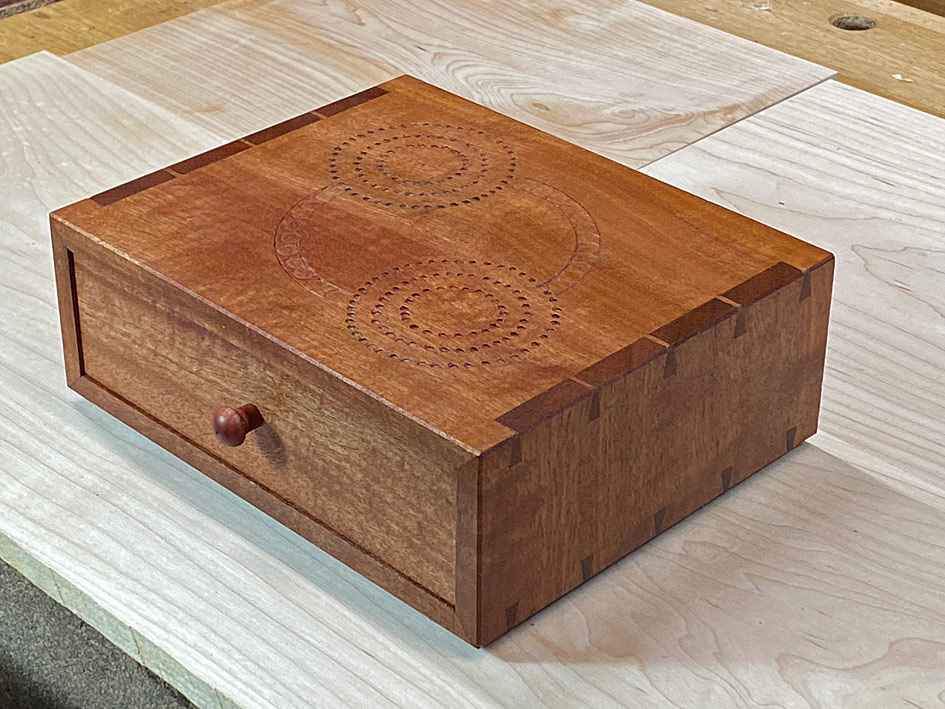

I decided to build this box next. And this time to incorporate Aboriginal symbols, as this was not the case with the previous box, where the figure was too nice to disturb.
The wood for the box is West African Macore, which is wonderful to work with, and has amazing chatoyance. It is perfect for this project as it has little figure or, rather subtle figure.

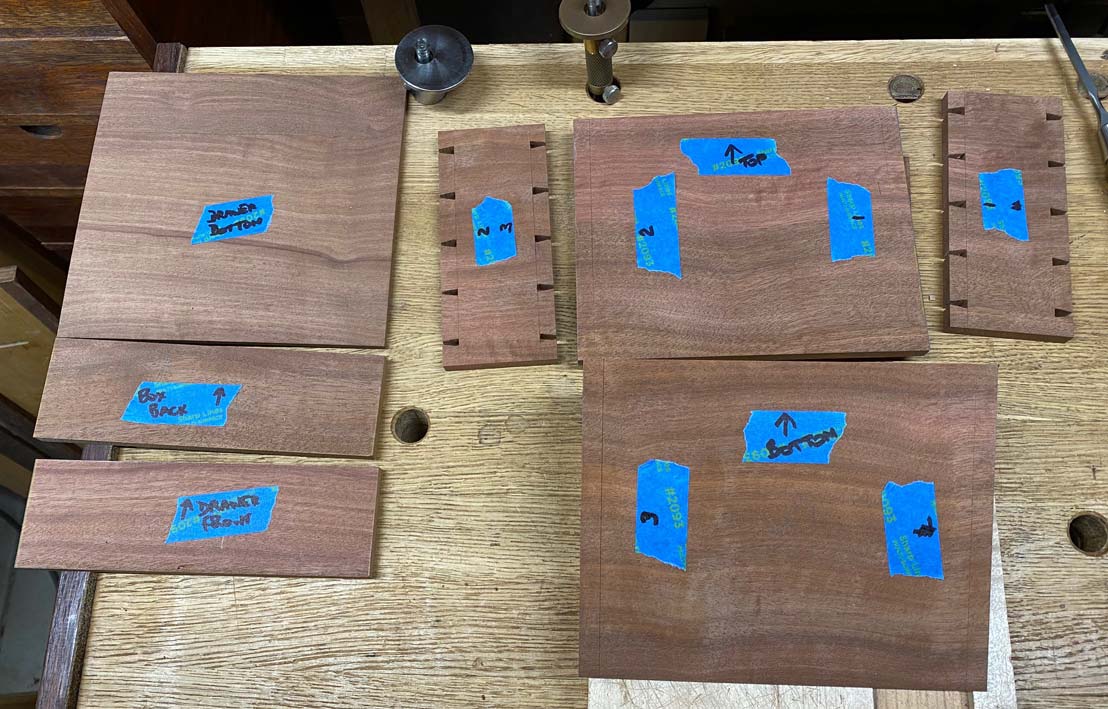

Here are the milled boards laid out for joining. The aim here has been to create waterfall sides to the top, both left, right and drawer front.
Once again, the construction is a mitred through dovetail case with a dovetailed drawer. Overall dimensions are 185mm (7 1/4") wide x 150mm (6") deep and 63mm (2 1/2") high. The case sides are 10mm thick (a little over 3/8").

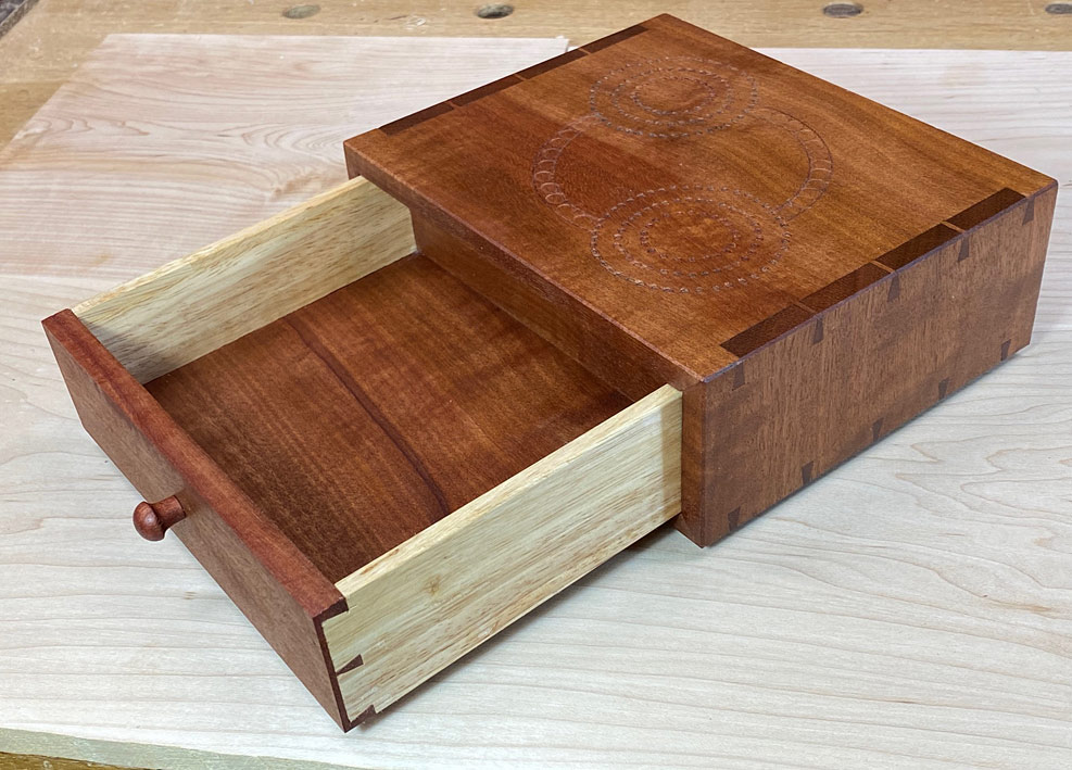

The completed box ...
Waterfall on one side ...
With drawer extended (a nice piston fit) ...

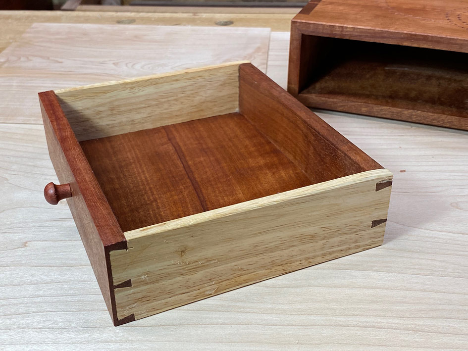

Half-blind dovetails at front, through dovetails at the rear ...

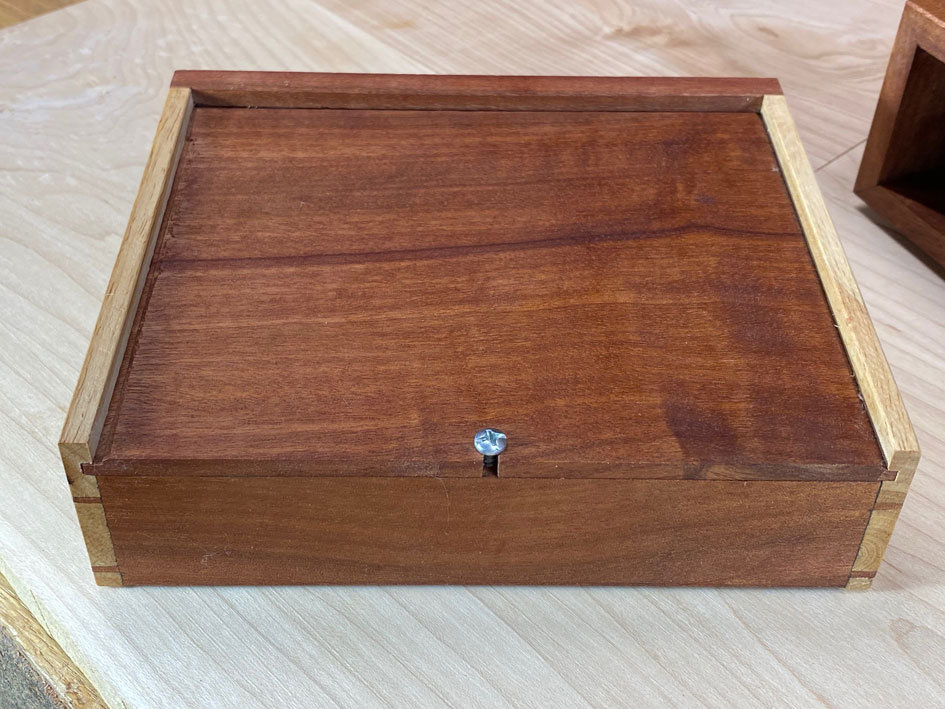

The drawer sides are 6mm (1/4") Tasmanian Oak. No slips on this drawer. Instead, the 3mm (1/8") solid Macore drawer bottom is attached in a 3mm groove ...
It is free to expand towards the rear, and captured by a round-headed screw in a slot ...

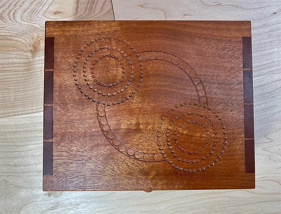

Now let's took at the symbols of the top of the box ...
The two circles (three circles within each other) represent a group, in this case, we have two families. The connecting lines, with circles, reveal the journey each taken by two people to join and bring together these two families.

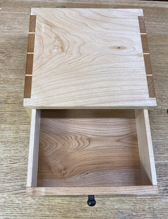

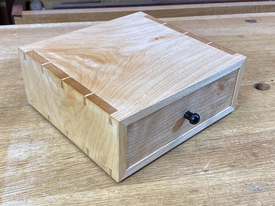

Here is the third box. It is all Hard Maple - case, all drawer parts (with the sole exception of the Ebony drawer pull). This made it a little more challenging as the wood is hard and can be brittle, and any errors will be evident immediately. There is no compression for dovetails, and all need to fix exactly. But the result is spectacular - although I was working with offcuts, I chose clear sections with just a little interesting, subtle figure. This is a box for my son's Godmother, and I was seeking a feminine touch. No adornments.
Case construction, as will the other boxes, is mitred through dovetails. The case is 175mm wide x 165mm deep x 70mm high. 10mm thick.
It is only when you open the drawer that you find strong figure ...

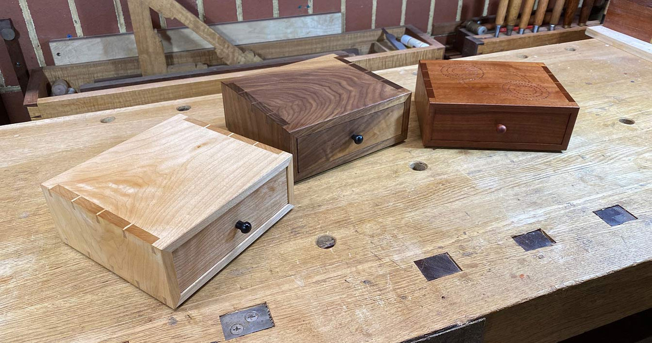

Finally, all three boxes. The Walnut box is for my son's Godfather, and the Makore box (with the Aboriginal message) is for his In-laws.

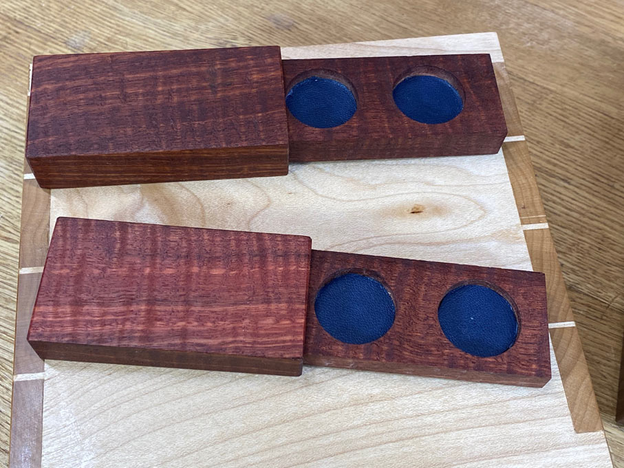

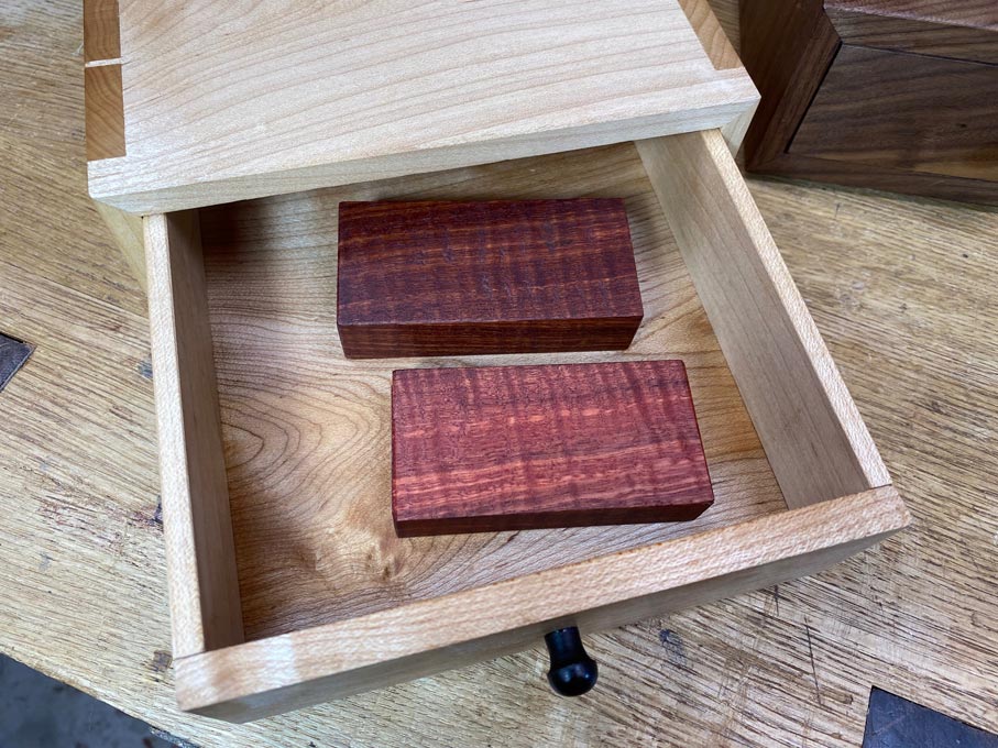

Wait, there is more! A box for the wedding bands. Here ... inside this drawer ...

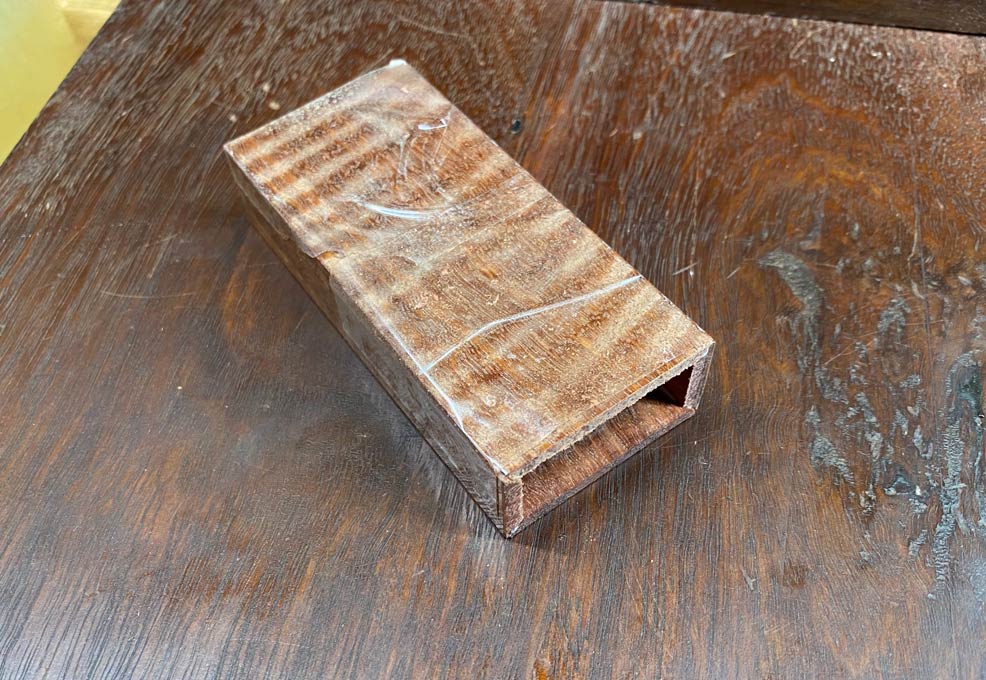

Two boxes, both in Fiddleback Jarrah, both 80mm in length and 40mm wide. One is 20mm high and the other 15mm high. Case sides are 3mm.
Yes I know that they look like blocks of wood. That is the idea  :)
Open the boxes (like a matchbox), and there is a leather-covered recess for two rings/bands ...
The aim was to build the smallest box possible., one that can fit in a pocket without creating a bulge. I made two as I was not sure which size will be preferred.

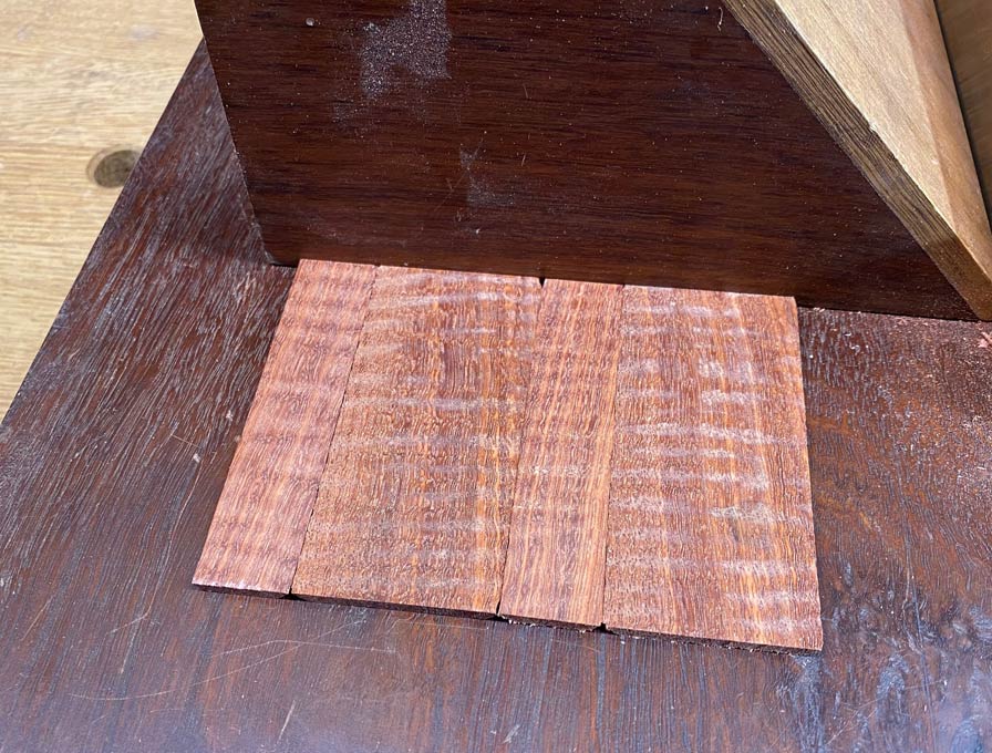

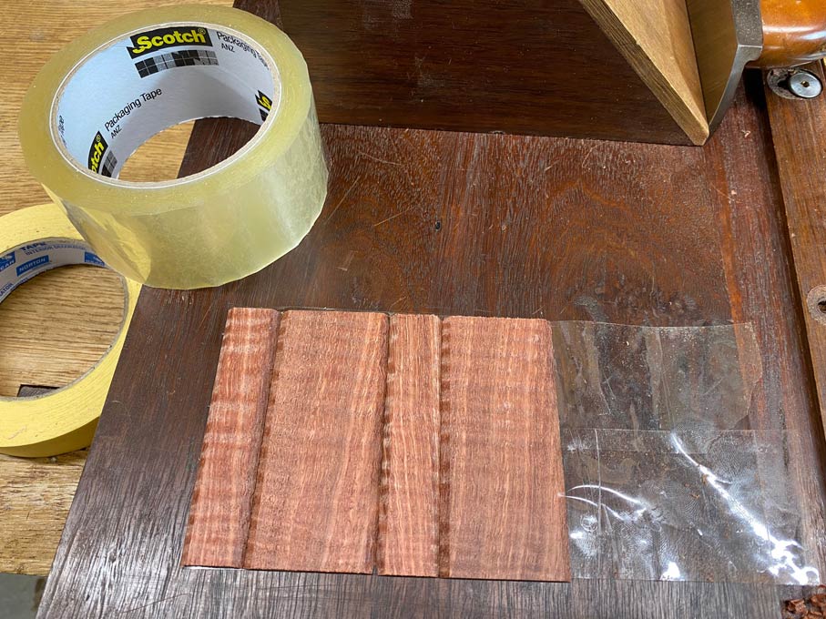

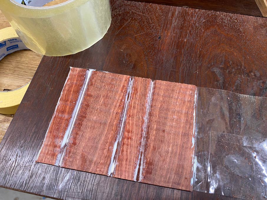

First, find a nice piece of wood and slice it up into 3mm thick "boards". The boards include a section for the top abd bottom, and the two sides. I kept these all in a single piece, and later cut them to length. This way the widths will remain constant.

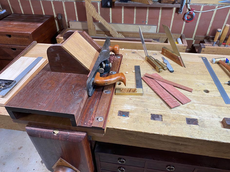

The most difficult and most important part of the build is creating accurate mitres. This was done on a shooting board with Donkey's Ear ...
The Donkey's Ear is precisely 45 degrees. The Veritas LA Jack uses a 62 degree cutting angle as we are planing interlocked edges  ...
Care is taken to ensure that the bevel is taken evenly to the side edge ...
... and then measure the width down the length to ensure all is perfectly parallel ...
Alternate sides. I was not concerned about achieving a waterfall pattern.
Lay packing tape across the back of the butted boards, and flip them over ...
Add glue ...
And now roll it all up and secure the last end ...
The drawer is simply a carefully hand planed solid section, with two round mortices made with a forstner bit. Drop in fitted leather.
Done.
