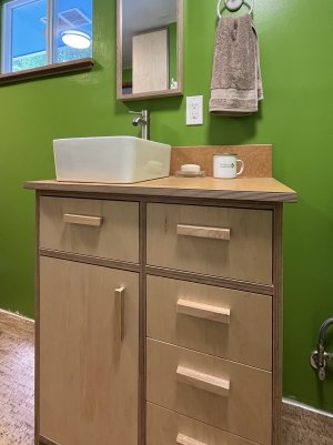

Alas, I'm both concerned about appearances -- I really like the "baltic birch" look -- and we're two bathrooms into the project of redoing our mishmash of '60s vintage cabinets and poorly installed Home Depot particle board cabinets for the '80s. Europly was quite a bit less expensive when we started building the new cabinets & it was easier to get shop grade panels back then too.
Also, I need deeper cabinets (about 29") and they will be pretty heavily (about 100#/drawer) loaded. So I'm looking to find a way to use Europly where it will be visible, and something less expensive for the rest of the structure.

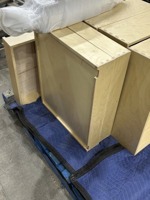

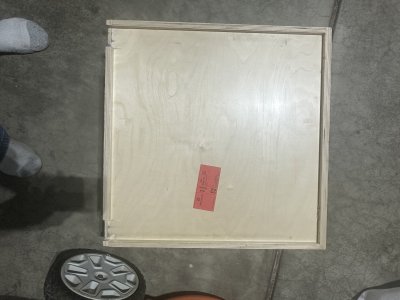

We cut and dovetailed about 50 drawers on the CNC just to see how it would go. Not a one had a void at the edges.
You can see what the plies and finish look like in these couple of pictures.
We did edge band the tops of these drawers, if we do plywood drawers again (our normal is hard maple drawer boxes) we will not be doing edge banding, just a slight round over.
The one with the red label on the floor is going in the dumpster, there is something just not right about it, I can’t figure out what but the new drawer works perfectly.
