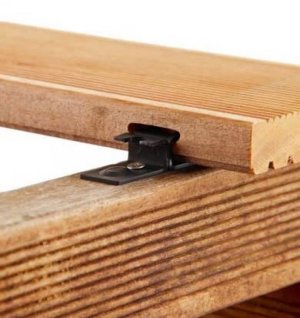

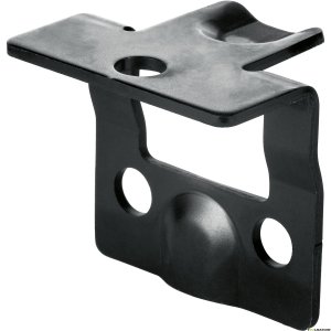

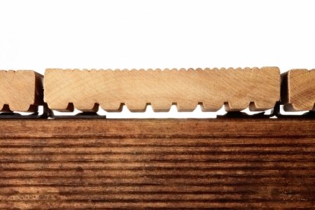

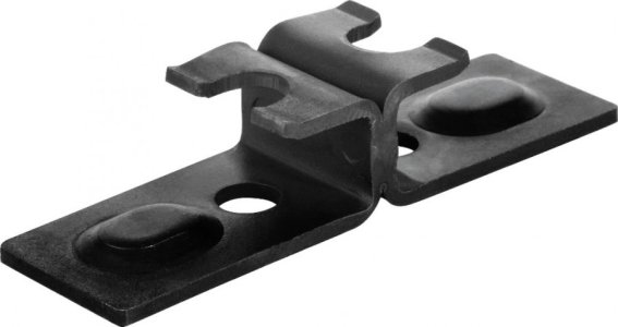

We build our Bangkirai deck (800 sqft) with the Domino and the now discontinued Festool deck fastener system. Although Ipe is classified as durability class one and Bangkirai class 2, I don’t think it makes a big difference. I bought an extra Domino bit, expecting quick deterioration, but never needed to replace the first one, that was used for several other smaller projects before. Still amazed how great the deck looks after 12 years, in harsh climate conditions. That Festool system was exeptionally well made, but of course extremely time consuming.
