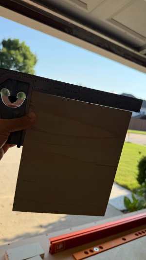

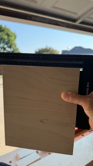

Your Kapex should cut it perfectly. Maybe post a picture of your cut and use a square showing which direction it's out?

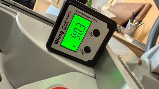

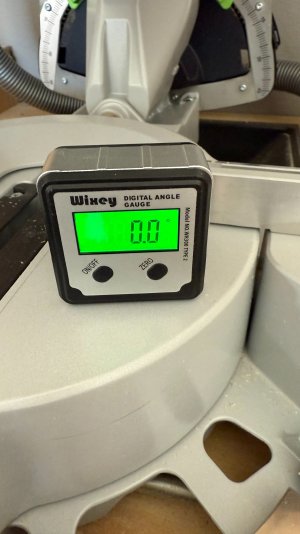

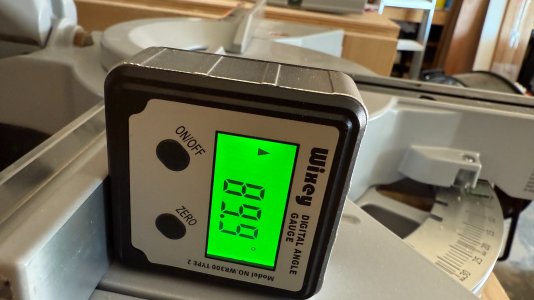

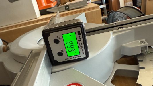

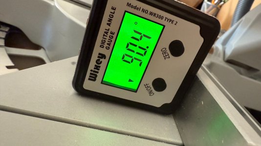

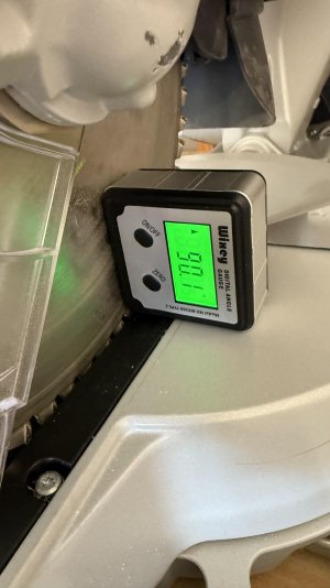

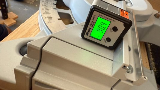

I took some pictures, not sure if this what you were talking about. This is how it came from Festool after repair...I have not made any adjustments. I did call them but was rudely told that it was fixed when it left the repair facility.

So the blade isn't square to the fence when you cut the plywood? That's odd. Thanks for the pictures
The fence is not 90 degreed to the base. there is a variation of degrees from right to left. It could just be the fence that needs to be replaced
Time for the obligatory-from-me caveat that while the angle cubes are handy, they're not uber accurate. Wixey itself only claims +/- 0.2º accuracy, with repeatabilty at +/- 0.1º.
Your squares are much better than that. Personally, I'd use a good 1-2-3 block and feeler gauges to check fence to table and blade to table squareness. But, for cutting plywood flat on the table, if your fence is straight (good straightedge with feeler gauges to test) than it's just the miter angle that needs to be tweaked.
However, @Zafar 's comments seem reasonable - the fence might have a twist in it, which affects not only in the horizontal plane, but in the vertical planes as well.
