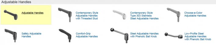

^ just bought 4 of these.  I'll use for small fences (ex drill press) where it's tight quarters. Thanks John H.
When they arrive I'll report on their sturdiness (for the task posed by they OP).
