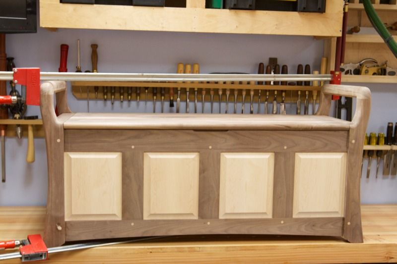

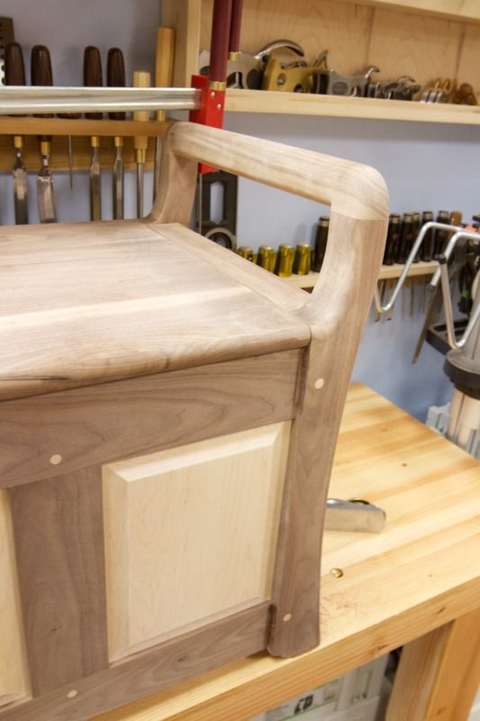

I own the ETS 150/3, ETS 125, DTS 400, RO 90, RO 125, RO 150, RAS 115, and the LS130.
Some of the sanders I use for specific work like the RAS for coping and my DTS 400 I use for drywall work (small projects). I am wrapping up a blanket chest project where my primary sanders were the RO 90, RO 150, and ETS 150/3. I used the RO 150 for roughly flatening out hte panels, removing glue, rough sanding up to 180. I then used the ETS 150/3 for finish sanding. The RO 90 was the workhorse for the project. The chest consisted of curved (for the lack of a better term) armrests and I need to blend with mating panels/pieces.
I roughed these out with a rasp and then smoothed them out with the RO 90. The pad is soft enough and small enough to get into concave curved surfaces. This is something I didn't really think about until I tried it. I also used the delta head quit a bit for getting into the corners and cleaning up any glue squeeze out that I missed.
I would think that those three sanders are a great combination for most furniture projects.
Wow - very nicely designed and built!  Can't wait to see that finished...
I've got a bunch of old walnut a client gave me and though I've never cared for it much, your chest is inspiring.
