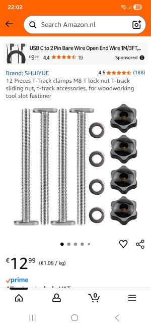

Thanks for the quick reply Peter. Am thinking about T-bolts. On the side facing T-track it will work. On the top facing T-track the nuts will be above the table surface. Prefferably I would like to have an flat surface so nothing is in the way of any workpiece or fence.

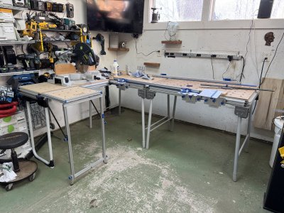

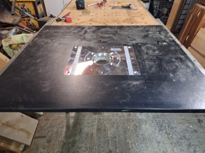

This is something my friend and I were discussing yesterday. He just got an MFT/3 with Dashboard Outriggers. We're thinking about creating a new top for the Outrigger and then mounting either a router plate or router lift into it.
The Outrigger is that little top attached to the MW1000 extension that the Kapex is sitting on. Not sure though what the availability on that is in the Netherlands. And it is a bit pricier than the TSO option.

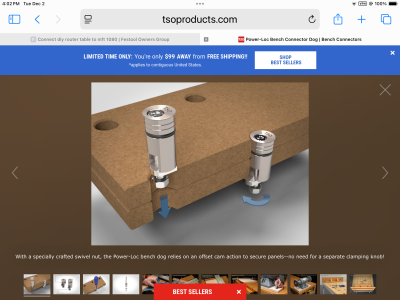

TSO has lot of options ….cheap and expensive but what about using these expanding dogs (and maybe Peters idea with bolts) to secure the home made router table
That Dashboard stuff is big money… but we are here on our Festool board and anything is po$$ible lol

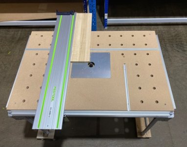

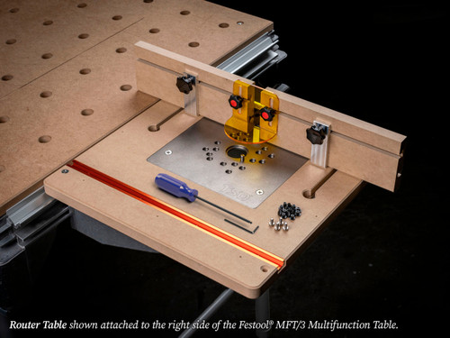

And for inspiration, here's the TSO one, I do like the bracket idea:

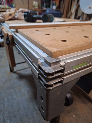

Saw this video and really like the idea of easy attach/removable. But this is on an mft-3. The top of the siderail is different on the mft 1080. On the mft 1080 it is a t-track. This system won't fit.
Also considered bench dogs to make the connection. But would like to keep the router table at same hight as mft 1080. So it could also be used as an extension.

The siderail on the mft-3 is different then on the onder mft 1080. See photo above.

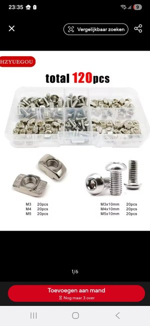

I might use regular t bolts and knobs underneath the table (to connect to the side rail). And brackets would be a smart add-on for stability.
And these bolts (photo below) for the top t slot. Think I could get the to sit flush with the surface. And be abble to tighten them with a hex key (placing a washer underneath to prefent it from screwing itself into the wood.

@onocoffee That's a sweet setup there!
He got it all (minus the KS120) for around $2K. The seller bought a TON of Dashboard stuff to add to the MFT. There are six of the support brackets alone - and two fences. First time seeing the Dashboard stuff. It's expensive but the hardware is robust. My friend calculated it out and I think there's nearly $6K in MFT stuff going on there.
