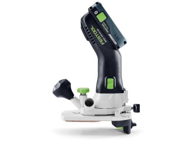

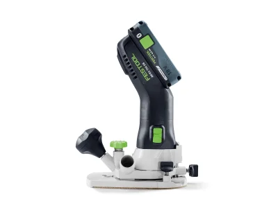

The MFKC 700 KA EB has been recently released in the UK, Germany & the Netherlands, you may want to keep your eyes open for that. I'd assume it'll be available in Australia sooner than in the States. :mad:
That would certainly tick most if not all of the boxes. :)

Well here's the new MFKC 700 EB. It appears to fit in all of the available bases.

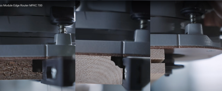

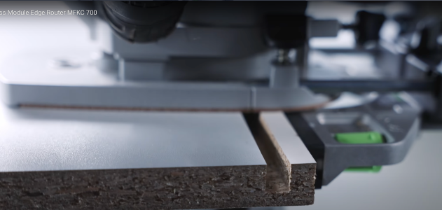

Unfortunately, the Trimmer Router MFKC 700 is an edge router only. that, it can only work close to the edge of a board.
It's certainly optimized for edges, but what makes you say it can't be used like any other router?

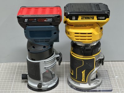

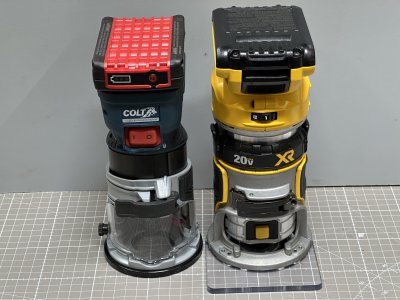

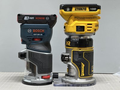

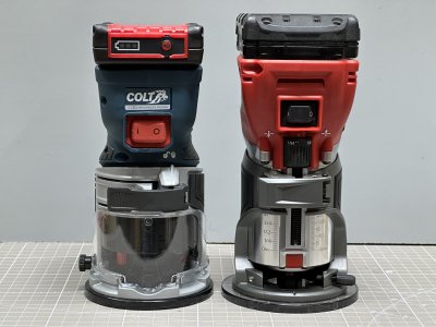

The above pic shows both routers parked at their lowest position each with a 2amp battery.
Girth Dewalt max 29cm, mid 28cm, min 27.5cm
Girth Bosch max 27.3cm, min 23.3cm. The min girth is higher up, possibly above comfortable range, if a longer bit is being used for a surface cut or shallow rabbet.

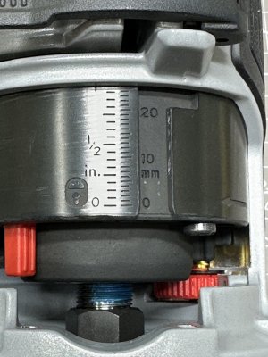

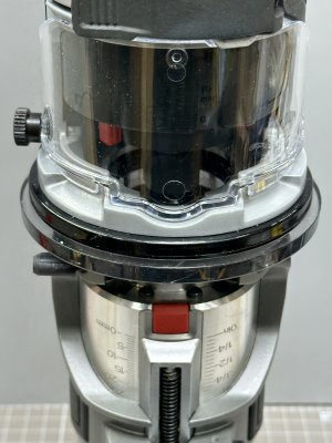

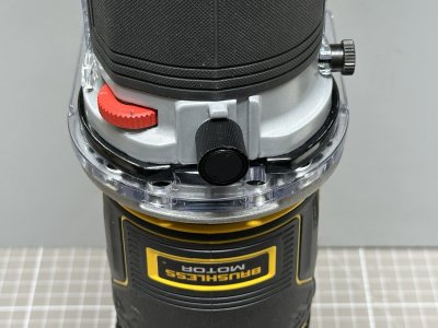

Both have fine depth adjustment but if you prefer to “read” the relative bit depth rather than measure, and expect to change bits frequently, then the Dewalt has the advantage. The Bosch adjustment wheel is the small red disk near the base. It turns a 1mm pitch screw. It has four hash marks so you can “read” 1/4mm increments directly but the marks are far enough apart that you can further subdivide the wheel for finer adjustment.
One important note is that my US purchased Dewalt did not include any kind of dust collection chute. The Bosch included two or three.

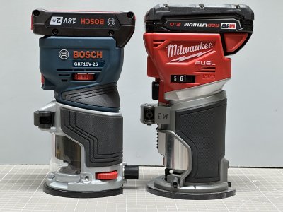

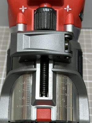

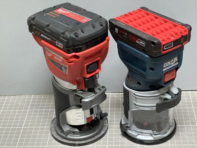

The Bosch and Milwaukee are most similar with depth adjustment via a rotating screw and a simple clamp fixing the depth.
The M18 router does include one dust chute.
Depth adjustment is better on the Bosch as the Milwaukee screw has about 1/32” of uncontrolled lash.
The lesser amount of lash in the Bosch is managed with a spring washer so it is predictable.
The collar/base of the Milwaukee is removable but the Bosch is not so extreme depth adjustments on the Bosch can take some time turning the screw from one end to the other.
Girth of the Milwaukee, max 25.2cm, min 24.5cm.
The Bosch weighs the least. From memory I think the M18 and Dewalt are about the same but those stats can be looked up.
Maybe the most trivial note, the battery locks firmly in place on the Bosch while on the other two the battery wiggles.
