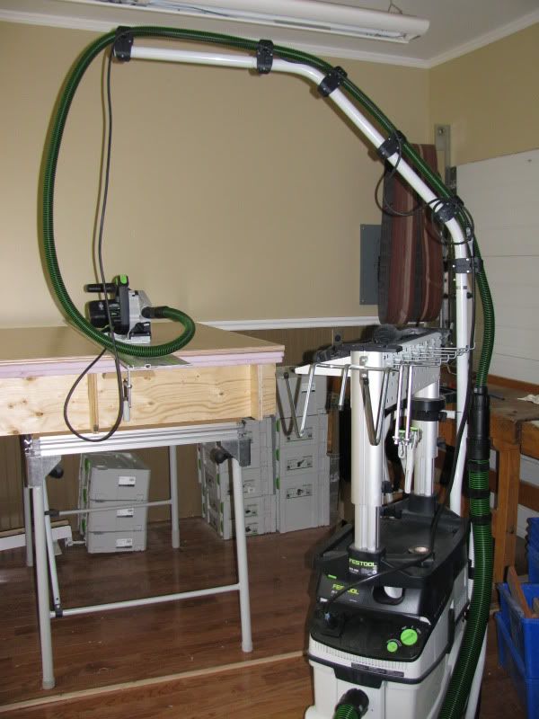

Here you go, boom arm with work centre but on CT36 crosscutting with TS55. Yes you loose 1 hook, no big deal, just hang it somewhere else.
Lambeater
why does yours look more organized and neat then mines???
Hmmmmmmmmmmm
Im going to have to do some thinking
I hate when that happens
Lambeater
What a set up. Thanks for the pic
