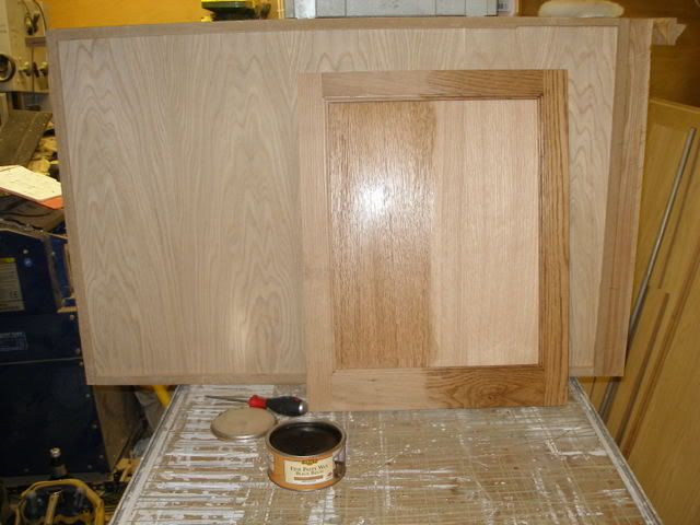

my mft top get changed sort of once a year or so
the photo below shows the abuse it gets
