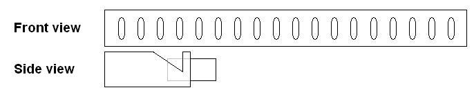

I believe if I just had to make a handfull I'd use a vise and tenon saw.
But if I needed a big bunch of shortened dominos I'd make a jig inspired by the one in Rick's manual...something like this:
[attachimg=#]
...just take a board and domino a lot of holes and cut a V groove using the table saw or router table. Voila! Simple jig ready!
Put dominoes in holes...cut on table saw or band saw...press dominoes out through the V groove.
Kind regards
Henrik

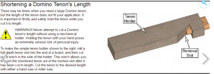

Thank you all for your suggestions. Shoulda looked at Rick's Domino manual!!!! [eek]
