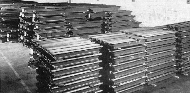

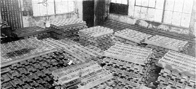

Good job on the laundry list... :) ...once you start to think about it there are lots of "opportunities" to cut corners. I'll just add casting seasoning to the list. The first photo is the room where Atlas seasoned their lathe beds in the 30's-40's. It takes some real commitment to cast those pieces and then just let them sit around for 12-16 months. And here's how South Bend seasoned their lathe beds...stickered & stacked like lumber. :)
