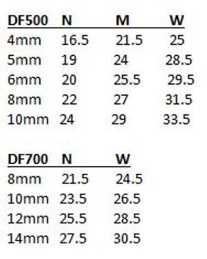

Is anyone aware of a schematic/table/list/crib sheet with the geometries for the DF500 mortice cuts at different settings? ie distances from reference faces and edges, thickness and widths at each setting etc?
I'd like to have a handy cheat sheet that would help me in laying out a project I am working on that will have lots of mortices
I seem to recall seeing something like that but cannot recall where :(
I got slightly different sizes when I was measuring the results to make my own tenons.
Thank you Gentlemen! That's 90% of what I am looking for
Am I correct in thinking that when using eg the 20mm thickness settings the center of the mortice will be at 10mm from the reference face?
