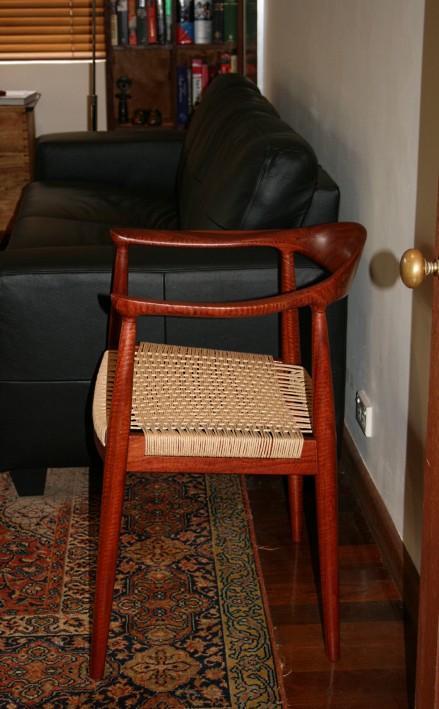

The design of the chair needs to compliment the bentwood chairs we have, which are original and early 1900s. The table is to be replaced with a longer, wider one.
This table is over 200 years old, and has great sentimental value. It is built of Yellow Wood (top) and Stinkwood (legs). We bought this after getting married. Now, 42 years later, Lynndy wants a larger table.

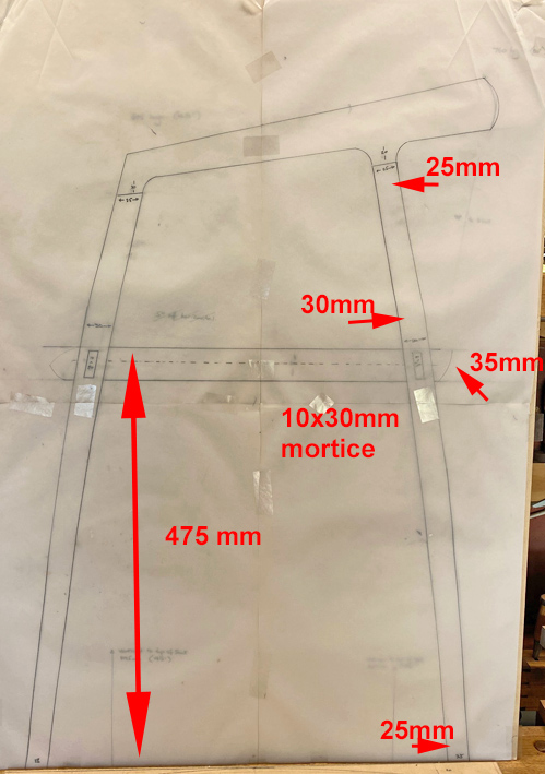

Here is the design.
The legs are curved and round, with 25mm top and bottom, and 32mm around the seat area to accommodate the joinery. The 35mm thick seat will be attached with mortice-and-tenons (not sure yet whether integral or loose tenons). These will be 25x10mm.
The curve in the legs is a desired feature to soften the look and also link with the bentwood chairs. The complication, in shaping, is that there is a taper and a curve.
The height of the top section has been reduced significantly. The design ...
Then there are finer details being worked out, such as the curve at the rear of the backrest and seat to link with the roundness of the bentwood chairs. The transition from the legs to the arm rest is borrowed from Hans Wegner and used when I build his The Chair.
Details of importance: the seat angled at 5-degrees off horizontal, and the backrest is 95-degrees to the seat. The centre of the seat is the same height as the benchwood chairs.
The plan shape for the arm- and back rest will come later.
Thoughts?

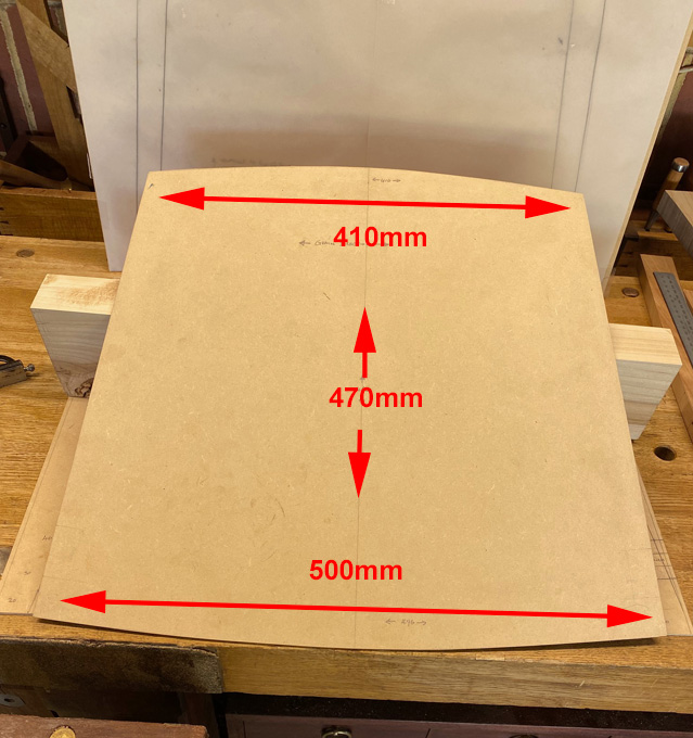

After some discussion, and a sudden increased awareness of dining room chairs, I decided to level the seat in profile ...
The seat will not end up horizontal, however, but be curved across the width, and further carved for extra depth at the butt end.
This is a basic template for the seat ...

A tracing of the legs was used to create templates ...
In drawing the legs, each was mapped out separately, but with the same basic parameters: 25mm diameter at the top and bottom, and 30mm diameter through the centre. Similar curve plotted. The rear legs are roughly 30 mm longer than the front legs, and I anticipated that the proportions would differ as a result. However, when I placed the two templates on top of one another, they were exactly the same! And not only that, but the mortices were in exactly the same position as well!!
As a result, one template was used for both front and rear legs.

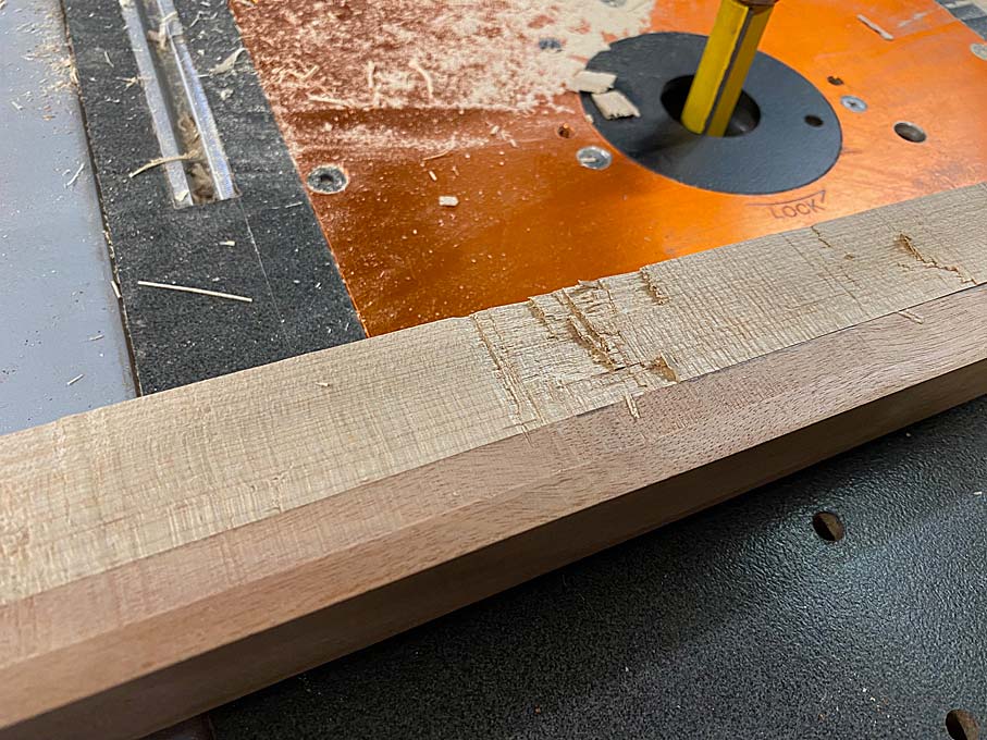

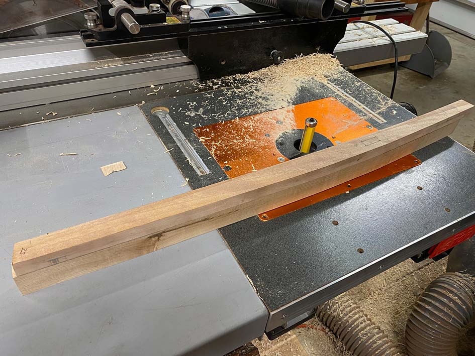

The plan was to bandsaw out each leg ...
... and then use a pattern bit on the router table to trim the waste ...
This did not go to plan. The first leg was uneventful, but the second decided to explode. This is what I feared from the Rock Maple. Even with care in regard to grain direction, and resorting to climb cuts where needed, the router bit I had available was not helpful (the  router bit I ordered had not arrived, and would be some days away).

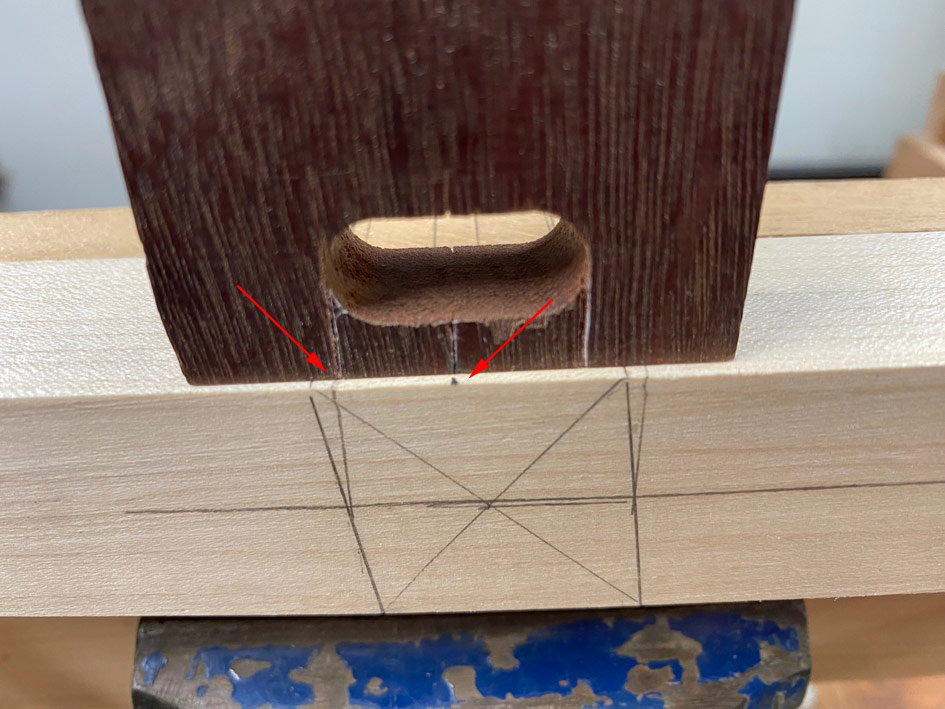

It is vital to check frequently that everything is perfectly square. Morticing would not be possible otherwise.
Rock maple may be hard and brittle, but it cuts cleanly with a plane blade.
The leg blanks are 30mm thick. Once the outline is cut to match the template, the ends will need to be reduced to 25mm ...
Lastly, for now, the position of the mortice was marked on both sides of each leg. The legs will be attached with through mortice-and-tenons, and each mortice is cut half-wway from each side ...

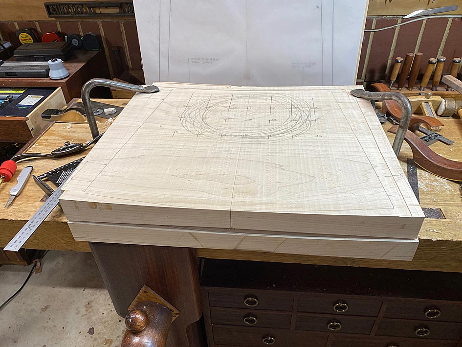

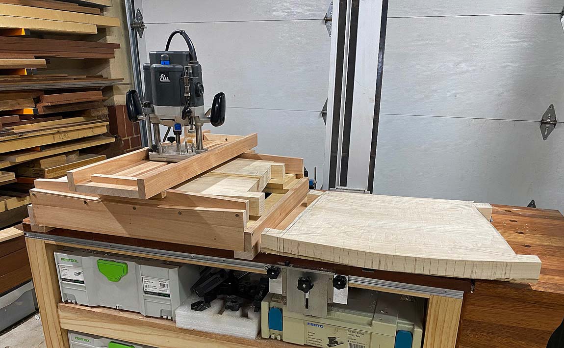

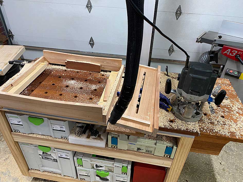

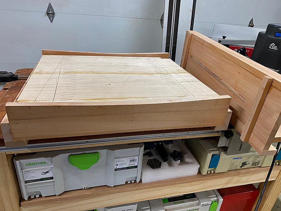

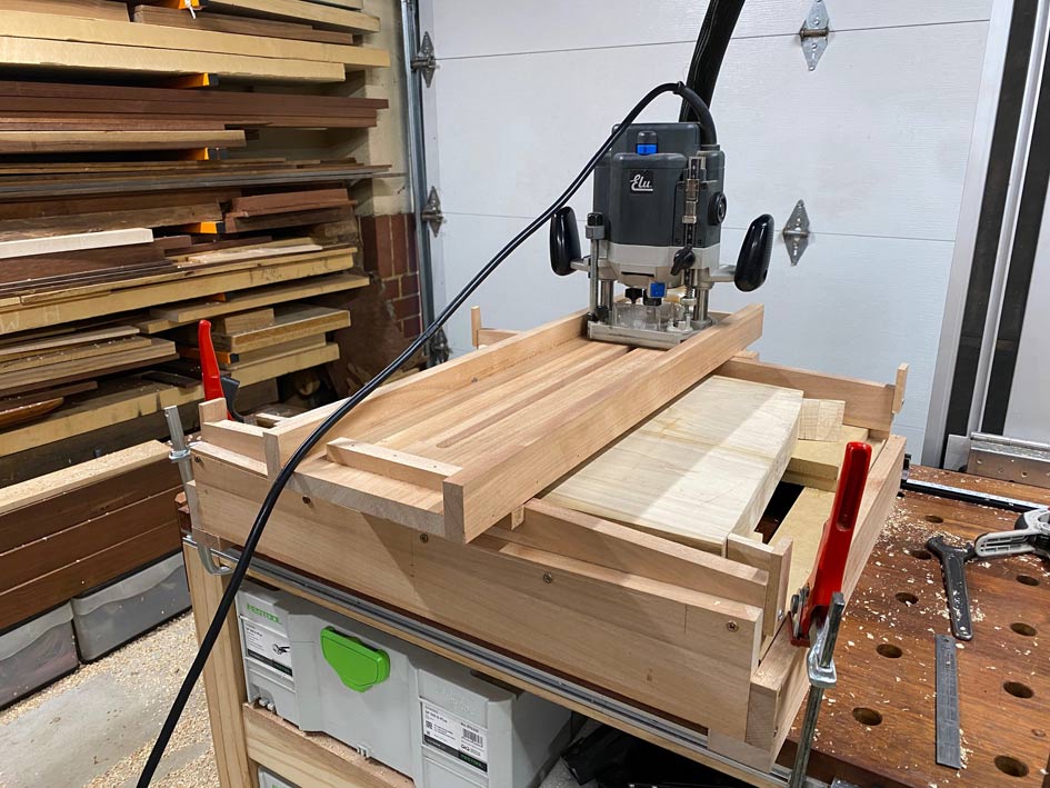

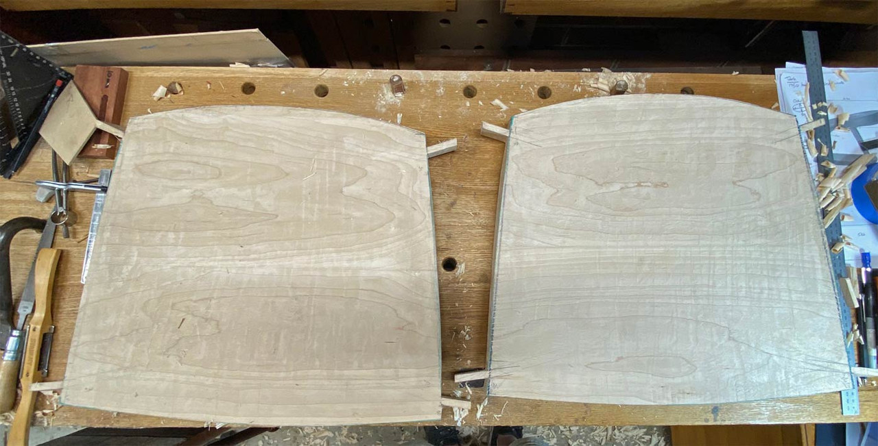

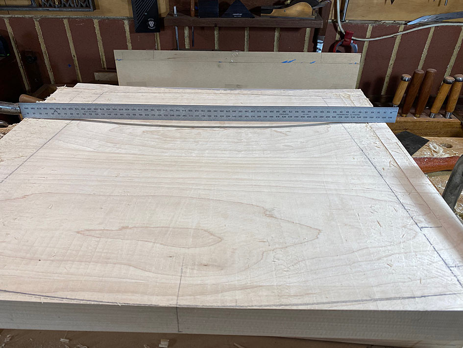

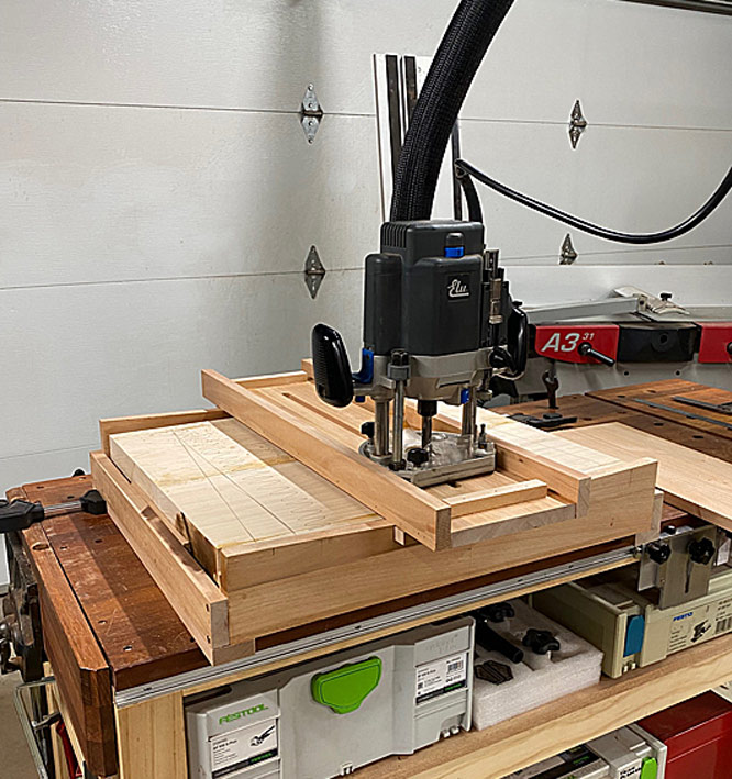

I spent time building a router sled to curve the tops and bottoms of the seats. The tops are documented here.
Today was 37 degrees Celsius (99 degrees Fahrenheit), and it was HOT in the unconditioned workshop, all windows and doors closed to be kind to neighbours. And it was slow going pushing the router back-and-forth. Plus it was messy ..
This was the result of my labours: two boards with the initial curves on their tops. These boards started out at 50mm thick.

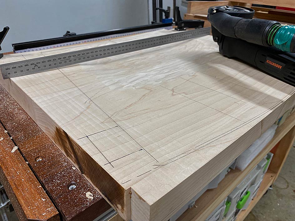

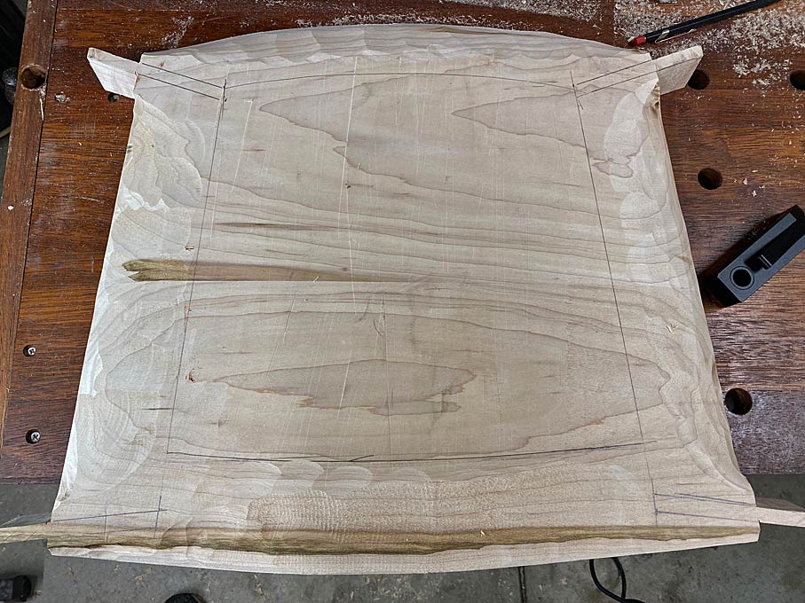

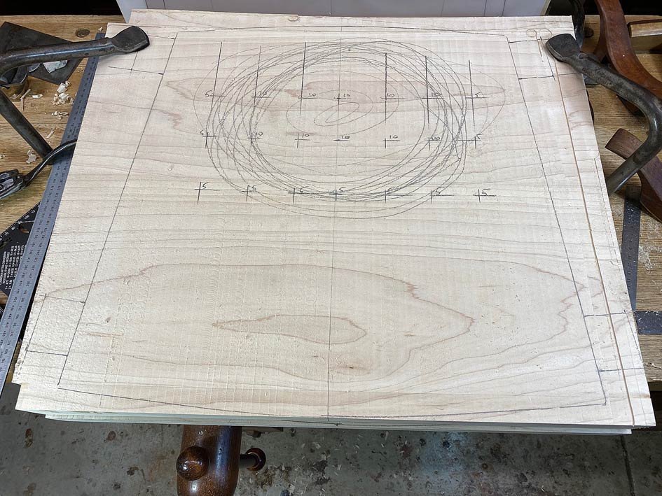

There is a template for the basic shape. This is simply to position the tenons. The outline will be modified later ..
The section for deeper hollowing is marked out, and a grid created to position 10mm holes through the centre and 5mm holes at the sides to guide waste removal ...
A scorp was used to remove the bulk of the waste ...
This was hard work - the Maple is hard stuff - and the next seat will use a different method. That will be revealed in the next post.
Shaping is done with travishers. I have two I built with different radius soles. This is one ..
The result of my labours .... across the width ...
And through the centre ...
Lots of shaping still to be done at the front and underside.

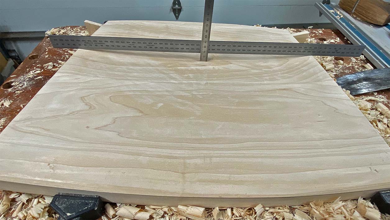

The initial carving of the second seat ... time to learn something from the initial carving of the first seat! Rock Maple is bloody hard stuff. I have used a scorp to quickly carve Pine and Tasmanian Oak. I used a scorp to scoop out the first seat, and it was not fun in 37  degrees Celsius (98 Fahrenheit). Well today it is 39 degrees Celsius (102 Fahrenheit). Time to try something new.
Here is the second seat, which has been curved on the router sled ...

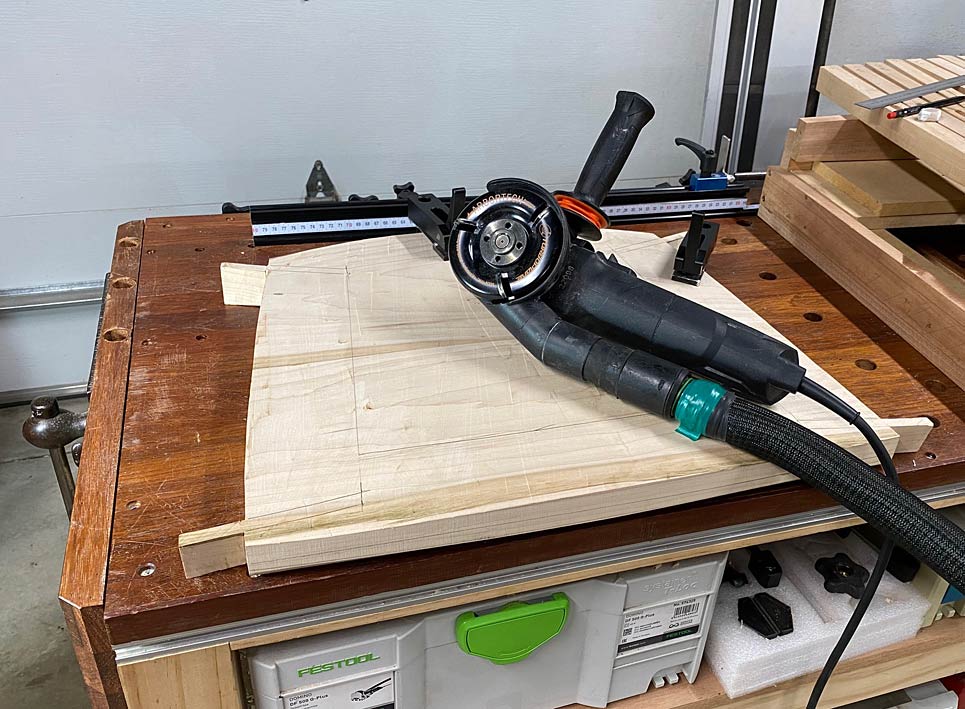

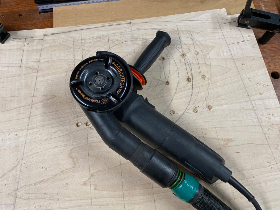

My 74th birthday present (3 days ago) was an Arbortech Turbo Plane kit ..
This can be set up in three ways: it can plane/joint rough boards, it can sand boards, and it can carve ...
It has variable speed, but I found carving is best at the fastest rate. Most importantly, it has some of the best dust control one can imagine. There is barely any chips to be found.
The Turboplane was impressively fast in taking the surface down to the drilled depths ..
It is an angle grinder, and noisy, but less so than a router.

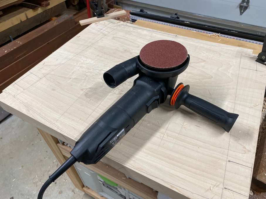

I mentioned that is is a sander as well. I took the opportunity to try this out. 60-grit was rapid, and left a surface as smooth as a baby's bum.

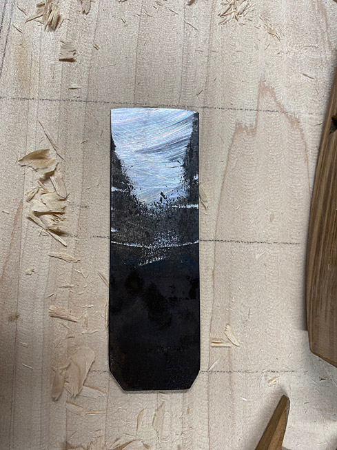

The second new tool used was one I made ... literally in about 10 minutes at this point in time. I had a small coffin smoother, about 4" long, with an open mouth and a single iron. It had been purchased in an "antique" shop for a few Dollars several years ago for the express purpose of turning it into a chairmaker's plane. I admit - I procrastinated ... until today. These are curved front-to-back and side-to-side. It was not much work, and this is what materialised ...
The iron was rusty, and simply flattened on the side of a 180 grit CBN wheel, and then shaped to match the curve of the plane. You can see that the camber is more like a jack plane than a scrub.
How did it work? Brilliantly! Really, after using the travishers, this plane left them in the dust ...

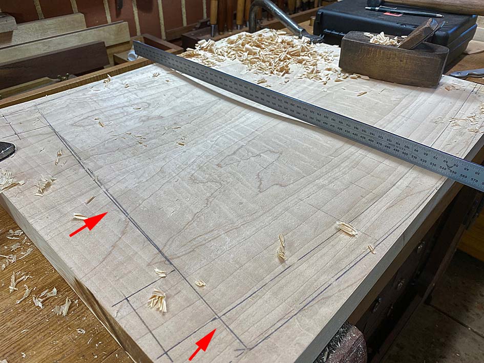

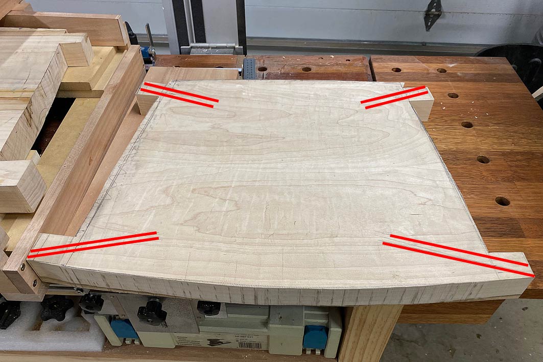

There are a couple of red arrows in this photo. The upper one points to the added curved side lines. The seats were temporarily made with straight sides, but they will have a slight curve (no straight lines on the chairs). The second red line points to where the front of the seat ends. It will be cut off at this line.
The photo below shows the outline of the seat prior to the underside being curved in the router sled. Note the sections left for the tenons, and the red lines here represent the angle these will be (20 degrees at the front and 10 degrees at the rear) ...
Finally, the router sled was converted from convex to concave ...

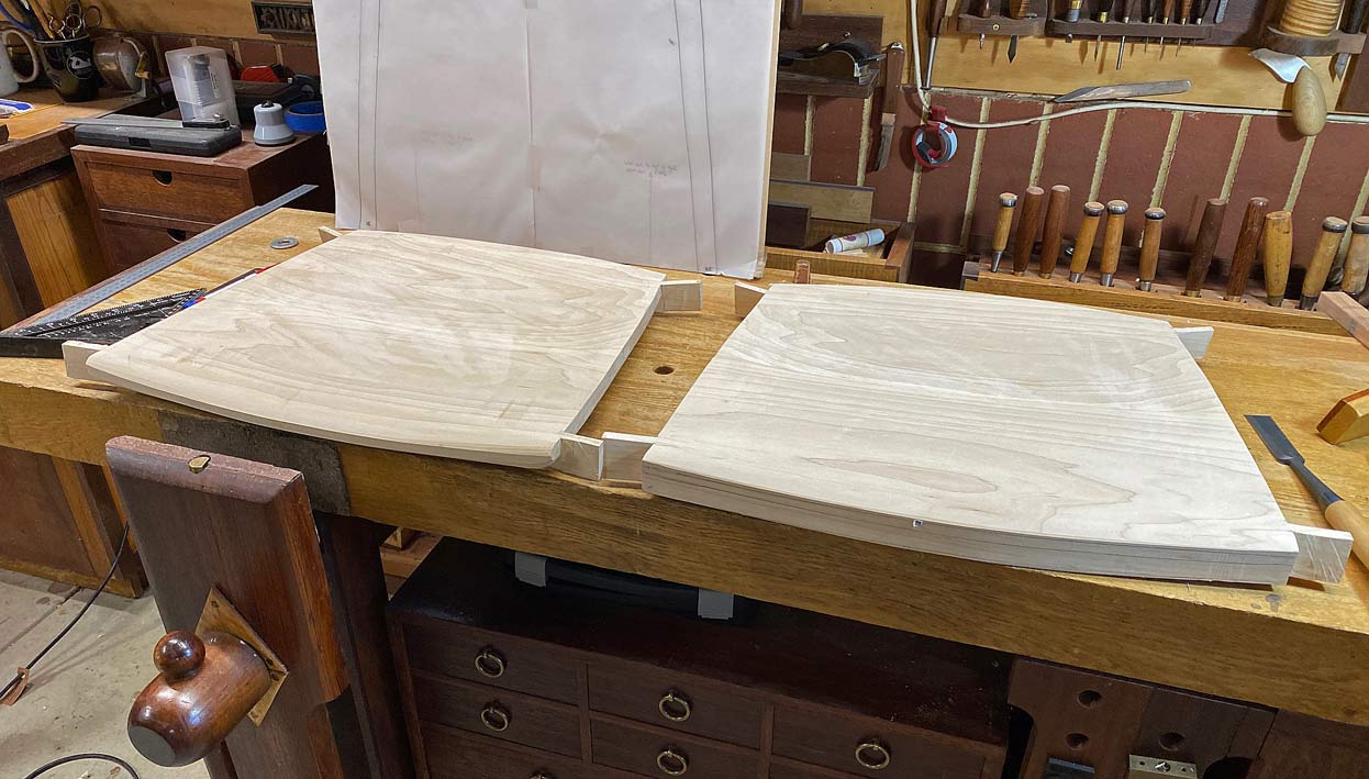

Here is the seat at the end of the last post ...
The underside is flat at this stage (being the reference sides), as are the sections where the tenons will project. But ...

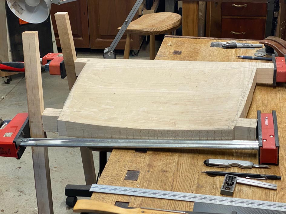

While I am confident about the angle of the tenons, I want to be sure of this, and this requires that the legs be clamped to the ends of the seat at the angle predicted. The legs have been left flat - not yet rounded - as it is easier to add a mortice at this time.
So the next stage is to do just this, but I only have legs for one chair. As a result, work stopped to complete the other four legs. First, a section was cut off one of the 3m long (x 250mm wide x 50mm thick) Rock Maple boards (my wife helped me load this!).

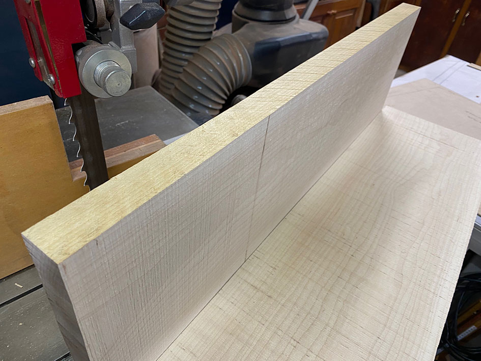

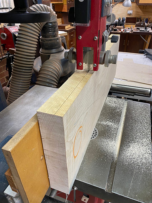

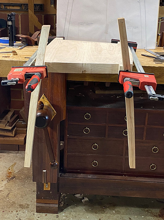

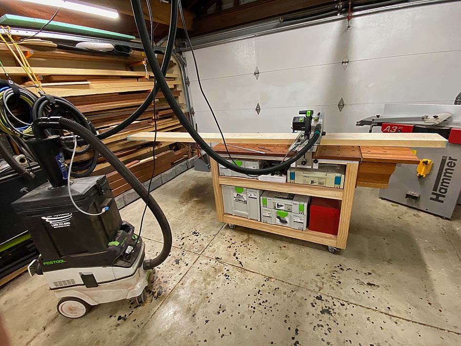

Easier to crosscut on a MFT with a tracksaw than a tablesaw. Mine is a 20 year old Festool I purchased about a year ago in as-new condition.

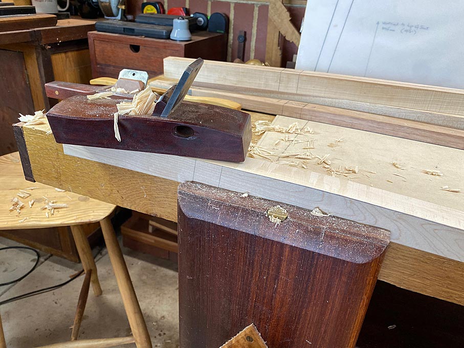

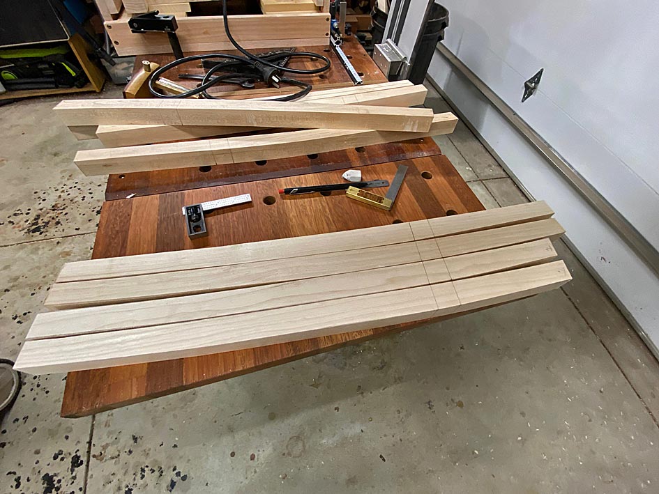

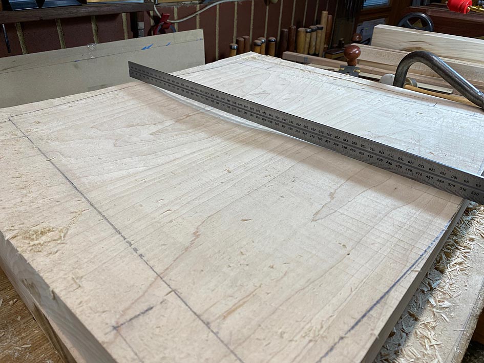

The section was re-sawn to 32mm and then planed to 30mm. Great tracking by the combination of a Hammer N4400 (which I have had for about 15 years) and a 1" Lenox Woodmaster CT  blade ...

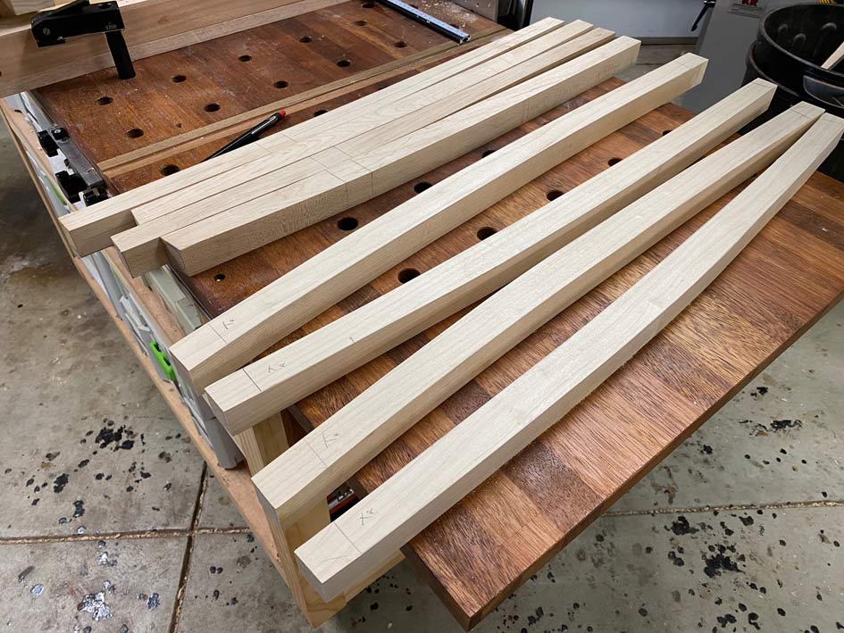

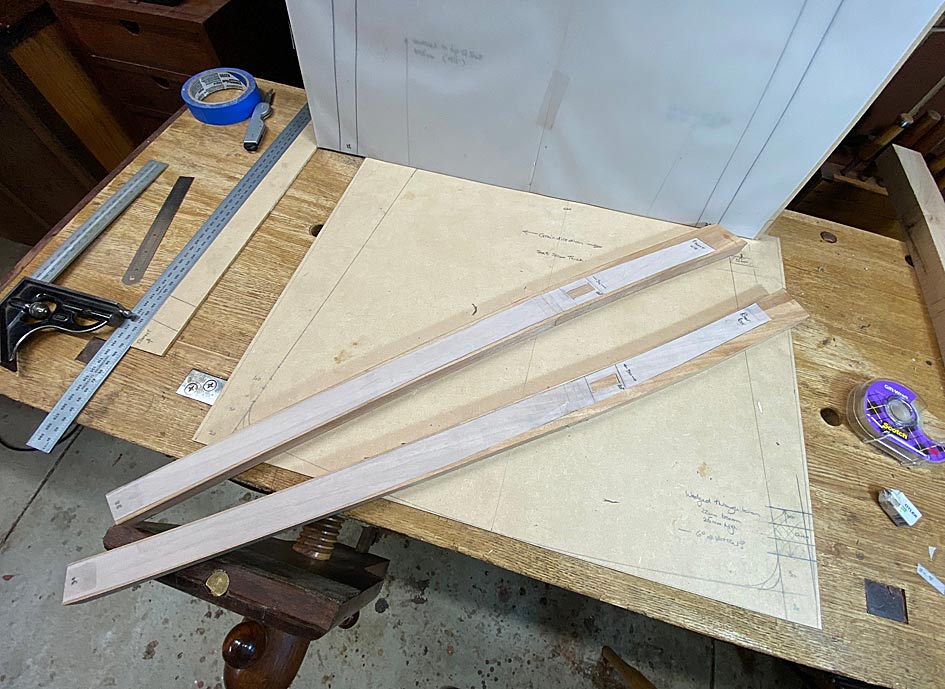

As I mentioned in an earlier post, it is less stressful to mark the legs with a template, bandsaw to the lines, and then use spokeshaves to clean up. Here are some of the spokeshaves I use ...

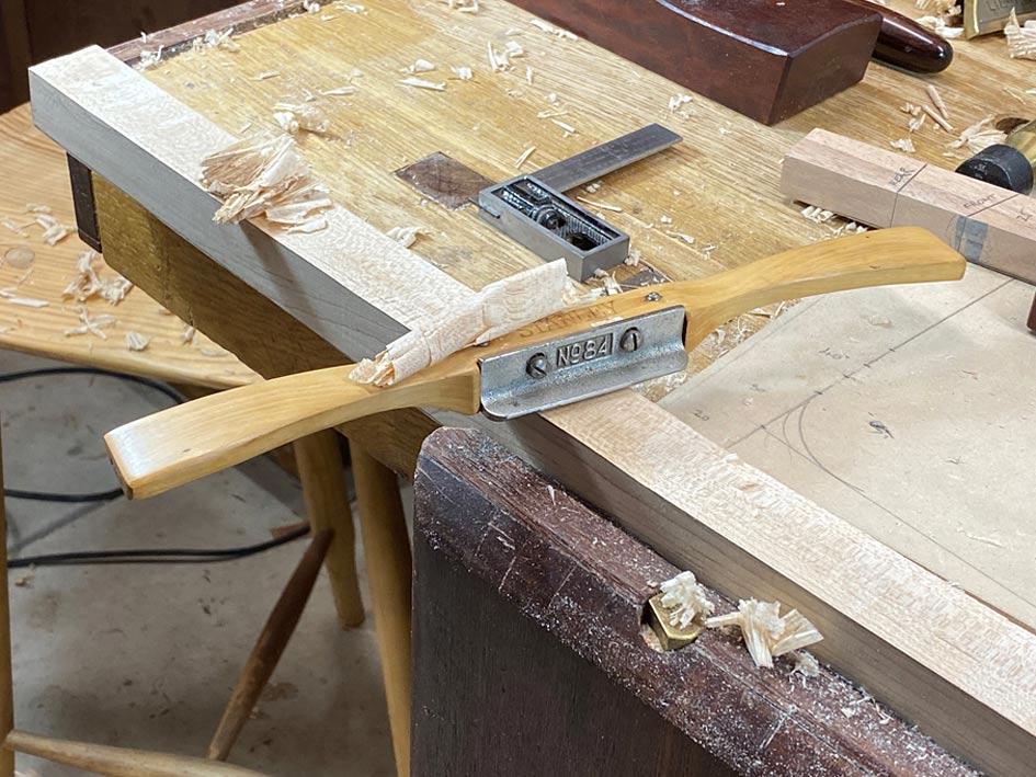

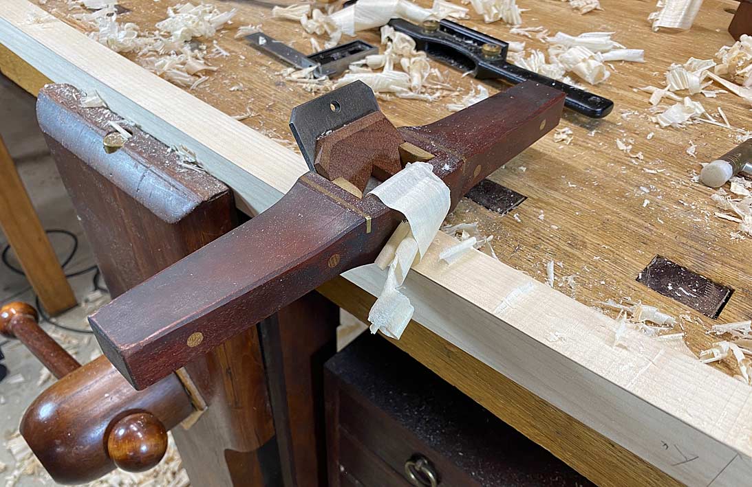

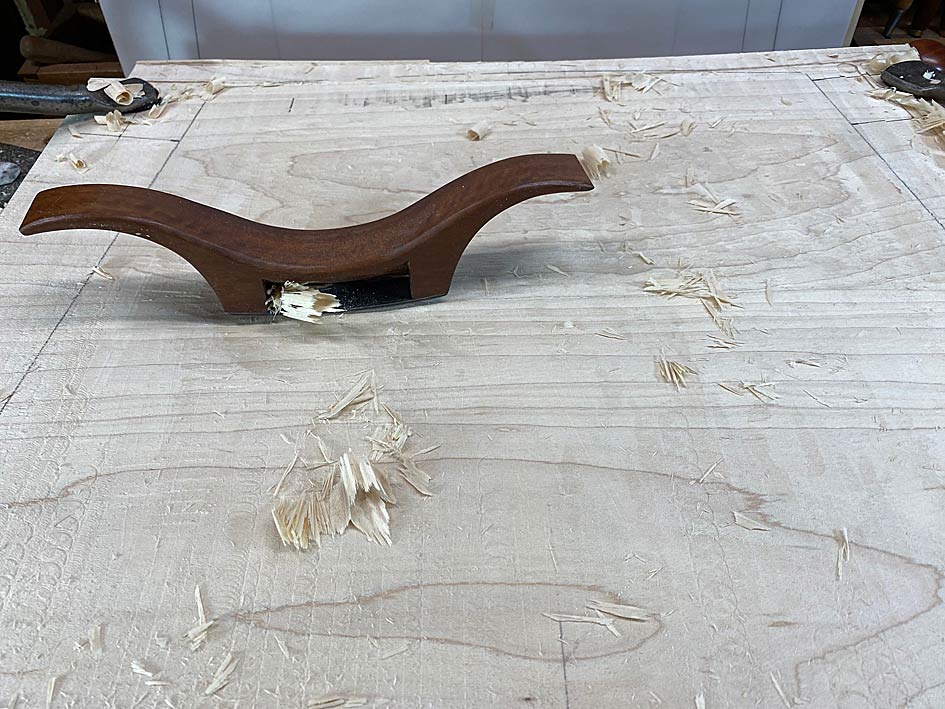

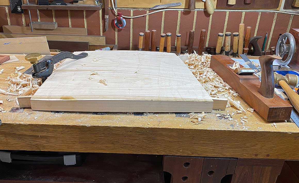

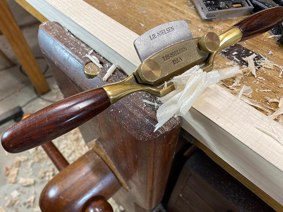

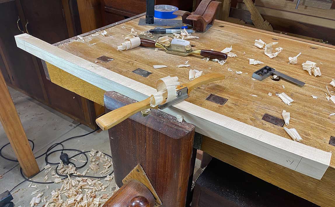

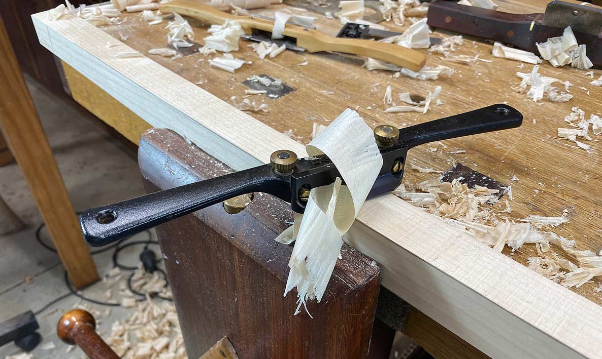

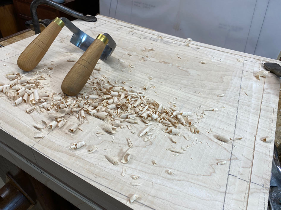

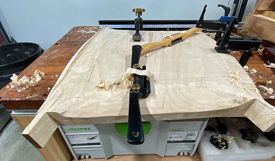

A Stanley #84 boxwood spokeshave excels in taking thick shavings. This is where I begin ...
Veritas make a copy of this in the form of their LA Spokeshave, and it is very good (I use one or the other, not both) ...
Many years ago I was gifted a flat and round spokeshave by Terry Gordon (HNT Gordon tools). It is a Malaysian/Asian design with a high cutting angle. This is my go-to if there is any reversing grain ...
Lastly, the LN Boggs spokeshave takes  very fine shavings and is used like a smoother to finish the surface ...
Here are the completed leg blanks ..
Tomorrow I will mark out the tenons.

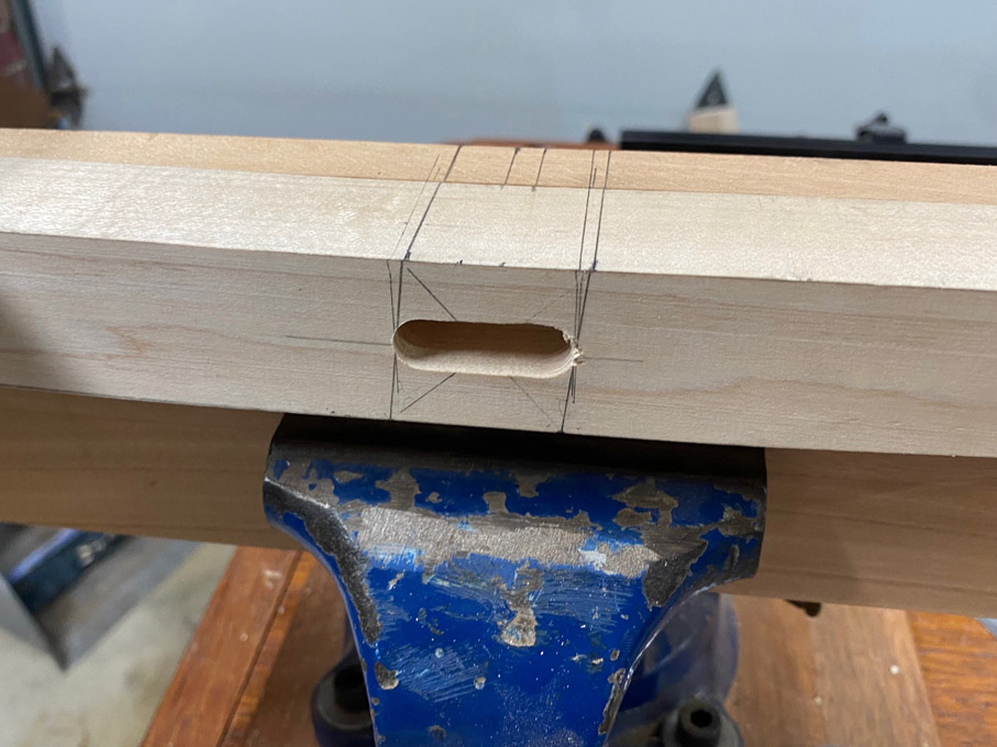

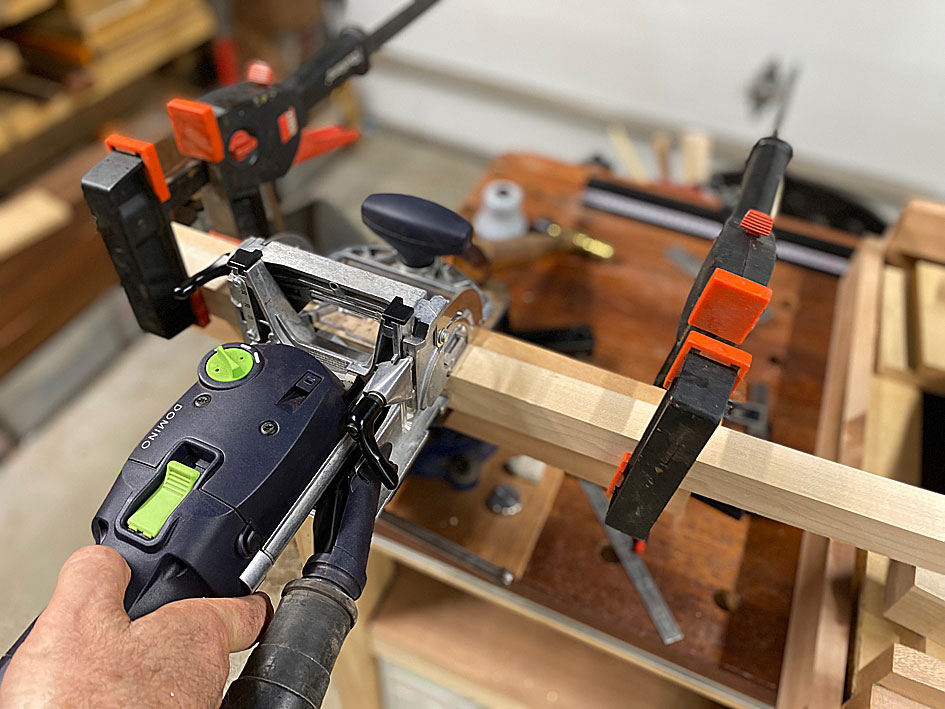

So where are we up to? Well, it is the stage where the through mortices are made. We start with 8 legs ..
The mortices will be made with a Domino ...
Then it gets a little complicated :
1. The legs are curved.
2. The mortices are cut half way from each side, and must be aligned well to meet in the centre.
3. The Domino can cut a maximum of 24mm width. The mortices are 30mm wide (by 10mm).
I have a guide for setting up the Domino to cut a specific size mortice width. This is for a 10mm x 24mm domino. Since the legs curve, the boundary lines for the mortice angle. The boundary lines cannot be dropped down on the vertical, so ...
First set the left side centre indicator ..
.. and then the right side indicator ...
Two plunges of the Domino creates this ..
Repeat on the other side.

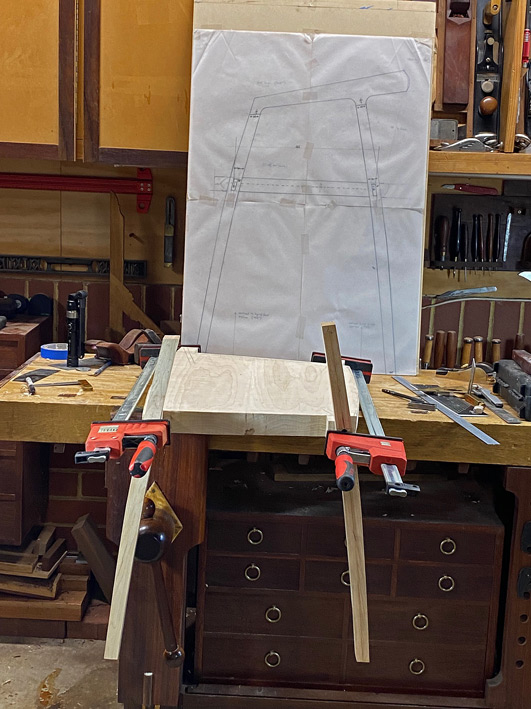

Here is the mock up with the plan/drawing in the background ...
And a close up ..
A last photo for today - taken from the rear. The ears represent the stock for the tenons ...
Tomorrow the tenons will be cut, and then we can get back to shaping the seats.

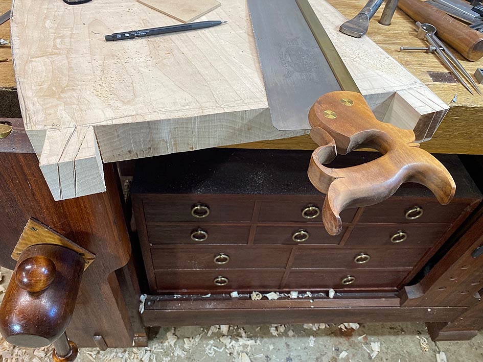

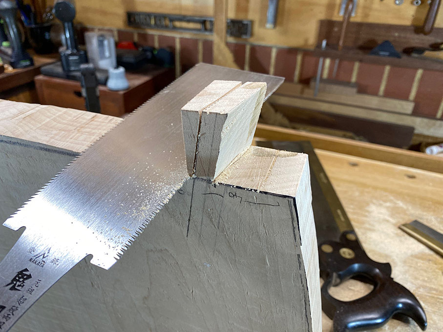

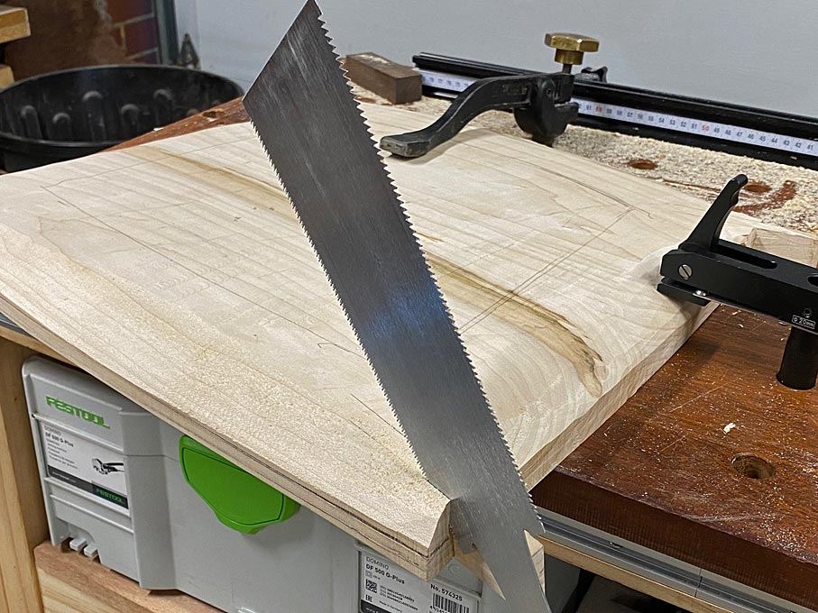

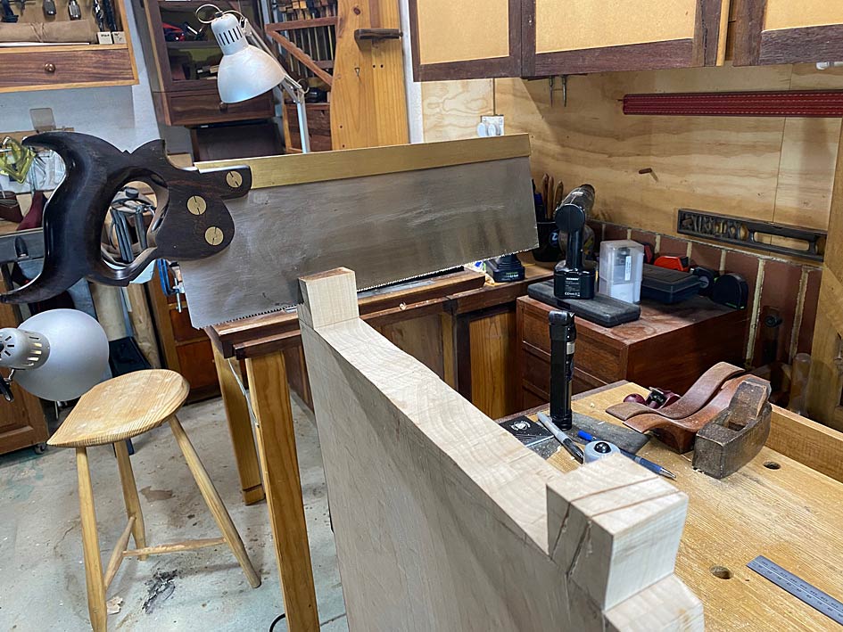

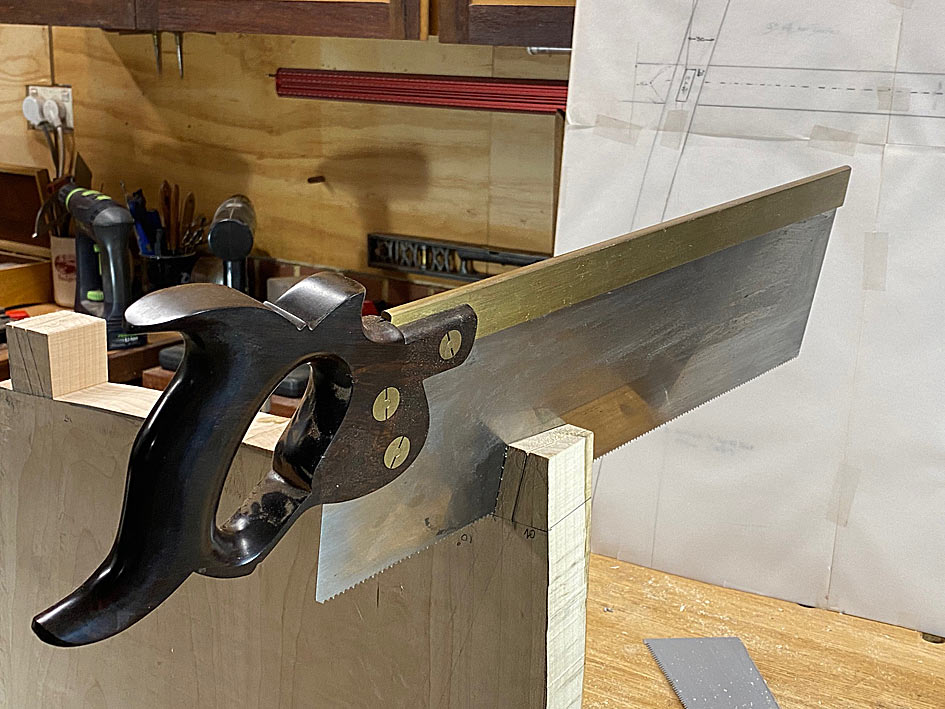

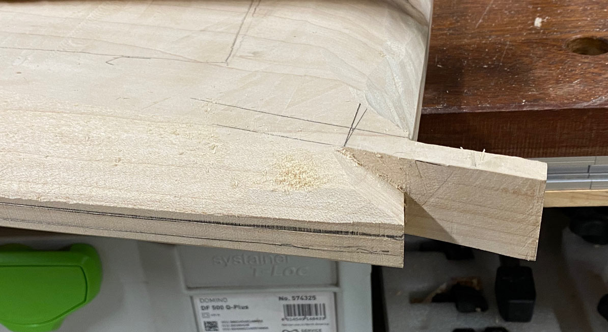

Time to saw the tenons.

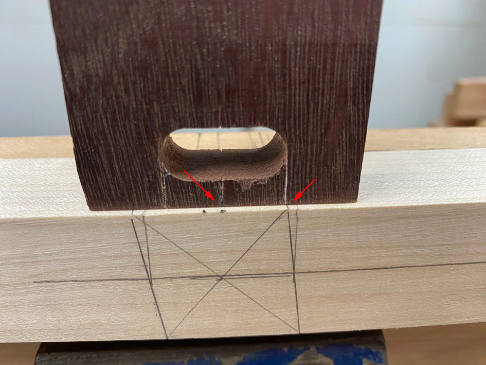

I have gone back-and-forth on doing it this way. I can understand why so many builds use loose tenon joinery. Simply, it is easier to do so than creating integral tenons. It also makes it possible to shape the seat fully separately, especially the perimeter. The seats here have been roughly cut to shape, and only the top partially sculpted. It has been a very round-about way of building ... more steps that could have been avoided.
So why build this way? Well, I want integral tenons as they will be stronger than loose tenons. It is also difficult to rout the mortices in the edge of the seat owing to the awkward angles involved. Lastly, adding mortices may not be possible owing to the reduced depth of the sculpting.

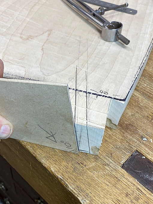

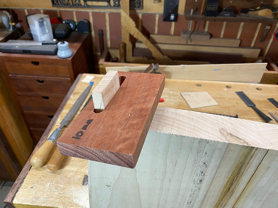

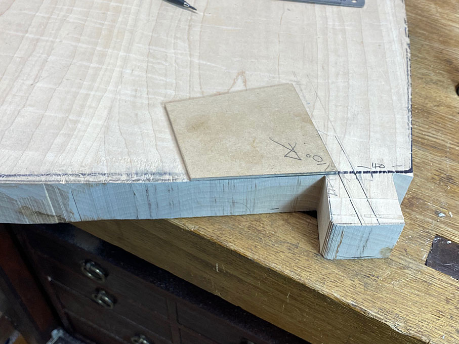

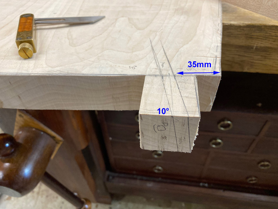

The tenons are not straight-forward as they angle inward at 10 degrees, creating compound angles, as will be seen shortly ...

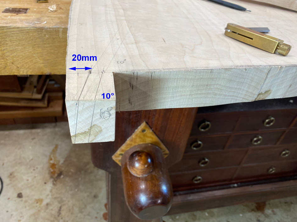

Using a template for 10 degrees, the angles for the tenons were plotted on the ears ..
Dividers are used to mark the 10mm width ..
There is also a 10 degree splay angle to add ...
At this stage my spatial-ability challenge came to the fore and I was in over-load with angles. Marking out the angles on the reverse side gave me the biggest headache, and I came so close to accepting loose tenon joinery!

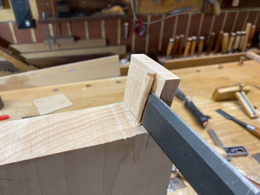

I decided that loose tenon was always a backup, and so just go for it. The saw used is a 16" Wenzloff & Sons tenon saw (10 tpi rip). It is a HUGE saw, but worked really well here with its aggressive cut.
Cutting to the line, which left just a smidgeon of waste.
Waste removed with a Ryoba ...
All tenons cut ...
I checked several and all were on the money at 10 degrees. I'm a happy camper ...
Eight tenons and eight mortices ...

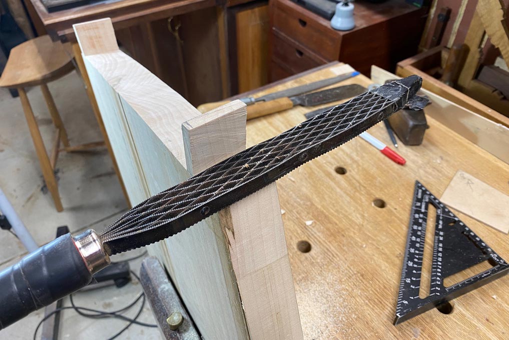

Next on the agenda: rasp the perimeter to shape, finish the tenons while there is still a flat reference (under) side, and then shape the underside of the seat.

The tenons were now sized to correct width ...
... pared ...
.. and rasped to width ..
I made a template to ensure each would later be a tight fit ...

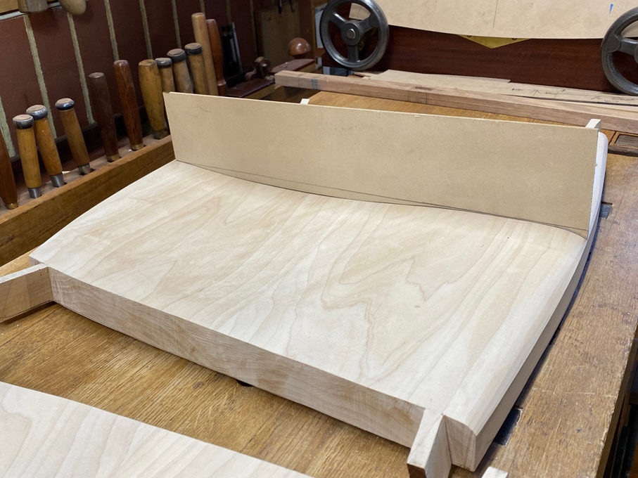

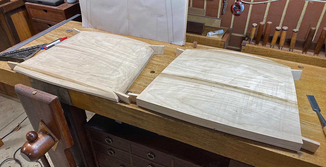

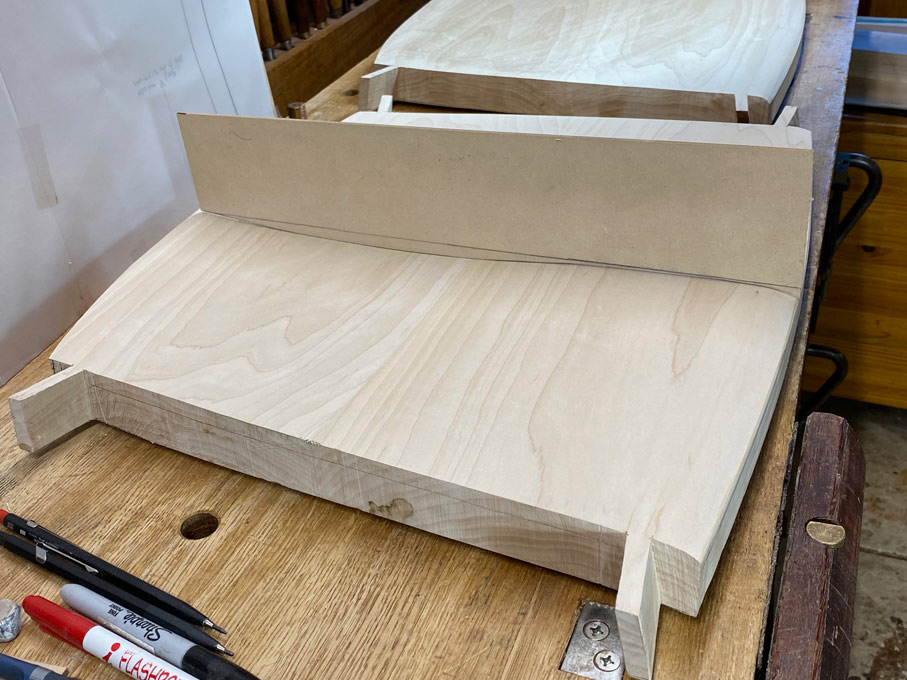

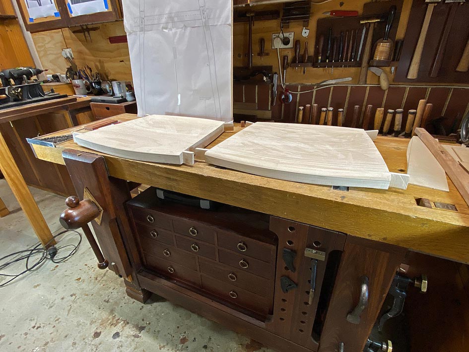

So now we have two chair blanks with a semi-shaped outline, a profiled upper side and four sized tenons ...

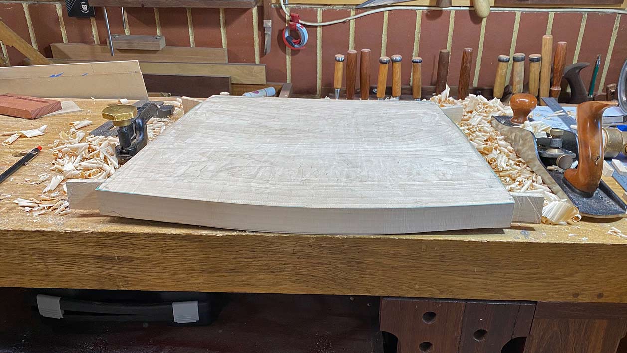

Now it was back into the router sled to shape the underside, which was to curve in parallel to the upper side ...
The result was two of these, after some cleaning up with a jack plane ...

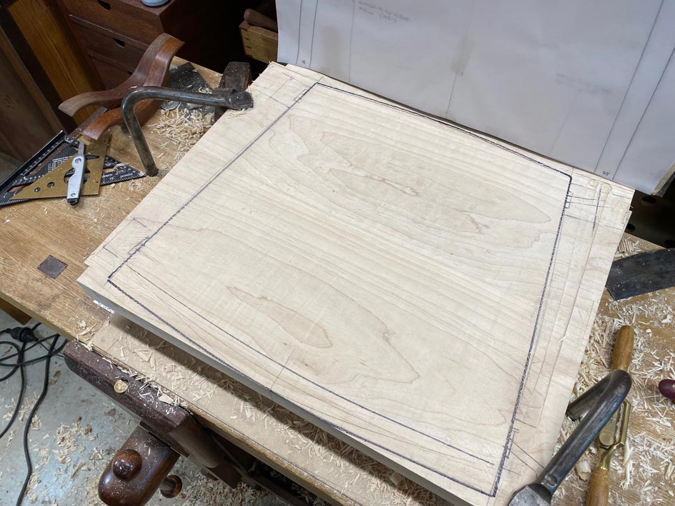

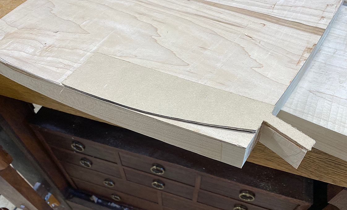

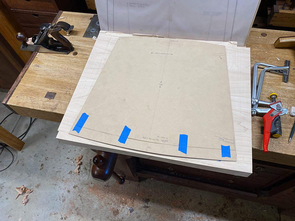

Time to give the seats their final plan shape. The seats were flipped over ..
And a template used to mark the new rear curve ..
One of the problems photographing this Rock Maple is that the light colour does not show details particularly well. Especially the seat hollows and internal curves. In addition to the upper curve, the seat is hollowed out to a depth of 18mm.
Nothing to see here. But ... from the sides ... one then the other ...
Note that the carved seat adds a 4 degree slope to the seat, which is what is in the design (however the original drawings missed it coming from carving seat, and adjustments had to be made).
We are closing in on the last lap for the seats - well, next to last lap (it seems to go on forever!). The undersides need to be shaped to remove the bulk (which was needed for the tenons), and create a sleeker presentation. Back to the Arbortech carver to remove the waste ...
I frankly do not know how many hours this saved if I had been using hand tools. I did try a razor sharp drawknife, and the Rock Maple laughed at it. The Arbortech is terrific. It does take a little while to get the feel for gentle carving, as it can run away from you if you carve with a climb cut.
Spokeshaves next, and the Veritas LA does a magic job ...
To get the best out of this spokeshave (since many described it "diving" into the wood), it is important to understand that the toe is curved 4 degrees from the mouth (as is the Stanley). Think of this in the same way one uses a travisher, which has a similar toe: The angled mouth acts to open or close the mouth. Set the blade and then adjust the depth of cut when using the body - toe down and it cuts a fine shaving, pressure on heel and the shaving is thicker. I suspect that "diving" occurs when the shaving is thicker, and attention is not given to grain direction.
The tenons are at the centre of the design. The seats started out at 50mm thick. They are down to 35mm at the centre, and will end up about 15mm thick at the surrounds. However the tenons must end up 30mm high.
Here the tenons are being "extended" from the seat, with two saw cuts ...
The spokeshaving of the first seat is done, and alongside an unfinished seat for comparison ...
Working on the second seat at the close of the day ...
