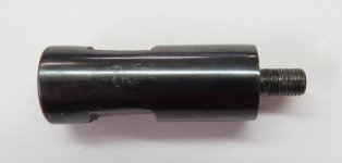

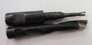

I used to have a Domino 500, but sold it when I purchased my XL.  I kept the bits and made this adapter for the 500 bits.  Pretty much like the Seneca adapter, but much cheaper as the tap and die were less than $20 delivered from Amazon.  A bit of time on the metal lathe, some file work for the wrench flats, a bit of polish and gun blue....    Works fine.  I used 5/8" cold rolled steel as a blank.

No, I didn't think that any hardening was necessary and so far so good.  Cold rolled steel is reasonably tough stuff.
