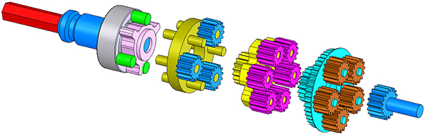

As was mentioned, there is no center position lockout. What seems like a lockout feature is actually just a tab on the forward/reverse button to prevent you from changing direction while the trigger is being pulled. It's been too many years since I played with the controller, so I can't remember what happens when the controller senses the change in direction while the motor is in motion. Either it ignores it, or it error's out and shuts down.
Secondly, there is no forward/reverse switch. There is a hall effect sensor embedded inside the controller and the button simply moves a tiny magnet toward or away from this sensor. The button is the green piece sitting by itself in the center of the picture below.

The clunking sound is most likely just the shaft locking pins (green pieces in the image below) moving into and out of the locked position. These three pins lock the output shaft for changing bits. They also prevent the motor from being manually turned by the chuck, which would result in it becoming a generator and backfeeding an electrical signal into the controller's output transistors. There is no perceptible lash in the geartrain. It is a 3-stage planetary set, and you could never notice the lash of any single gear.
The clunking sound is normal with the T15, it's the electronic brake kicking in. Probably those green pins Rick mentions above.

This is due to the inertia of the relatively heavy jacobs chuck. (Technically it is not a jacob's chuck, but only my father would lecture me on that point.  [tongue])
Due to inertia, at start-up, the rest of the gear train will rotate a small portion of a revolution before the locking pins are driven to their free position. At shut down, the reverse happens, as the pins get shifted to their locked position.
It is complicated to explain, but the light pink, 3-lobe piece is only loosely coupled to the 6-pin hub to its right. The two of them will have a 1/12 (revolution) lash angle, which is what cases the green pins to either be in their locked or unlocked positions. The top green pin is in the unlocked position, and the bottom green pin is in its locked position. In their locked position, they jam against the outer casing of the gearbox.
