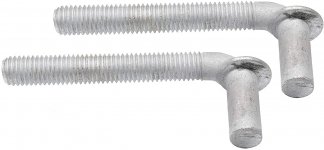

For the sun deck floating in-fill panels I installed, I just fabricated my own fasteners. I took some 1/4-20 threaded stainless rod and put a 90° bend in the end to form it into a "L". Then I took a stainless flat washer and tack welded it to the short end. So the short "L" end with the welded washer is installed in the in-fill panel and secured with another flat washer and an acorn nut. While the long end of the bolt is installed and secured into the railing post. This allowed about a 3"-4" gap around the entire panel that permitted air flow in the summer across the deck. With no airflow on a hot day the deck can become unusable.
To remove a panel just remove the 4 acorn nuts, make sure the panels are numbered and the up orientation is marked to make reinstallation simple when several panels are removed.
This is what the bolt looked like except it obviously had threads on both ends.
