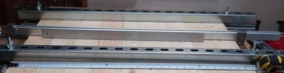

For edge jointing on long flat boards, 6" to 10" are fine, but less spacing or more dominoes may be needed if there're more high/low spots to cover. Edge jointing in fact can be done without any dominoes or dowels or biscuits if the mating pieces are properly prepared. I use just glue and cauls (wooden or steel) for straightforward panel glue-ups.
