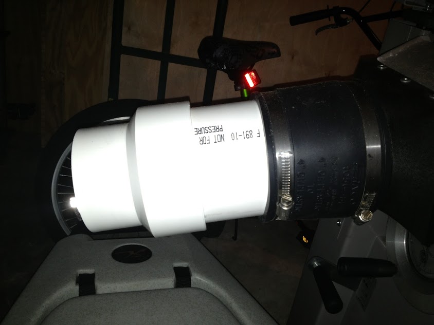

Matt, I did much the same thing as several of the other folks indicated. Rubber flex fitting with two hose clamps and PVC pipe to reducer fitting. My DC host slips right over the PVC reducer, and is tight enough that I don't have to clamp it.
In my case, I left the PVC pipe a little too long and intend to cut it a down a bit, but other than that it works great.
