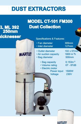

Martlet FM300 (3,000).
Martlet

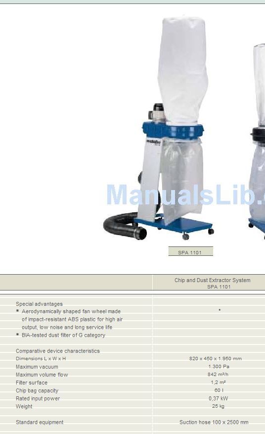

Metabo SPA 1101 (4,000)
Metabo

The specs seem to vary widely between air volume moved (from 183 to 1800) and pressure (from 1300Pa to 2500Pa).
Hence the confusion.

Martlet seems to be the sweetspot in terms of spec and price. But don't like it. No idea why.
Metabo looks nice. And I like it. No idea why.
