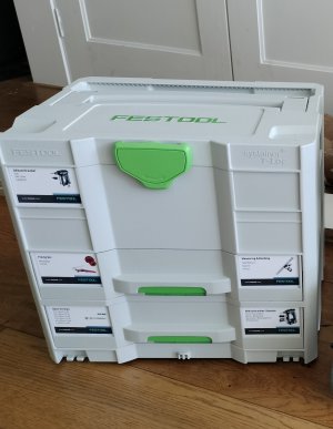

I'll try to touch on many of the points described here with an example of what I use to label Systainers.
The white, printable PVC cards that fit the Systainers are nominally 86mm x 54mm. The matte Festool label covers, 497855, are labeled as 85mm x 55mm, yet when measured with a dial caliper they are actually 86mm x 54mm go figure? 😵‍💫
I use Bodno white PVC cards purchased on Amazon. Photo 1

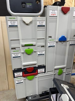

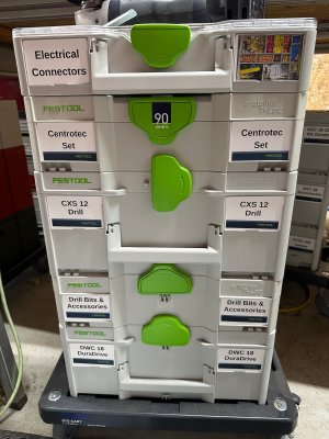

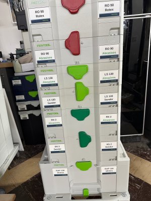

I use Online Labels OL5030WJ white, matte, weather proof labels for an inkjet printer. https://www.onlinelabels.com/templates/blank/ol5030

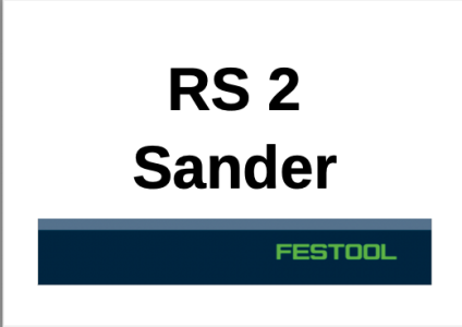

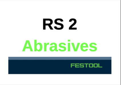

Online Labels offer 6 different templates to aid in designing the labels. I prefer to use Maestro Label Designer.

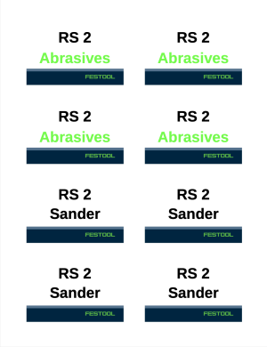

Each label is designed separately and can then be added to the template for printing. I'll usually print 8 labels (1 sheet) at a time. Each label is scored on 4 sides for easy removal. Photos 2 - 4.

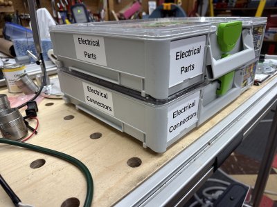

Finished result photo 5
These labels can be removed in 1-piece from the PVC card or from the Systainer. If any adhesive remains, it can be removed with a quick wipe of Goo Gone on a paper towel.

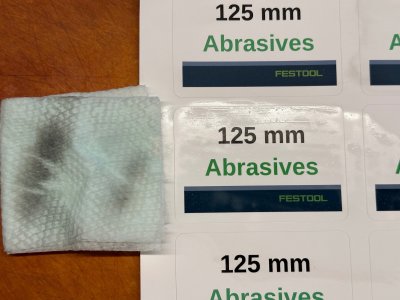

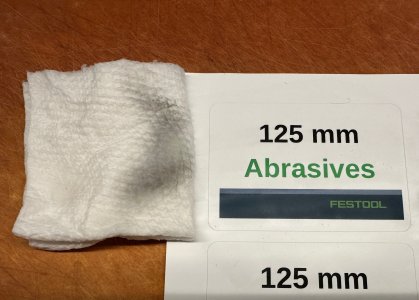

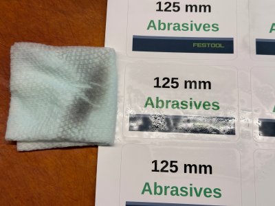

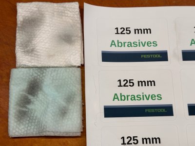

I found an extra couple of labels this morning so I thoroughly wetted a piece of paper towel with some water and scrubbed across the surface 50 times, photo 1 is the result.
I then rotated the paper towel 180º and scrubbed across the surface of the same label an additional 50 times and photo 2 is the result.

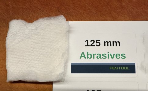

Photo 3 just shows the wet paper towel and the label before scrubbing.
I may try this again using Windex with ammonia and see what happens.

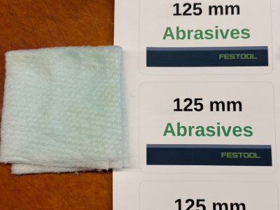

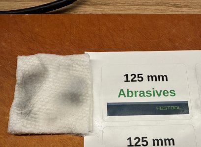

For the doubters out there, tonight I tried the same test on the weather proof labels with Windex + ammonia.
1. Paper towel soaked in Windex + ammonia as a control
2. Windex soaked paper towel after 50 cleaning strokes
3. Windex soaked paper towel rotated 180º and then used for an additional 50 cleaning strokes
4. Comparison between the H₂O soaked paper towel and the Windex soaked paper towel. They appear to be for all practical purposes the same, with the interesting thing being the first 50 passes seems to remove more ink material from the label while the last 50 passes removes less material in both cases.

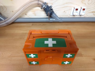

I promised to look up what labels I use for my laser printer.
They are Avery L7911

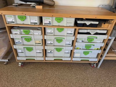

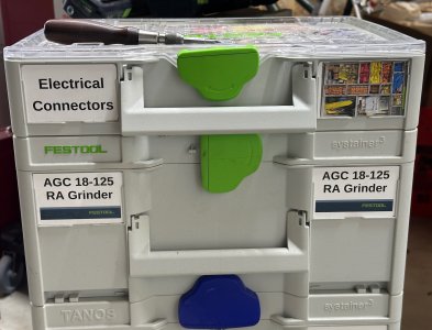

Here's a photo of my first aid kit with these labels on them. I estimate they must be at least 7 years in use now. I admit they are not exposed to heavy wear and tear, but there is no fading or peeling at all. I am quite satisfied with them.
