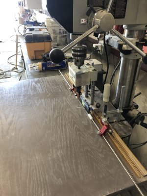

I highly recommend the CMT drilling fixture over any other “jig” on the market.
Only unit I’ve used that is better is the Blum Mini Press.
Ive used the Blum Eco drill for 25 years for onsite drilling. Just yesterday I rec'd the new version which has dust extraction. Game changing.
This is a problem that I have yet to deal with. For the last 20+ years I have had commercial grade hinge boring and pressing machines. It goes back to when we had a separate one for Grass hinges, since they used to have a different offset for the screws. It was a 5 second procedure.
I haven't had the need in the last month or so, but my kitchen job is on the horizon. I'll have to figure out something, though I suppose a fence and some stops, on the drill press would work.
The reason I recommend the CMT unit of the others is drill press use. It is a single spindle unit so it works in a drill press. It can be used as a stand alone with a hand drill also.

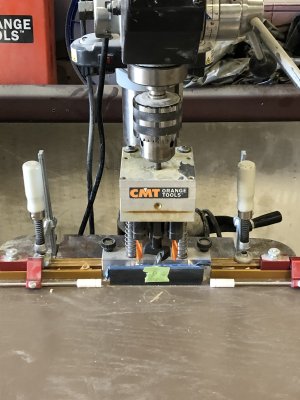

My Kreg jig has setting for different offsets (tabs) from the edge of the door. How does the CMT jig handle offsets?
The boring distance (what you’re referring to as tabs) is set by moving the back stop (the part with the green tape on it in the original picture I posted) in or out. You’ll see it removed in the picture below.

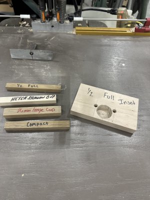

We made spacers to set the distance for the most common hinges we use. There are set up blocks that go on the bits in the head so we can set the left and right stops. We also have a spacer to drill the 3/4 hole diameter for bi-fold doors most commonly used on corner cabinets with lazy susan’s in them. This spacer is 1/4” thick so the 35mm bit clears it height wise. It is currently set up for inset applications.
There is an adjustable depth stop rod behind the 35mm bit.
The one spacer reads Hetch shallow cup, that cup hole is drilled 7.8mm if I remember correctly. It is the only hinge on the market currently with a cup that will work on a 1/2” thick panel with soft close.
