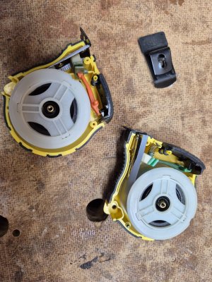

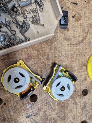

The fast retraction happens to other tapes of mine, including the Lee Valley ones. But my problem with one of the Fastcap rules is that the lock failed, meaning it won't hold the tape in any desired position. I'll see if I can unscrew and fix it.

After taking apart the defective tape I mentioned in my last post (the left one in the photos), I found that a spring was missing and went ahead and fixed it.
