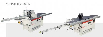

I have been looking at SCM SM as well, one of their offering for tenonning accessories got me interested:
it seems to me this type of sliding table is more versatile than the traditional sliding table like the one on Felder? you can put the machine against a wall, the operating space of this type of spindle moulder is of a rectangular shape rather than a square shape as you do your tenonning and shaping. I really like this feature because of my space limitation.
The equivalent SCM Spindle moulder(if we simplify it and only talk in terms of weight) cost $3000 USD more than the F900z.....
