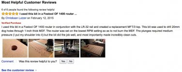

Here's a pic of a review on Amazon for the 491072.  Specifically addresses your application! [big grin]

I've made multiple tops with mine...at least 600 holes...fantastic system!

I used an LR32 system, with Festool 491072, Incra T tracks, and Rip Dogs stops and guides.  I made 96mm and 192mm gauge blocks for spacing.
