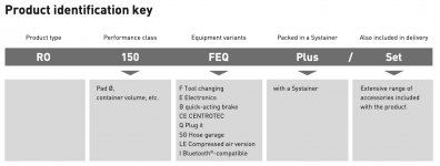

The individual parts of the Festool product codes have a specific meaning.
In the UK for example the TS55 EBQ Plus FS GB saw breaks down as follows;
TS = Plunge Saw
55 = Depth of cut (in mm)
E = Electronics (variable speed plus soft start)
B = Brake
Q = Plug it removable mains cable system
Plus = Comes in a Systainer case
FS = Comes with a Guide Rail
GB = GB spec with UK 3 pin plug
I would assume the same applies in the States so a RO 150 FEQ-PLUS would be
RO - Rotary and Orbital motion (Rotex)
150 - 150mm diameter sanding disc
F = Think this is the Fast fix removable sanding pad system
EQ = Electronics (variable speed plus soft start) and Plug it mains cable
