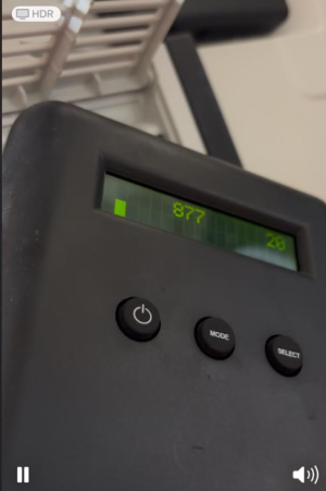

Hi Everyone,
I just bought a Festool CT 25 (my first festool) to replace an old Ridgid (Black Friday Special) with a Hepa filter. I have a dylos pro particle tester and wanted to see if having a full unit HEPA certification made a difference on the particles coming out of the unit.
The Ridgid did better. What am I missing? I'm going to reach out to festool support.
Brand New Festool CT 25 Extractor:
Held at exhaust with CT 25 suction setting on Low (Also tried high).
Particle Count goes Up > 800 (.5-micron particles)

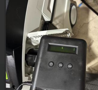

Update: I placed the diffuser from the Ridgid into the CT 25 exhaust and the reading went way down.

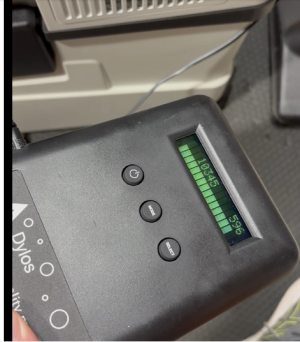

Update 2:
The particle counts coming out of the air intake/exchange port on the left of the unit are > 10,000. This is expelling something. Could be motor particulates or oil particulates from the motor itself.

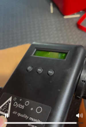

Ridgid Shop Vac with Aftermarket HEPA Filter (Non sealed unit):
Held at Ridgid Exhaust Port
Particle Count goes down (with and without shop vac exhaust diffuser).
< 5 (.5 micron particles)

Additionally, I just ran my air filters in my closed garage until the particle count was near zero. I turned on the CT 25 and held the Dylos unit close to the exhaust and the particle count went up to over 1000 (this does not occur with the Ridgid). It looks like there is some sound proofing material down in the blower port. I'm wondering if that's what is blowing out.

I placed the dylos intake into the exhaust from the blower port on the Festool. If you're looking at the front of the CT 25, it's on the right side. There is a little latch that opens so you can plug a hose into this port to function as a blower. Isn't this filtered air? I just updated my original post. I placed the diffuser from the Ridgid into the blower port of the Festool and took another reading. The .5 micron count went down to 4.
