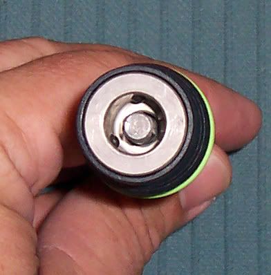

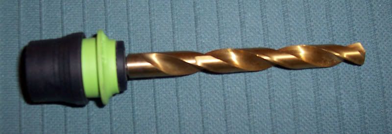

No matter how much I'd like to get everything festool my pay doesn't allow me to, so I adapted a $20 Kobalt 1/4" hex shank drill bit set to work in the Centronic adapter.  I may do this with other types of bits to make my own set that will work with my CXS.
Thanks goes to Paul Marcel and his blog to show me that something like this could be done.

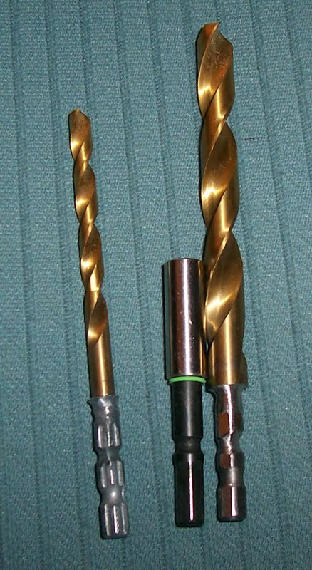

I used the Festool bit holder to mark the location of the new indention.  I used a grinder to cut a small indention into the bit slowly spinning and dipping in water to cool the bit down.  after the grinder I put into the drillpress upside down and used a round file to finish cutting the indention to it's semi round shape.  The bit on the left at the top of the shank was left like a cone to act as a stop.  If I removed the cone when I insert it into the Centrotec chuck it can easily fall through the chuck.  The sharp edges on the shank were relieved using a file, otherwise it would not fit in the chuck.  Just thinking about it at the time only the bottom of the shank needs to retain most of it's hex shape to engage the drill, the rest just floats in the chuck.
On the drill bits that were larger than 1/4" I had to grind the bottom step of the bit down to 1/4" so the bit will seat fully into the Centrotec chuck.  I know it's not pretty, but it's effective.
Now the bits sit low enough to fully seat into my CXS and hold securely in the Cetrotec chuck.
