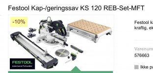

I believe that Cheese is referring to MFT Kapex. It is a very nice, compact and easy to move MFT in a smaller compact form. It is as mentioned lower than all other MFT tables to accommodate the Kapex 120/88/60 to remain the same height on the saws base towards accessories like wings, MFT/3, MW1000 and so forth. I have one myself, but not used with my Kapex yet as it for me doubles as a table I can easily set up outside for other work that makes a lot of dust or needing freedom of movement. You will have a very stable table for the saw, and you get a versatile work table for other use.
As it seems, Festool is now soon (April) offering this as a kit over here with the UG wings instead of the old crown stops and KA-KS wings:
