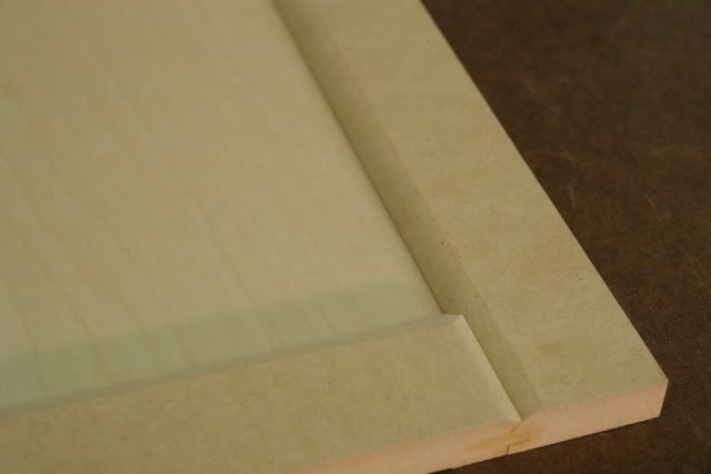

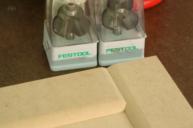

While looking for something a little different when it comes to style and rail bits I came across Festool's unique set 491129 & 491130. This will be for an upcomming bathroom vanity / cabinet door project. I have made a sample door (mdf and ply) using this set.  The actual project wood is to be be teak with teak ply panels. So far I like the look and I would like to know if anyone has used this set or has seen a finished project with this profile ? Or if you have an opinion on the look ?
Bits have 8mm shank and door was made on a jessem router table using an 8mm collet bushing adapter.

Woodenfish , yep thats what I was looking for. Something other than the same old profile or the usual variations of it. Cove, Ogee, ect. I think I may have seen this profile used in "solid surface" material. festool's info shows a solid "wood" sample of the cope and stick individually, but not connected. I took a chance and ordered the set "kinda" knowing what the profile would look like. As far as the maximum thickness - I can't find it now  :-\ but on some link on some site it was listed. It is closer to 1" or 7/8 of course in mm , IIRC. It is a tad thicker than their other Ogee set.

   In my photo it shows a "line or transition" between the radius and the flat section. That dissapears with a light once over with sand paper. And gives a more smooth or soft look. And as far as a raised panel goes  ::) , I'm thinking flat or glass here because I don't see how any raised profile would work. Festool's panel cutter belongs with the other set.

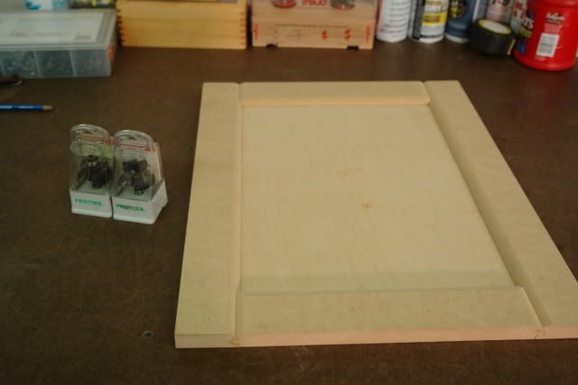

Well Doug this project has been delayed but it is still a go. Still a month out. I like the sample door I made and will be using them for the project in teak. The cope and stick bits were very nice and easy to work with. Not a lot of futzing to get set up. Make sure you have an 8mm collet bushing adapter or an 8mm collet if you will be using a router table. The router table was perfect for this application.
  I was hoping someone would have posted a picture of a finished product using this set by now.
  I'm not sure what to make of the panel raising bit 491138 as I can't visualize the (complete) look with "this" set.  I like the look with the flat panel and so far thats what I'm going to go with - or I could just order the thing and see what it will look like. Or maybe Festool could post a pic with all three profiles put together  ;D
  Any way I'll be sure to put up a few pics when I can. Also for what its worth , I showed this moc up door to a few people including an experienced interior decorator - not one negative comment even while explaining that its MDF and not the "real wood" all were pleased with it.
