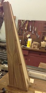

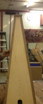

I'm building my first musical instrument, a walnut floor harp.  I've been dragging my feet because I'm tired of sanding it by hand.  A few weeks ago, at Connect I picked up a Rotex RO 90. Do I dare use it on the walnut harp?  If so, what abrasives and/or pads should I use?  When I look online at the abrasives, I don't even know where to start.  I'd like to buy a big variety pack to have on hand for various projects.  Usually of my projects aren't so delicate, most are furniture or cabinets.  Any suggestions?  I'll attach a few pictures of the harp.

Explain why you're sanding it. Lining up joints/finish prep? What finish also.
You can sand it with the RO 90.
The flat areas use the hard pad, shaped areas hard pad with interface pads. I've stack up to 4 pads.
The delta pad will allow access to tight areas
Being walnut I would not use grit lower than 150.
I'm a gear drive mode only guy, finish up with the orbit mode.
Make sure you dust the piece off when you change to a finer grit.
Get 150, 180, 220, 240, 320 grit paper.

Thanks Tom and congrats on the new grand-babies!  There are a few areas that need rounded, a bit of lining up here and there, a few spots of glue, and overall prep.  Tung oil to finish it off.

The RO 90 will work well. The areas that need to be rounded is where you should use the interface pads.
Once you go over the piece with the 90, spend some time hand sanding it with the grain.

Wow! Great looking harp! The 90 is a great tool. I have found Granat to be the best all around sandpaper from 40 grit to 400. Love the bed project.

I am with them on this you can sand with the RO 90 and definitely use a interact pad.
I (depending on project) go over it hand sanding as well.
I recommend picking up a few of the foam backed sanding pads to do final/ hand sanding. They come in various grits. Id use the 400 or finer if it was me.
