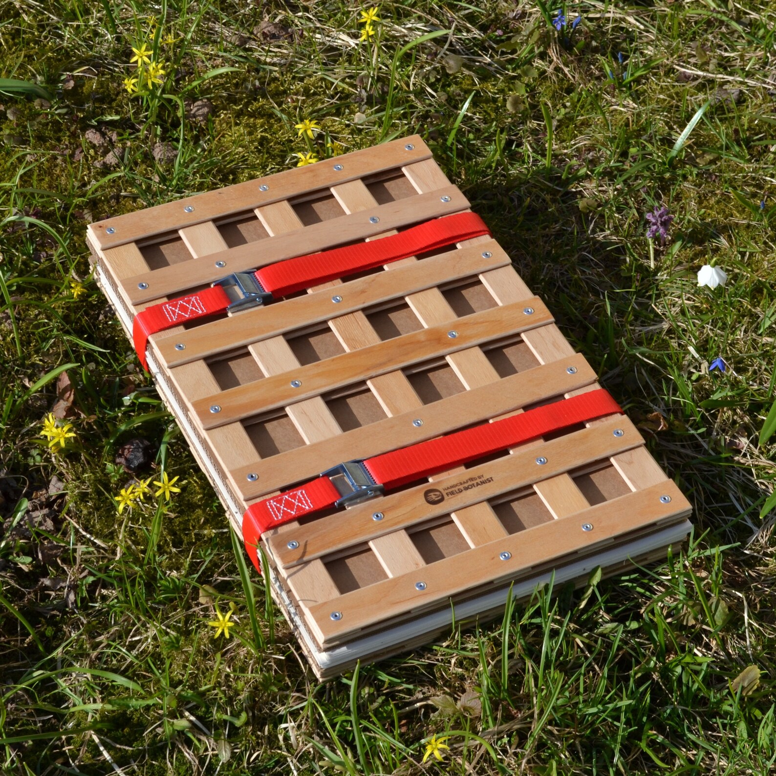

I was looking online.  Most of the “professional” presses use straps (not the ratcheting type) so I am thinking that not much pressure is required).
I am also noticing that they use a lattice of wood strips instead of a platen of plywood.  I would guess to improve ventilation.
Is this one assembled with pop rivets or with Chicago screws? I can’t tell from the image.

Packard said:
Is the open grid design for ventilation?  It certainly is more work than a sheet of plywood.
Yes. But you could drill holes in plywood for the same effect. Even make it a decorative feature, such as combination of large, small, irregular holes in some attractive pattern. Scroll saw some flowers in it.
Unless I'm mistaken the two halves are comprised of three rows of decorative lattice, then a solid sheet of ply or MDF, and padded fabric facing towards the inner.
The “core” is many layers of paper, probably blotter paper to absorb the moisture from the flowers.
The paper core is sandwiched between two layers of corrugated cardboard, maybe stiffer than common?
The above easy to replace components are made secure and easy to carry by the riveted wood lattices.

My thought was to take the 3/4” maple ply scrap that I have, and using my dado stack on my radial arm saw, cut a grid leaving squares about 1-1/2” and slots of 3/4”.  Cut to 1/4” depth it would provide good ventilation.  But the groves would have to be painted and the squares are at risk of delaminating.
So drilling a grid makes the most sense.  I won’t have to paint the interior of the holes.  A big time savings.
