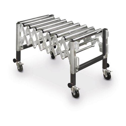

When I pick up plywood sheets, I immediately part them out to more manageable size pieces.  It is the reason I got the track saw.
I back my van onto my driveway.  I open the tailgate.  I set up two roller stands that are just slightly taller than my saw horse cutting area.
I lift one end of the sheet onto the roller stands and then roll the sheet onto the saw horses.
I once leap frogged a heavy board into the house by using the same roller stand onto a saw horse, then moving the roller stand to the other end and repeating.
It is much slower than having a helper, but entirely manageable.
This process would be greatly enhanced if my roller stands were more stable.  If you go this route, try to find roller stands with wide bases.
Or, if it will get a lot of use and the cost could be justified, a scissor roller stand with wheels.
