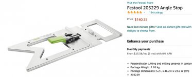

If 90° cuts are concerned, how about this one instead?
Yeah, that is the TSO GRS-16 PE but license-built by Festool. In Europe the Festool branded version is a lot cheaper.
And it's gold btw. It nicely fits on it's side in T-Loc Systainer, but not in a classic Systainer  [sad]
