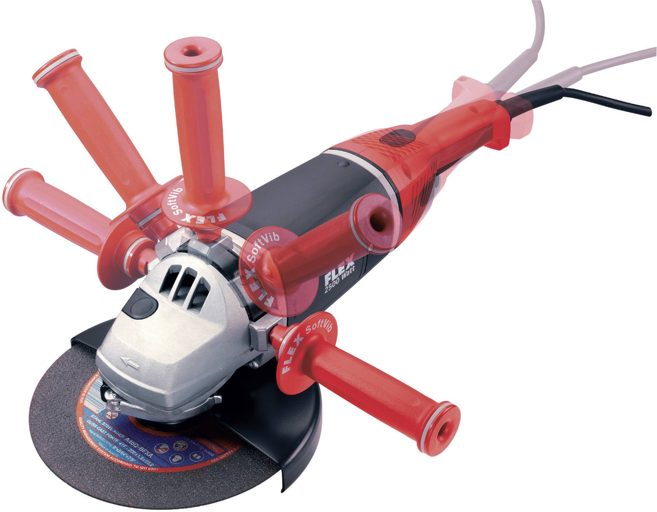

I'm also in the process of acquiring a 230 mm angle grinder.
I found only one type that has a rotatable additional grip so that you don't need to totally unscrew the grip when on the wrong size.
The additional grip rotates around a steel band. I think it can even be done when using the machine.
The hand grip is also rotatable but that's a feature all the other big grinders also have.
It's model L3206 CD from Flex. A very reputable manufacturer which claims that they are the inventor of the angle grinders.
Does anybody have any experience with the Flex model?

[... ] Flex. A very reputable manufacturer which claims that they are the inventor of the angle grinders.
In Germany, "Flex" is a generic name for any angle grinder, no matter who the manufacturer is. This might not say anything about their quality, but about reputation and perception.
