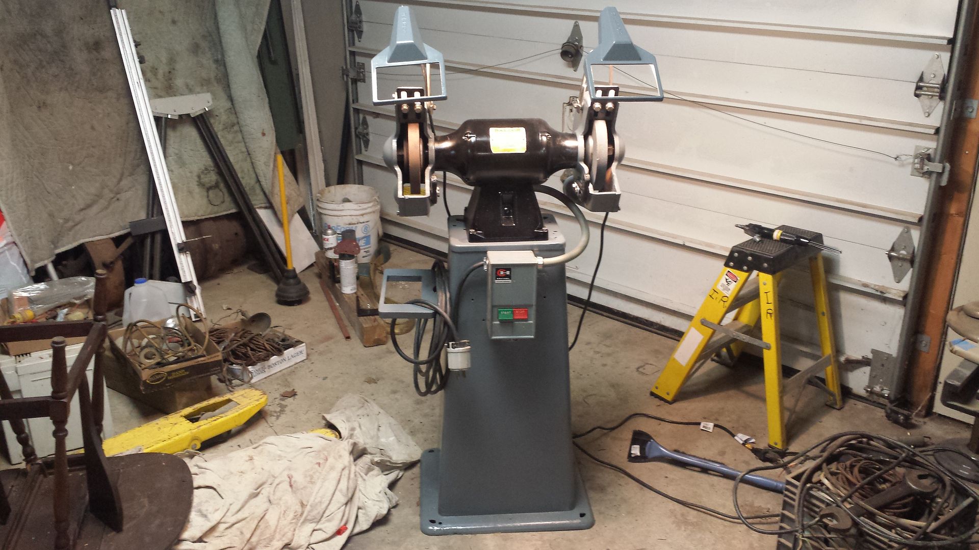

I needed a grinder in the worst kind of way. I knew I should get one for a long time, I just kept putting it off. I couldn't put it off any longer, I had to have one right away.
I scanned CL for a day, went through ebay, checked a few other places I know of. I even contemplated getting one from HF or the likes.
In the end, I just couldn't buy a cheap asian grinder.
I stopped in one of my favorite industrial surplus warehouses and what do I find?
http://equipmentresale.com/product.html?id=89669
I did not pay asking price, got a nice deal on a really dirty machine.
It's actually 1 1/2hp 10" Baldor grinder/buffer.  That is not a Baldor pedestal though.  It came with both lighted shields as well.

I try to clean the best I can first.  I use a product called Totally Awesome, found at dollar general for one dollar in a concentrate.
It will clean some serious grime up.
To clean this up, I went at it with my needle scaler.  They need a good compressor behind them if you expect to get anything done.
My two stage Wayne ran for almost two hours straight holding right at 100 psi.
I did a final clean with a knotted wire wheel on an angle grinder.
I just spray bombed this with 12 bucks worth of Ace brand spray paint (the fast drying enamel).
I clean bolts with a small pedestal buffer with two different wire wheels on it.
I just toss all the nuts, bolts and small parts in an old coffee can, no labeling anything.
I had to change the starter out with one for 240v, change the wiring connection on the grinder, run some new wires as well.
I still need to put the new lexan in the shields, install tool rests and weld up a quick mobile base tomorrow.
Then I can sharpen my lathe tools. [big grin]

Welded up a mobile base for this today.  Think I had 25 bucks in it, including steel casters and steel.
Rolls nice, runs nice, it would sharpen nice if the operator knew what he was doing.  [smile]
