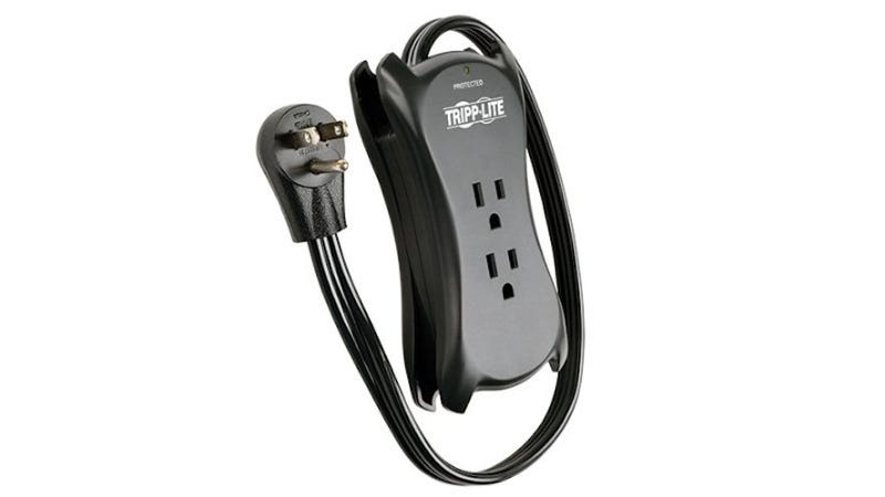

You can also use a simple power strip to connect 2 power cords to your vac.
Then you only have to swap the vac hose or use the Y-adapter (#452898) for that and work with 2 hoses
And normally you will not use both machines at once because of the power specs of the vac.
