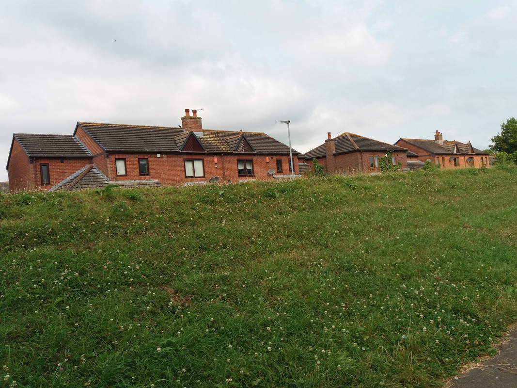

A roof thats fussy just for the sake of it, adding cost, reducing space for solar panels, decreasing possibility if rooflights and loft conversions and adding potential for leaks.
While I'm on the subject I'll mention house design with fussy details for no good reason. A workmate suggested that extra corners must cost an extra five grand per corner when you taks into account,  the founds not being straight, bricklayers being faster on long runs, ading cavity trays and different types of roof truss.
This is an example of a roof that I just cant stand.
