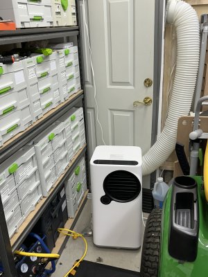

I am temporarily in a smaller two car garage, about 380 ft.² I live in Colorado and the humidity is generally low, below 30%. I have a large oscillating fan that doesn't do much so I just bought a portable AC unit. It's 17,000 BTU so I thought it would be sufficient. I also insulated the builder grade garage door prior to adding the AC. Today was the first run. I started it around 2:30 when the temperature was 88°outside. The garage temperature was 85°. I ran the unit on high for nearly 4 hours and the temperature dropped 3°, barely noticeable. Since I'm living here temporarily, adding a mini split is not an option. Has anyone found a powerful AC unit that actually works?

Does it operate in a dehumidify mode as well as a cooling mode? Might get better results that way.
My guess is that you need to run it for much longer to get the temperature down to what you want. There is a lot of thermal mass you need to overcome. Try running it for 24 hours and see what happens.
Portable ACs aren't real efficient and they're even less so at higher altitudes and since you're in Colorado where the humidity is very low, you'll want an evaporative cooler. DIY one for around $50 plus bagged ice.

Thanks for all the comments. I cannot install a mini split since I am in this space temporally so I ended up buying a window air conditioner. I have it under my garage door and cut two large pieces of foam insulation to fill in the gaps. It was less expensive than the portable unit and keeps the garage much cooler. The other day it was 99 degrees outside and I was able to maintain 75 degrees in the garage for many hours.
